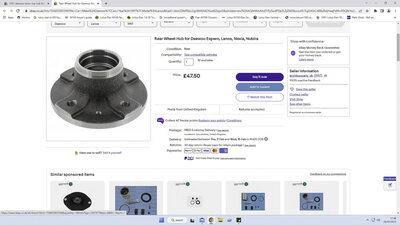

1. There's a ready made rear hub available which MIGHT be suitable, from a Daewoo Lanos. I have one I've been playing with, and so far:
a. The Lotus bearings fit it, and it mounts on the stub axle
b. The Wheel Nuts fit
c. Astra Disks fit onto it
d. The Disk and Hub securing screw holes are slightly different, but a new hole can be drilled and tapped in the hub without problem
I've not checked the offset for centring the brake calipers yet, or if the inner seal fits, but it looks promising, at least.
I hope to get around to those checks in the next week or so.

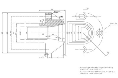

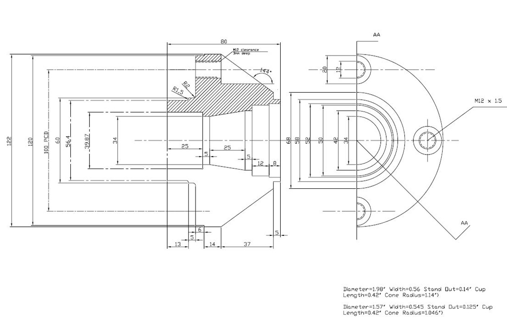

Edit: Many thanks to Dave for sending me the drawing of the old group buy hub.
I've measured the Daewoo hub against the drawing and it looks like this is a go-er.
Surprisingly I found my inner seals in the spares pile quite quickly, and can confirm that they fit, as well as the dust caps.
I now need to put one on the car to check the clearances and whether the calipers will centre correctly on the Astra disks.

A quick look on eBay and this rear hub has GM applications as well as Daewoo. Looks very similar to 'yours', too.
Seems to be mostly Opely/Kadetty applications - and certainly being sold from that part of the world.
Wow, your research seems to be ticking lots of boxes RonR and your trial fit will be fascinating.
(Take a 'high five' for going to the trouble of yet another mission creep :( - but won't it be a real turn-up for the books if both caliper and disk align correctly?)

While the topic is on hubs .. this may be useful. It's pretty old so pre-Jeemy, probably the drawing that Bob Brown's hubs were made to.. Could it be added to the Wiki?

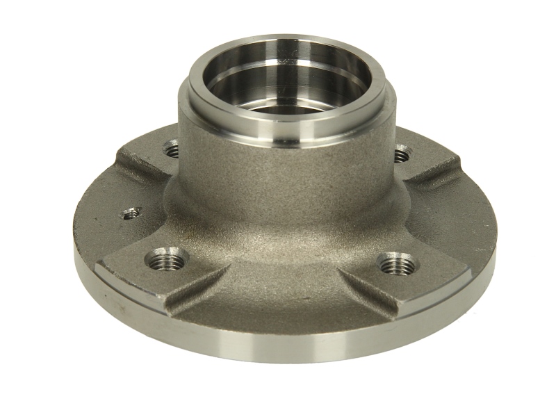

...just a thought RonR...before whipping off caliper hub'ndisk and disturbing your rear brake etc would it be an idea to have dapinky's musuem piece in hand for a visual check and measurement comparison? Perhaps have the luxury of adding a disk and offering them up visually?
These Kadett hubs have some similar dimensions; are they worth considering, too, I wonder?

Phil, it is certainly the BB drawing - 'cos it's the one I sent to Ron :wink:
It was always said that "we" shouldn't be making it available publicly, as someone may wish to take on the manufacture of the hubs........ but now that it appears that the Daewoo/Opel part may be either a direct fit, or at least, a great base for minor work to fit our cars, then I am not going to be too precious over it.

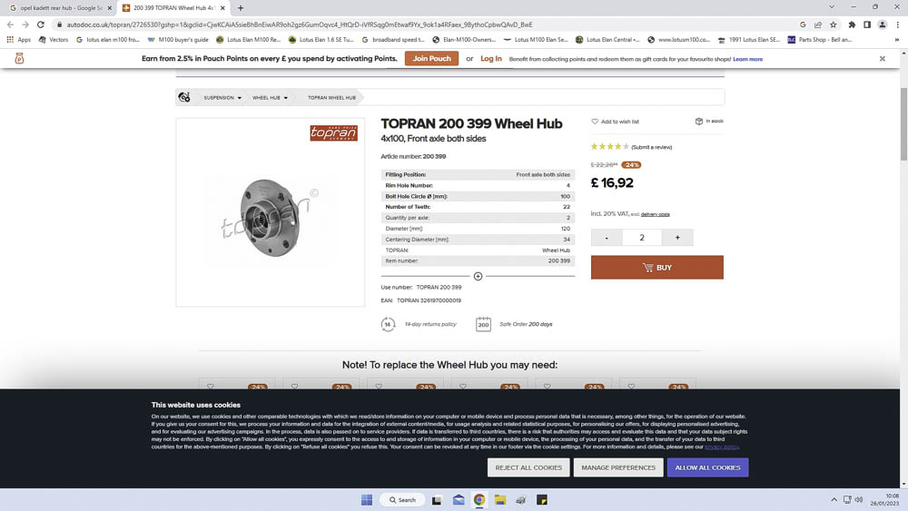

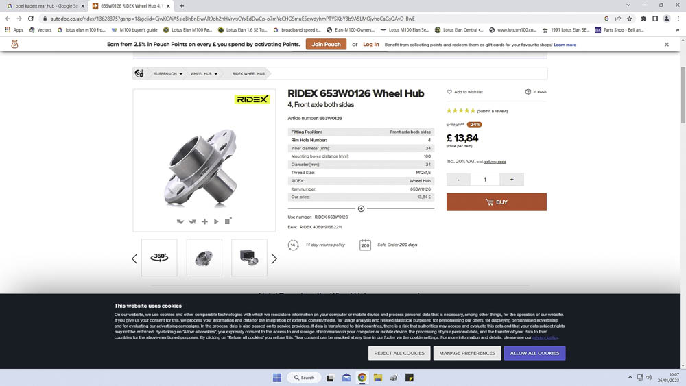

So...I rang up my local motor factor armed with a GM code from eBay that crossed with Daewoo Lanos 1.3/1.5/Opel/Vauxhall etc and (GM OE 90 157724) came up with a FEBI 03106 part which was on a shelf fairly locally - and he's getting it in tomorrow.
I don't really know what to measure but I've got some (front) brake disks on the shelf to offer up to see if they fit - and I can see if it'll take a tapered bearing, measure the thickness etc.
It'll likely be the same as RonR's Daewoo part so if his is found to be an ideal replacement then these'll be available a lot closer to home...
Any thoughts re measurement? (check 34mm and no. of sprocket teeth I s'pose...)

Postby KenS » Thu 26.01.2023, 17:30
Hi Chris, The hubs need to be rears, not the fronts which will have splines for a drive shaft.

Postby chrism » Thu 26.01.2023, 18:23
Ah...embarrassing. Back to the drawing board then.
Thanks KenS. I missed that :-)

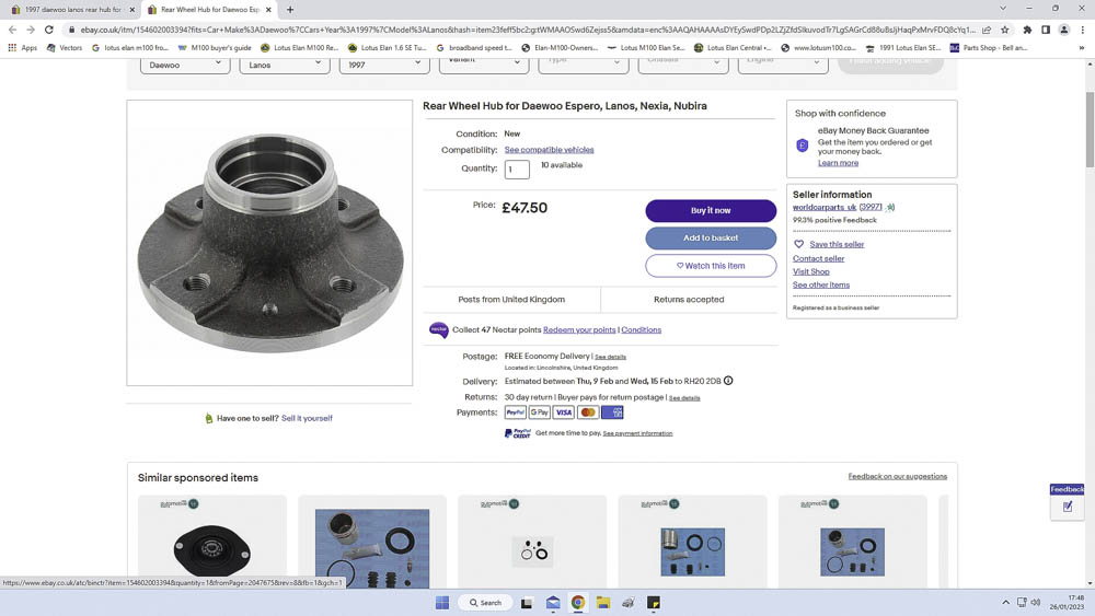

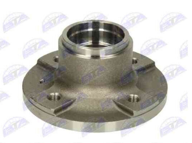

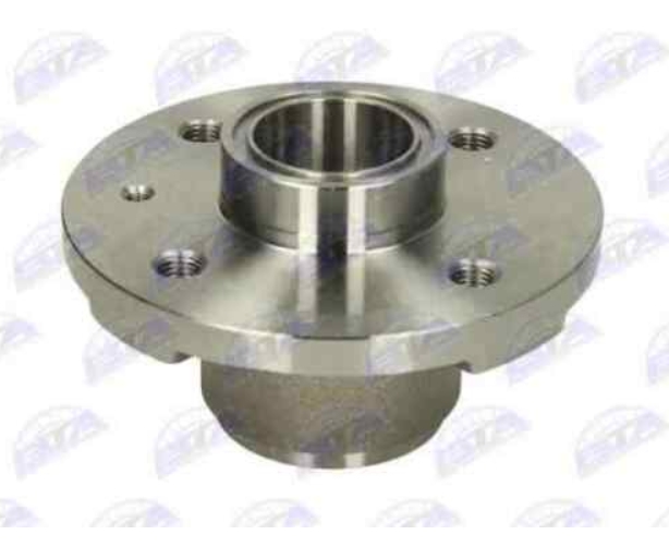

Still trying tho'...I've found a rear hub outlet in this country:-
(And I have a couple of screenshots from German outlets delivering free.)
