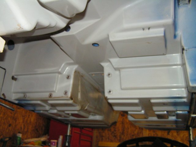

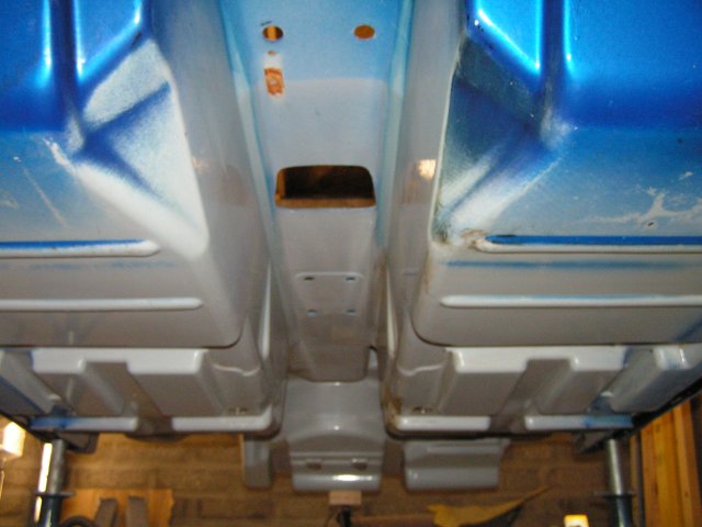

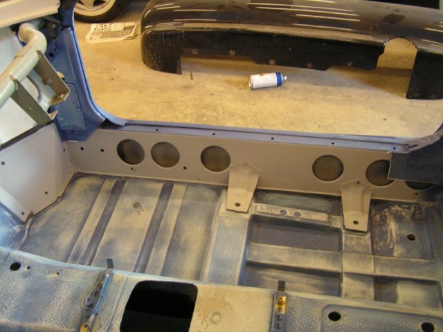

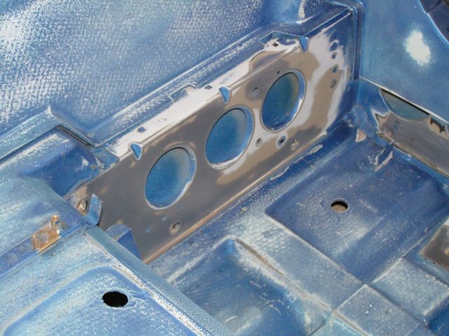

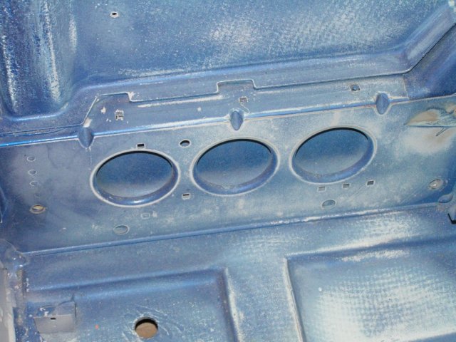

Postby jimbob » Thu 15.03.2007, 19:09
Been rubbing down the shell all week :smt078
Just remembered why I left the motor trade :roll:
Anyway one point I must make about the sill members
RUST :shock:
Have you checked yours :smt103
Noticed on new shell very poor primer adhesion and tiny rust spiders developing under paint.
Also noticed the old shell was developing same but much worse
This part is not interchangable like the Elan +2
May be worth investigating next time your carpets are out !
I stripped mine back to bare metal and coated with 1K primer which I will remove once I come to prime the shell in 2K in the next couple of weeks.

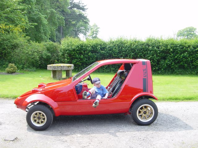

Im no longer in the motor trade now, gave it up ten months ago after nineteen years - panel beater / painter to trade, Just sick of repairing everyone elses car. Motor trade now is in a bad way because of the insurance companies cutting everything to the bone, bodyshops up and down the country are closing down. Insurance companies pay garages very little (e.g. £26 p.h.) and the job times are pathetic, this coupled with high overheads doesn't make for good finances. But now Im starting to regain an interest in cars again.
Enclosed pic of previous project
Previous Labour Of Love
My Bond Bug.jpg (85.82 KiB) Viewed 9819 times

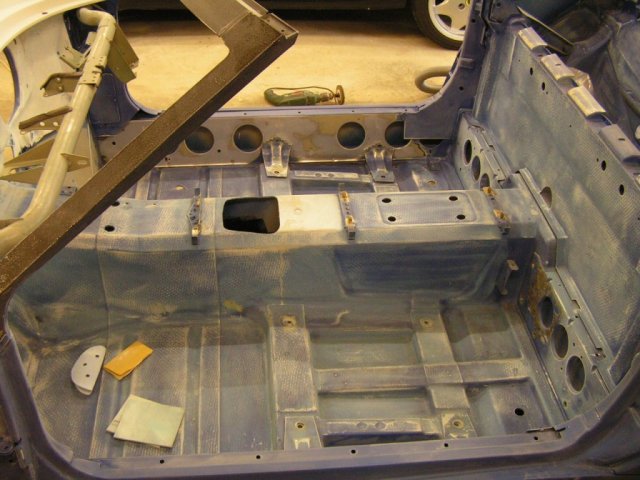

While all you guys were busy at Donington, I had a great time this weekend - lying on my back for a total of 26 hours in the garage washing off the underseal on my new shell with cloths soaked in thinners. I have to say I feel physically sick now with all the fumes. If I never see cellulose thinners again it wouldn't be a bad thing !
All in all I would say I had a crap weekend :cry:

Postby Monty » Sun 18.03.2007, 11:49
Hey Jimbob,
Your doing a grand job mate and the pic`s above of the metal structure in the sills is very interesting and didn`t realise u could get to the just by lifting the carpet. Think i`ll check mine out in the summer. :shock:
ps why didn`t u put the tub on it`s side to save u`r bloody back :roll:
Postby jimbob » Sun 18.03.2007, 12:27
Monty wrote:Hey Jimbob,
Your doing a grand job mate and the pic's above of the metal structure in the sills is very interesting and didn't realise u could get to the just by lifting the carpet. Think i'll check mine out in the summer. :shock:
ps why didn't u put the tub on it's side to save u'r bloody back :roll:
Too much weight in scructure, shell would end up damaging whichever side I laid it on. Damage might not be immediatly apparent then maybe 6 months down the line with a pile of gel cracks to deal with :smt010
