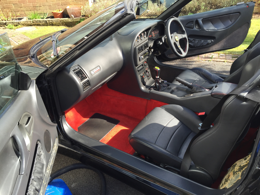

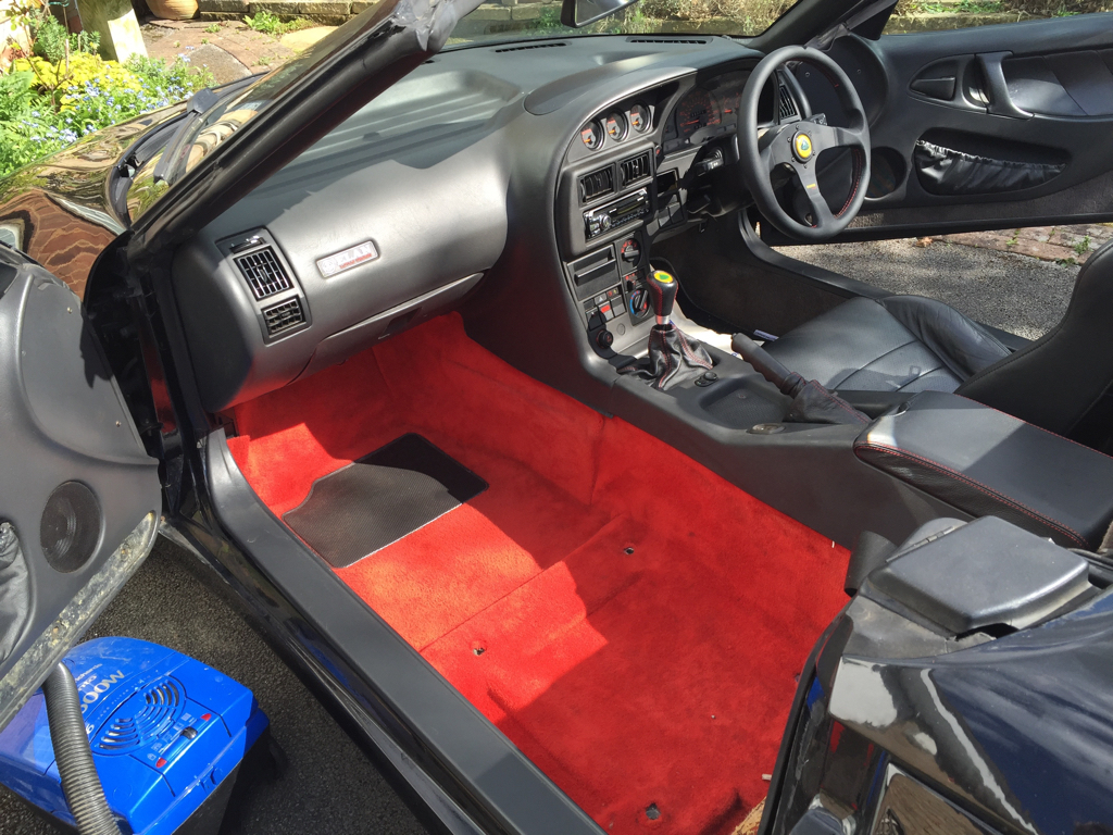

Sun was out today, so time to start on some of the jobs list.
I admit I have been doing a bit of 'head in the sand' regarding the outriggers, but seeing as I was doing the carpet today, I had no choice but to have a look under the soundproofing.
Boy was I mighty relieved! A little bit of surface rust down by the fuses, but apart from that, pretty sound; certainly no perforations in the metal and the seat belt mounting points are rock (well metal) solid; what a relief. A quick once-over with a rust treatment and paint and then on with the actual job - red carpet...
Needless to say, it took a little longer than expected but no major dramas; only managed to get the one side done, but it is progress.

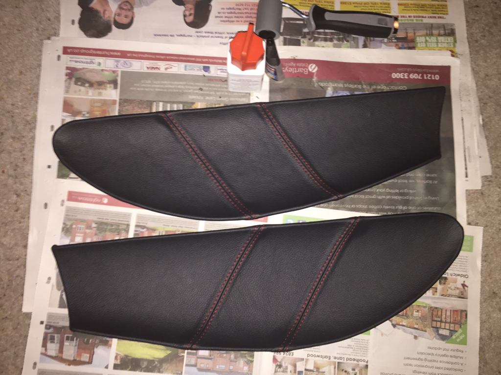

Finally, it rained here today, so some inside work:

Postby SimonR » Mon 25.04.2016, 00:23
Good news on the outriggers !! The door inserts look very good !

Postby maz_r » Wed 27.04.2016, 17:45
i have a question and welcome your thoughts:
Having recovered the door inserts and about to tackle the lower door carpet with something less carpety (not sure that's a word, but, hey), I wonder how people secure those pieces?
I know you can use upholstery adhesive, but I've seen that fail when it gets hot and, knowing my luck, these are the sort of trim that will need to come off and be re-fixed several times over the next few years. Therefore my question is, has anyone come up with a better (by which I mean 'more mechanical') means of attaching these? Something which lefts you remove and replace without reaching for the adhesive spray...
Your thoughts/suggestions welcome :)
