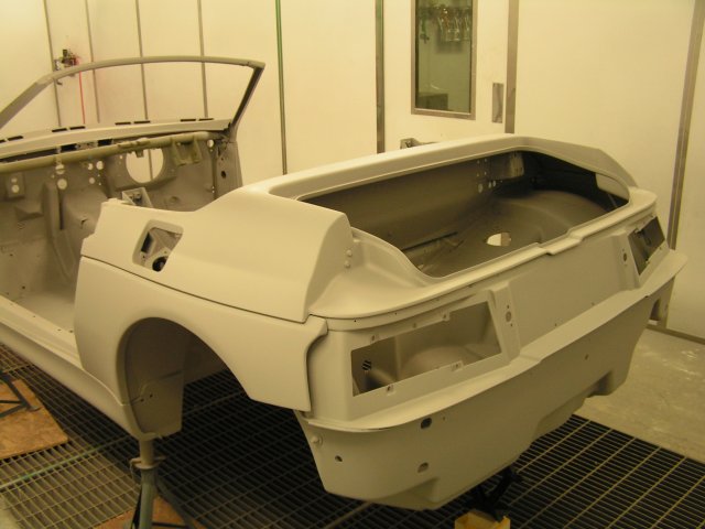

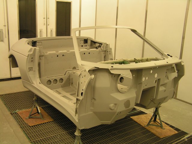

Postby jimbob » Sat 24.03.2007, 00:53

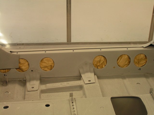

Got the shell into primer tonight, tomorrow and maybe Sunday will be lots of prep and possibly even in colour by the end of the weekend. :smt023

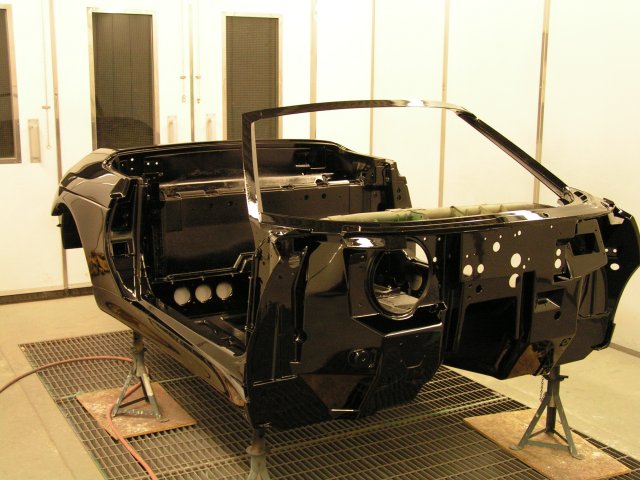

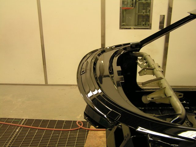

Postby jimbob » Sun 25.03.2007, 23:58

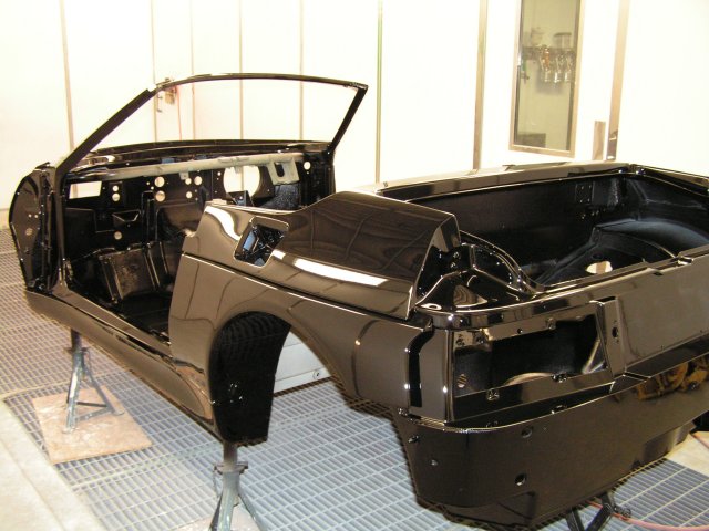

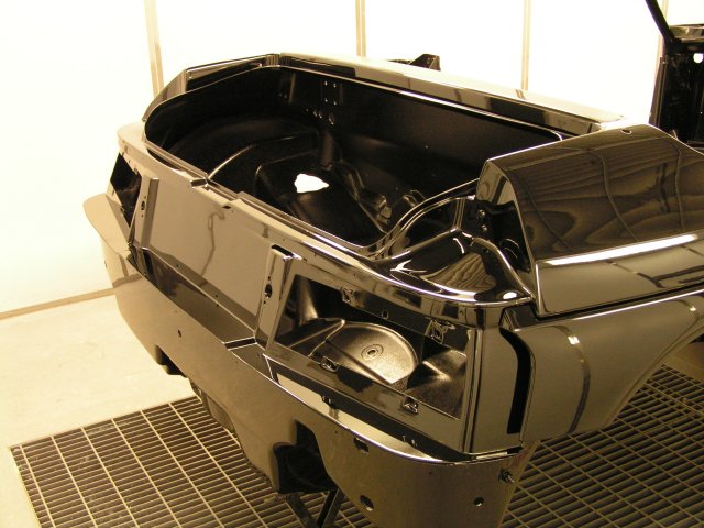

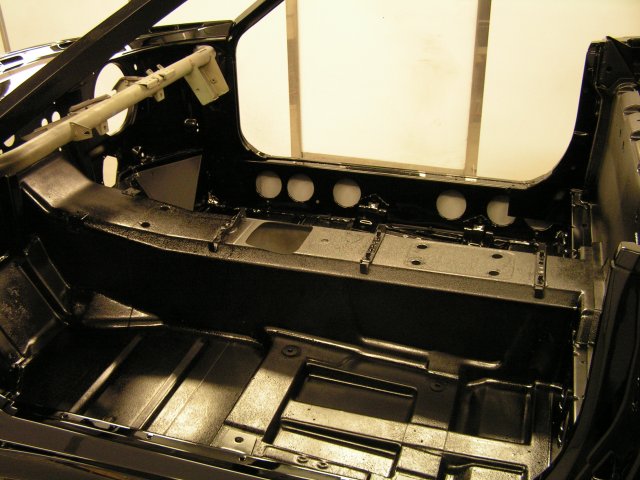

11.30 Sunday night now and seems like the first time Ive sat down since Friday morning, managed to get the shell painted though. My fingers ache after spending the best part of 17 hours rubbing down shell with 800grit wet or dry - wet of course. For anyone thats interested, shell primed with standox 2k high solids primer then painted with 3 coats of standox brilliant black basecoat and finished off with 2 coats of standox 2k crystal clear laquer and then baked at 60 degrees c for 90 mins. Monday will see a few hours spent with the machine polisher not that there's much to do, the finish was pretty good off the gun!
So all I have to do now is : 2 doors
1 bonnet
1 front top shell
1 boot lid
1 spoiler
1 hood stowage lid
2 head lamp pods
2 bumpers
1 fuel flap
Hope Ive got enough colour to see that lot through!
Anyway having painted the shell I can now concentrate on starting the big change over of parts :shock:
The rest will be painted at a later date :smt023
Plug the holes to stop any dirt coming out when painting
Shell took 3 hours to paint
Bling even under the dashboard !

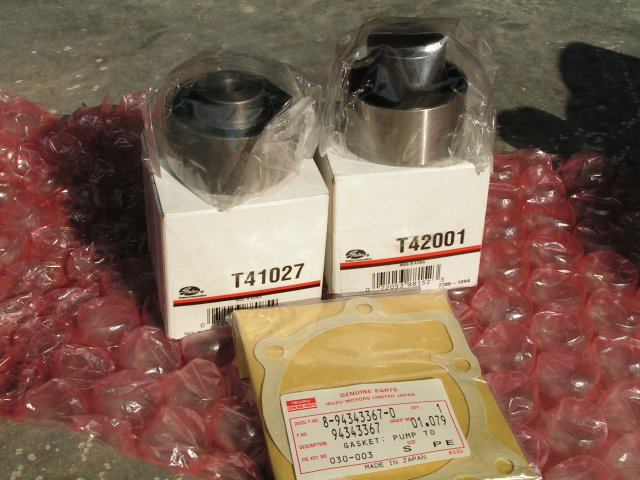

Postby jimbob » Mon 26.03.2007, 15:44

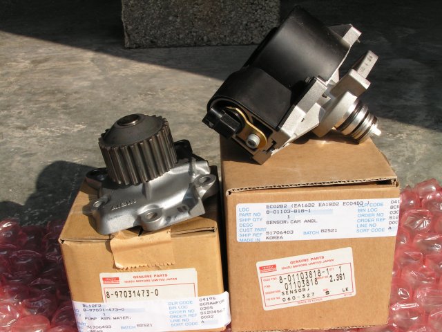

A bit premature but my folks are just back from the states and went well out of their way to get these for me. Am I delighted or what!
:banana:
Genuine C.A.S. Assy £75 approx
Genuine Water pump £65 approx
Tensioner Pulley £40 approx
Idler pulley £42 approx
Gasket came free with pump!

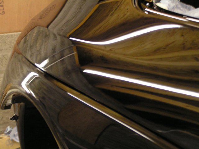

Postby jimbob » Wed 28.03.2007, 17:21

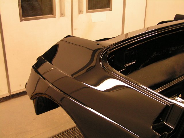

Just spent the last couple of days flatting and polishing new shell.
(1500dry - 3000wet on palm sander then machine polish)
Tryed to take pic to show shine but just unfortunately too much glare, photo just doesnt do justice! Posted anyway :smt080
