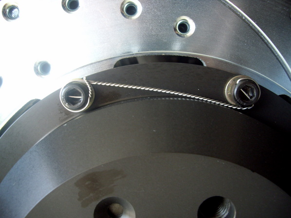

Postby robinlarry » Wed 12.11.2025, 17:56
Safety always first.

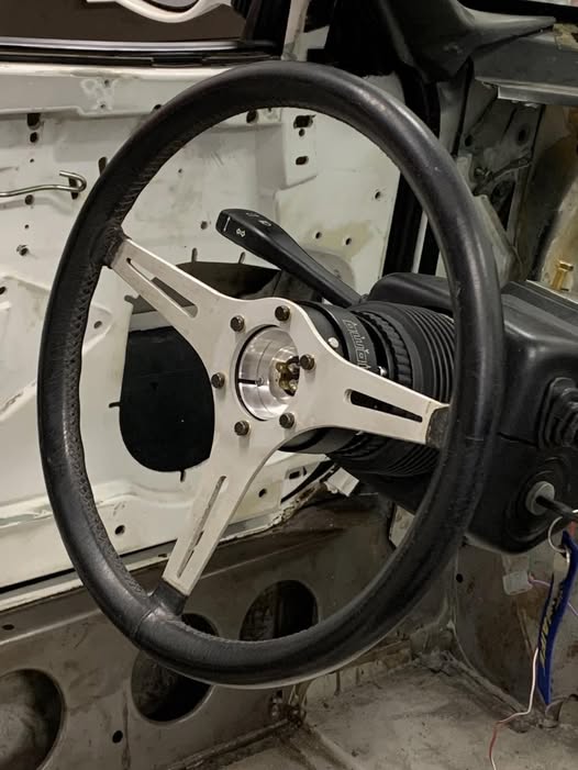

Postby robinlarry » Wed 12.11.2025, 18:16
Quick release 26r style steering wheel
Quick release 26R style steering wheel

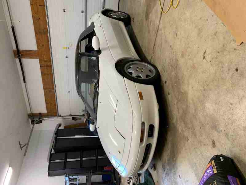

Postby robinlarry » Wed 12.11.2025, 18:44
M100 with hardtop. Hardtop and roll bar allow me to run/instruct with most groups.

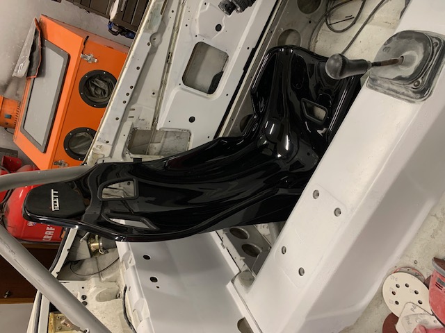

Postby robinlarry » Fri 12.12.2025, 04:00
Tillett seat fits perfectly and mounts using existing holes in floor!

Postby RonR » Fri 12.12.2025, 20:23
Looking good there!
Small World - Steve Tillett's a member of our local Lotus group.
Another member fitted a Tillett seat to his track-day Elise Cup. He's no spring chicken but reckons it was worth 1-2 seconds a lap!

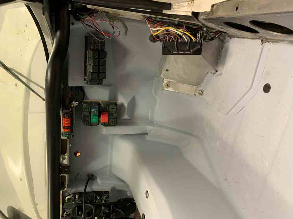

Postby robinlarry » Sat 03.01.2026, 17:11
Relays and fuses moved from left side to right side.
New positions for fuses and relays
