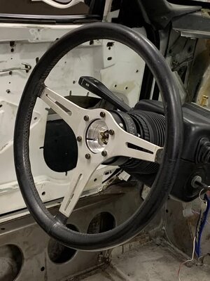

Quick release 26r style steering wheel
Quick release 26R style steering wheel

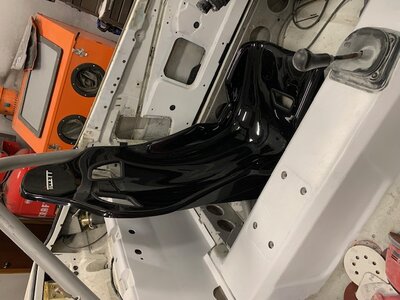

Tillett seat fits perfectly and mounts using existing holes in floor!
