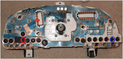

As the previous owner added an ally header tank you can't see the coolant level. So I added a stainless float switch to the tank and ran the lead to the instrument brinicle. so I now have an added waning light, it was the most suitable as I could not see a low coolant image.
While I had the cover off the brinicle I also added the missing wires for the O2 sensor and put the S2 ECU in and O2 sensor.

It is easy once I worked it out. I used this float switch from a well known auction site.
Mini Indicator Vertical Water Level Sensor Stainless Steel Float Switch SG
Then earth one wire the other wire goes to the instrument binnacle.
Run the wire to contact circles red, I folded the wire and shaped it so that it made contact.
I removed the bulb from a spare position marked with the blue circle ( as I didn't have any of the correct type in may spares box) and placed it in the position marked with the red circle.
Having test driven it I can confirm it works as I am still loosing water but can't find from where. It maybe the radiator on the drivers side but it never shows when I am looking at it.
