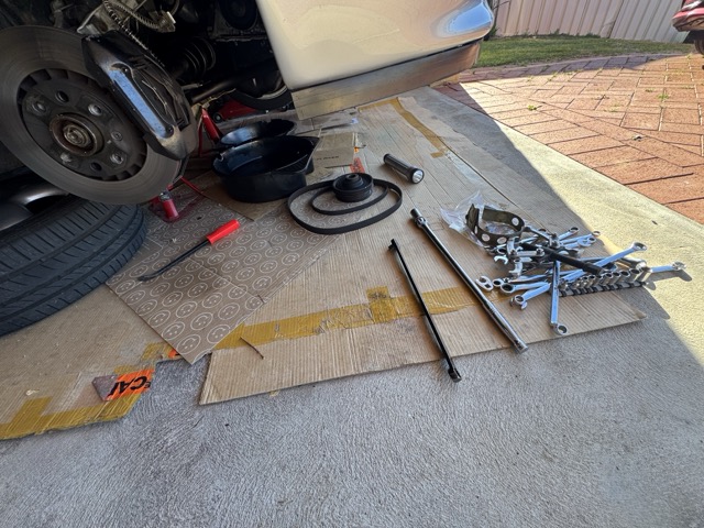

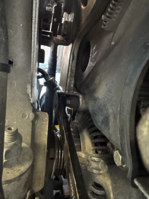

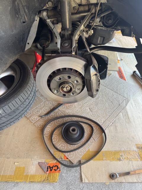

I am at least three years late to the cam belt service because I just couldn't find the motivation to get started with it... but I have now passed the point of no return. I am very grateful for an Australia car with very little corrosion, it hasn't really been that difficult so far with everything coming loose easily enough. The alternator was a pig, but with the PAS bracket removed I could turn it 0.5 degrees at a time.
I got this far and stopped for the first session.

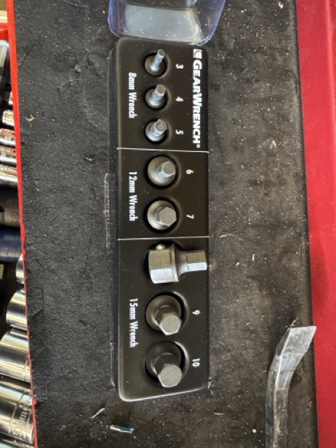

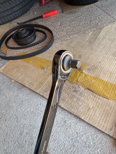

These made removing the engine mount bracket very easy. I picked them up locally after a tip off from another Aussie owner.

An impressive array of spanners etc. were needed to get to this point!

Good work...... but you've just cost me a few quid, as I've never seen those sort of Allen keys with a hex head drive.......... not needed very often, but will be invaluable when they are required.

Postby 378S2 » Sun 16.08.2026, 00:58
Hi Dave,
Lucky enough they’re not very expensive though, I paid about $30 from a local tool shop, they’re also on Amazon:

Postby Tuga2112 » Mon 17.08.2026, 14:57
ive done the job a few times with the offcut of the elan wrench on the 8mm spanner now and find that appraoch adequate. however the amount of torque being applied to a 8mm spanner seems likely to cause premature wear.

Postby RonR » Mon 17.08.2026, 15:35
I managed to undo the PAS reservoir strap / mounting bolts then carefully move it to one side just enough to get a hand past - dropped the spanner several times, but got there in the end.
