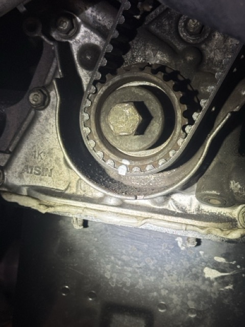

I am at least three years late to the cam belt service because I just couldn't find the motivation to get started with it... but I have now passed the point of no return. I am very grateful for an Australia car with very little corrosion, it hasn't really been that difficult so far with everything coming loose easily enough. The alternator was a pig, but with the PAS bracket removed I could turn it 0.5 degrees at a time.
I got this far and stopped for the first session.

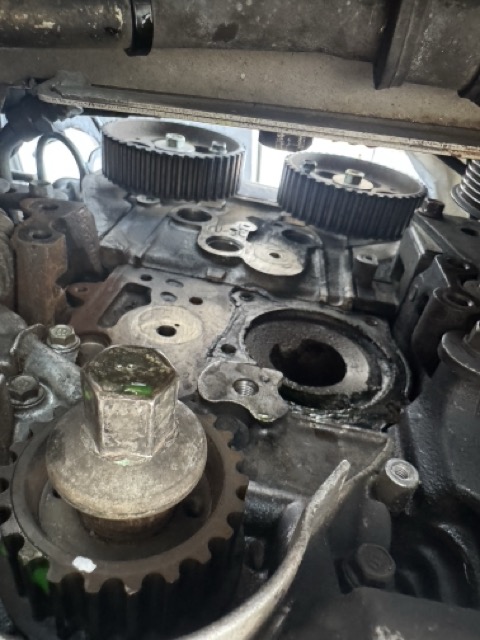

Back in to it today - honestly not that difficult to get this far although I have big respect for how cleverly Lotus made each part slightly too big to remove, and that cam cover bolt they hid behind the engine mount was really special.

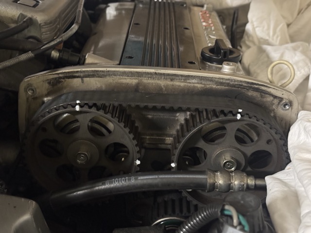

The old belt is very loose but otherwise looks fine. I have a sense of dread that getting the covers back on will be impossible. I ordered three new Gates belts (4PK685, 6PK1055/K060415, 77159 X 1 T169) when I figured out the ones in my spares pile were 2002 parts. I plan to remove the pump, idler etc and have a good look. I do have spares for all in the box.
Getting this cover off explained some chips in the tub which I had wondered about but didn't know how they could have been created. Removing the engine mount is absurd.
I'll transfer these marks to the new belt so that I know I have not messed it up.

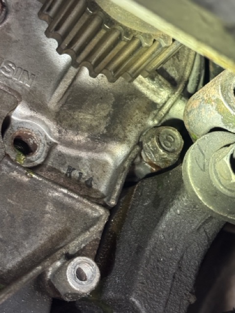

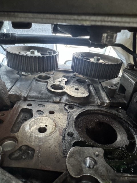

This was easier than I thought - only one bolt that gave me some difficulty that was blocked by the AC pump.
