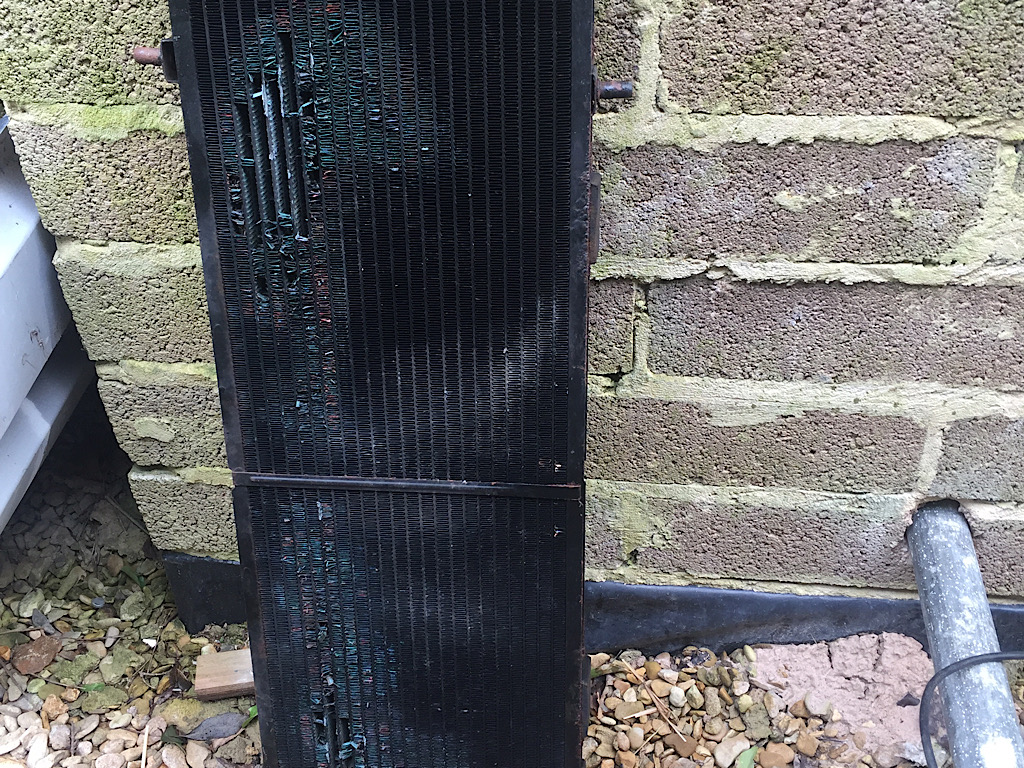

Rather than hijacking Justin's thread even further, I thought I’d better start up a new thread with the Green Monster’s 2020 spring project. It started with a small radiator leak:
Thank goodness for CoolExperts

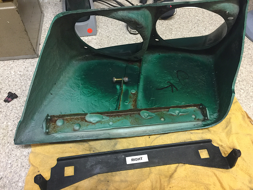

To make access easier, I decided to take out the headlamp pods ( had intended to replace the lamps at a later date anyway). And I’m really glad I did; all the rose joints and hinges are really tight, and the Lucas lamps are badly corroded (the Cibies are fine, but with milky lenses). This afternoon I’ve got the lamps out of the pods, but I now need to split the lamp bowls from the mounting brackets, and of course the screws are solidly rusted in. I can’t use heat because of the plastic rings, so I’ve applied copious quantities of PlusGas and I’m waiting and hoping . . .
Meanwhile, it’s off to Steve at SJ for the replacement lamps and brackets (I already have a set of stainless steel fixings, which should make reassembly much easier).

Good progress yesterday and today:

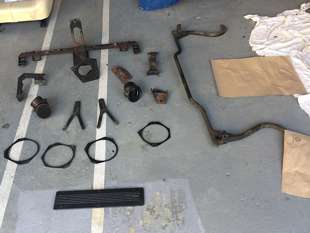

Now where did I put those rusty headlamps?
Off for blasting and powder coating

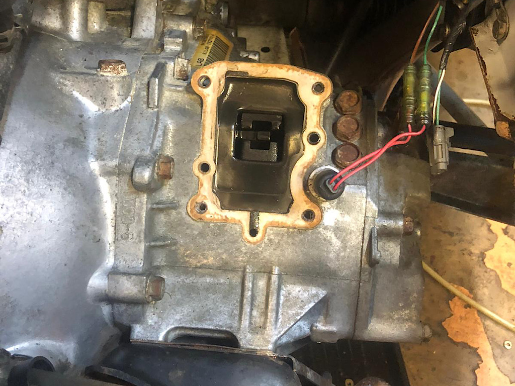

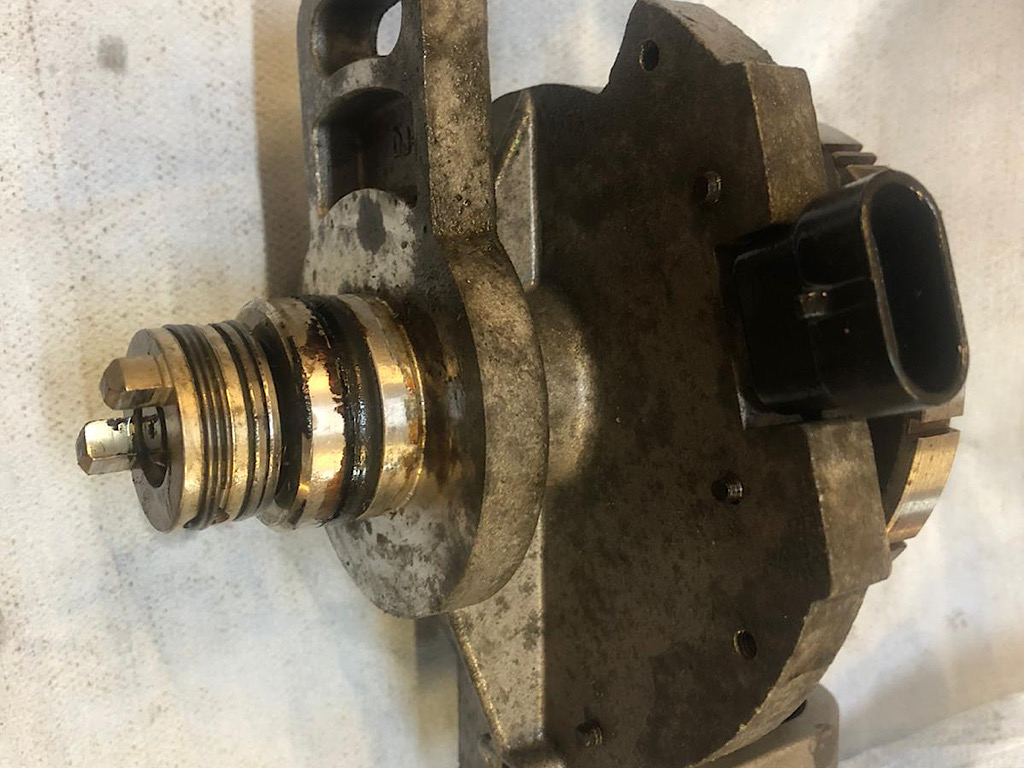

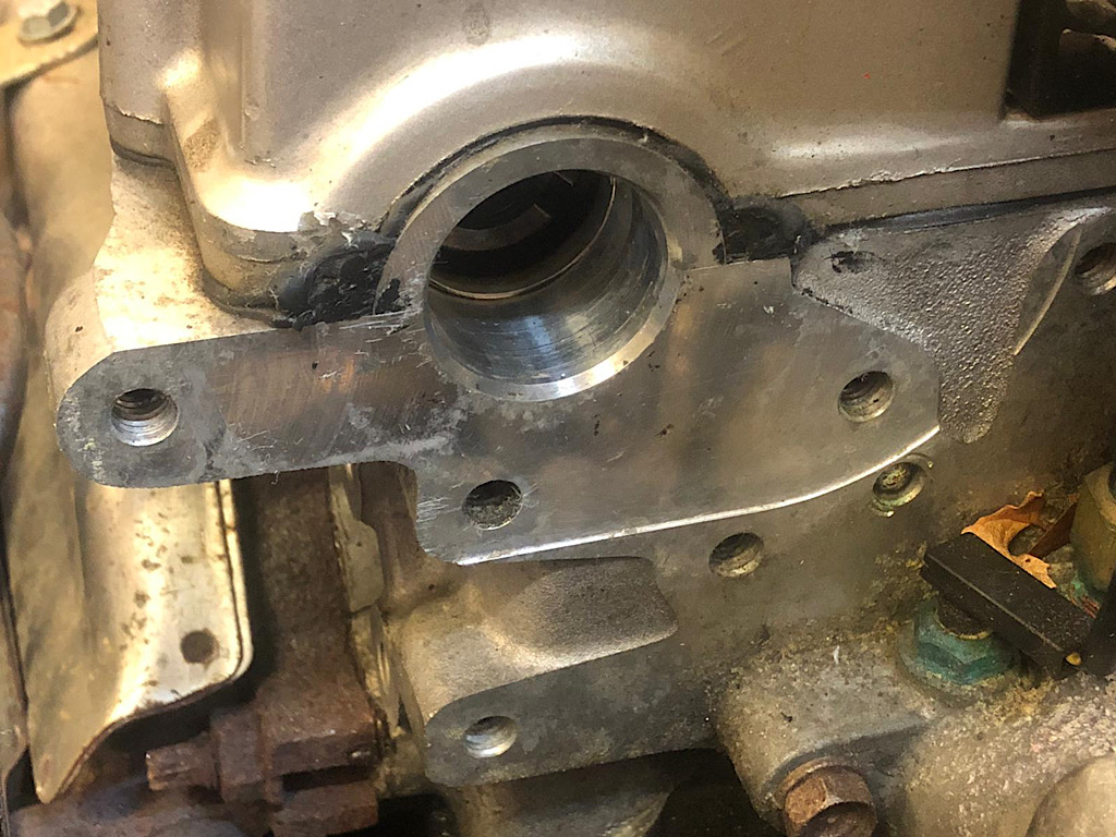

CAS stripdown in progress
Good job I bought one of Simon_P’s CAS O-rings

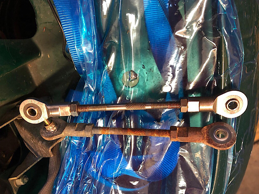

Gear change cables removed ready for BCN’s new cables and short shift kit

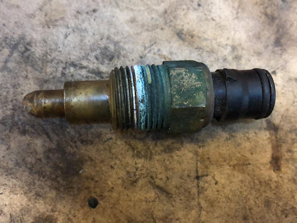

BTW, I’m the buyer of your temp sensor on eBay; old one looks as though it’s come off a 25 year old tramp steamer :cry:

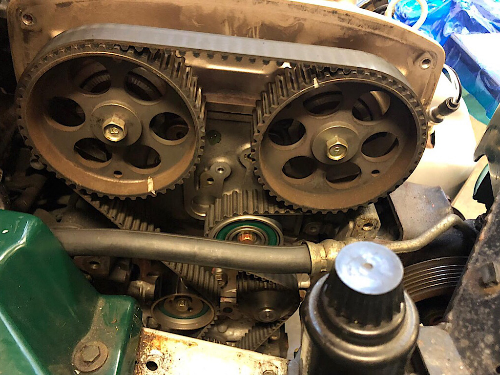

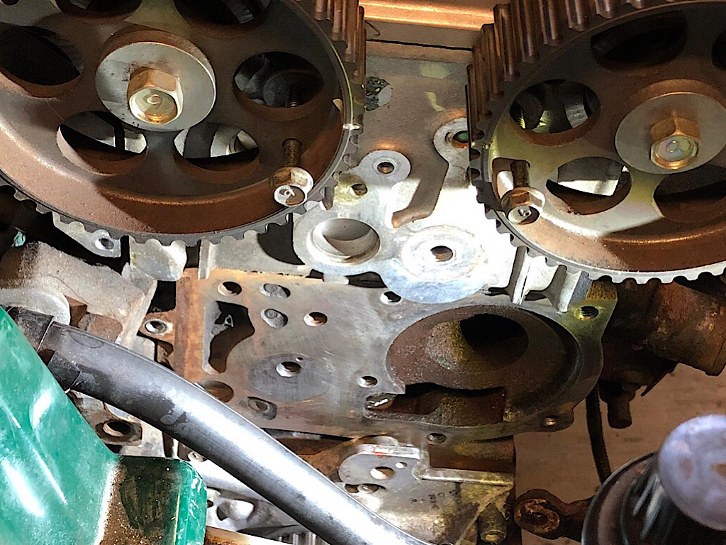

    - Cam belt change progressing well:
    Cam belt cover off and all ready to dive in
    Belt off and everything cleaned up ready for new

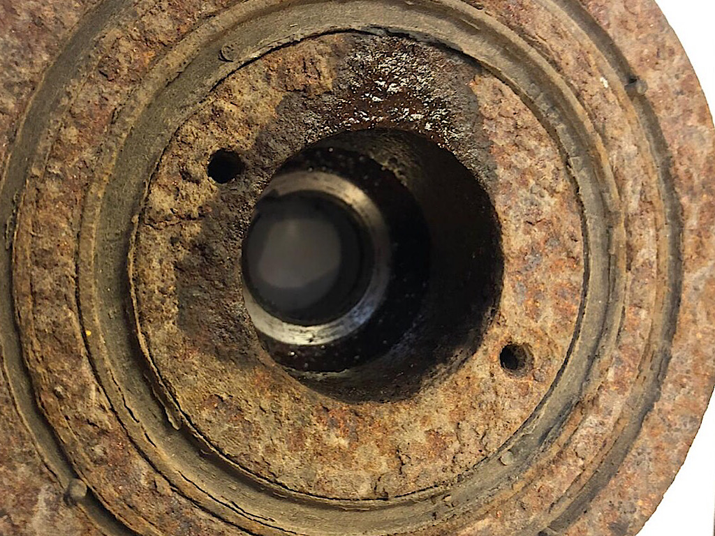

    However, the crankshaft pulley was delaminating:
    Crankshaft pulley not in great shape
    Decided to bite the bullet and replace it with a new one; too important to risk it. £180 - ouch!

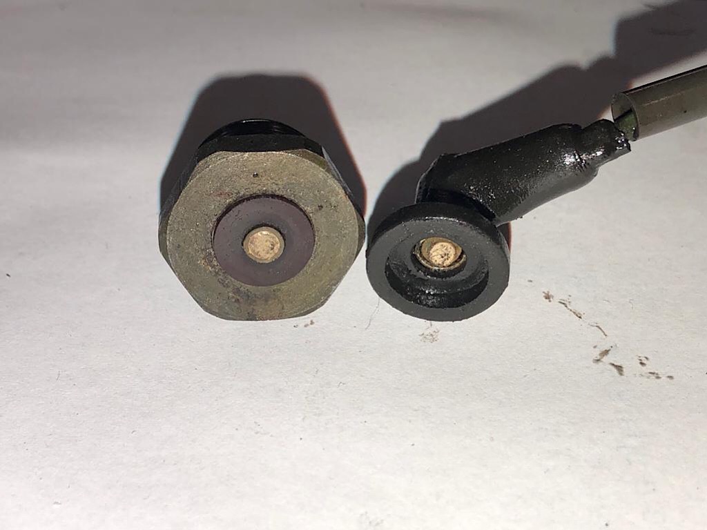

This morning, I've managed to break the small stud on the electrical connector for the power steering pump :oops: Has anyone had this happen and knows how to fix it, or might anyone have a spare lurking around their garage please?
Oops!
Re: It’s only a small leak, honest
Postby Simon_P » Wed 18.03.2020, 13:22
Ooops indeed!
when you took that out was there a spring and a plunger behind it?
Postby Saltire » Wed 18.03.2020, 13:48
Sure was!
Postby Brit-Car-Nut » Wed 18.03.2020, 13:52
The P/S switch is used to tell the ECM to increase RPMs when steering pressure is high - like turning when the car is idling.
It is part # 97036962 (item #22)
I will dig through the pile spare engines and parts to see if I can find a pump with a switch intact.
