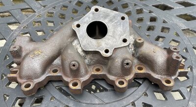

Discovered 2 cracks in the exhaust manifold when cleaning it up:
Has anyone had a manifold repaired successfully or should I look for a second-hand one?

As far as the oil lines go - they are easily repaired using any hydraulic hose place....
..... as for the manifold, there are many schools of thought ranging from "replace with a new one" through various repairs, to "leave it alone" - all methods have their advantages and disadvantages.
In an ideal world, a new item will be available from a local supplier, for £10, and can be fitted easily - unfortunately not the case - it is quite likely that any used item will be in a similar state, or even worse (the rear face of the collection pipe portion always seems to get the worst wear, and can't be seen when it is fitted).
On my first Elan I simply cleaned it up as best I could, then smeared some chemical metal over the area, getting into the cracks as much as possible - it never leaked (to the best of my knowledge) and the colour meant it wasn't visible (even without the heat shields).
Then I had the manifold from my spare engine welded - now, cast iron isn't easy to weld at home as it requires the work piece to be heated up uniformly, then welded, then cooled slowly - so needing an oven which goes hotter than the one in my kitchen, and cools down over a long period.
I'm unsure how easy it is to find somewhere that can do it properly, but I'm sure that many places will offer to MIG weld the crack, but offer no guarantee on it. I was fortunate in that a father of a friend was an instructor in the apprentice school at Jaguar, and they had the facilities to do the work for me.
To be honest, it doesn't look as neat as the chemical metal repair, but it is still going strong 15 years later.
I would suspect that a high percentage of the cars on the road have these cracks, but most people are unaware of it because they can't be seen easily - so, leaving it alone won't make much difference!
If it were me, I'd clean and fill it, but not worry too much - I've never known one to actually break and/or leak fumes in a meaningful way.

Thanks for the info Dave, a local engineering shop are going to have a go at TIG welding the manifold with Nickel or Stainless steel filler, fingers crossed....
and I'll take a trip to my local Pirtek to see if they can do the repair to the oil hose.

when i saw the pictures i instantly thought a bead of mig weld would be enough.
why is such solution is not a viable option ?
Posts: 3039
Re: Step by Silky Step
Postby dapinky » Tue 09.05.2023, 17:35
Tuga2112 wrote:when i saw the pictures i instantly thought a bead of mig weld would be enough.
Well, it sort-of is the way to do it..... the problem is that you are welding cast iron, and for any weld to work well you need to 'melt' the filler material into the host metal.
The problem being that cast iron and mild steel expand at vastly different rates, and thus shrink at vastly different rates after you run the weld. To successfully weld a thick lump of cast iron you need to bake it to get it hot - and more importantly, keep it's heat even (otherwise some bits will expand/shrink differently than others). Having got it hot enough (hotter than your oven at home can go!) it can then be MIG welded..... with a hot gas flame running on the work at the same time.... then the whole lot stays in the oven and the temperature is slowly brought back down to ambient.
This is why it isn't easy to do at home - and the 'best' form of welding is probably oxy-acetylene with a suitable filler rod.
Simply running a bead of MIG along a crack in cast iron can cause the crack to grow very quickly if the temperatures aren't close...... but it CAN work with skill/luck - wouldn't like to say how long it will last though.

what if its welded in small increments letting the metal cooldown between parts ?
i mean. put mig steel on both sides first, and then fill the middle. ?
Posts: 3039
Postby dapinky » Tue 09.05.2023, 20:55
As stated, the metal needs to melt to fuse into a solid weld - the temperature differential between the manifold and the MIG wire means that the weld won't stick unless the cast iron is hot enough to melt/fuse/sinter - and that is where the thermal shock comes in....
.... it may look like it's worked, but the crack may well have grown (not necessarily visible) and the weld may or may not last.
If you use a grinder to cut the crack open into more of a slit, then MIG weld it, it will shatter the cast iron as the steel will expand and contract at a completely different rate and the finish size (cold) will be significantly different to the starting size (hot)....
.... however, cutting it into a slit, then using a gas torch and suitable filler rod to effect a brazed repair is perfectly feasible - it is just that you need to KNOW what the expansion/contraction of the base metal and filler will be - it is a skill that I don't have.

Exhaust manifold welded up:

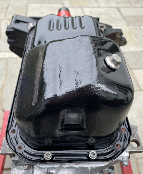

Sump bashed to something like it's original shape:

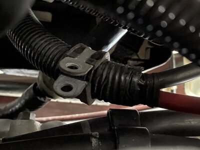

Before putting the drive shafts back in I have a loom p-clip behind the engine which doesn't seem to have an attachment point, it's above the oil filter and about the same height as the petrol pipes:
Anyone know where this attaches?

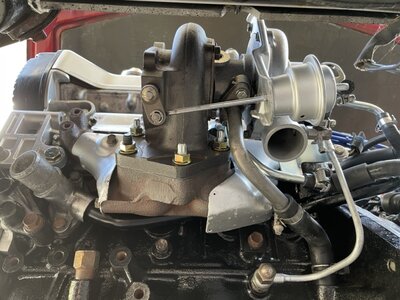

New Turbo cartridge in and connected up:

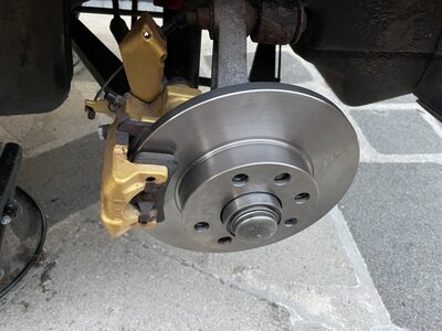

Rear Daewoo hubs were turned down to suit 236mm x 41mm x 12.6mm Vauxhall/Opel/Bedford front disks as replacements for the one-piece rears:
