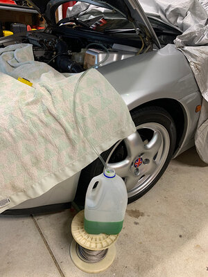

And, I forgot to ask how do you start the siphon for your patented coolant slurper upper?

Coolant slurper upper... The fiddly part is getting the hose all the way down to the bottom of the radiator. I had a large syringe that I used for making a vacuum brake bleeder lying around so I used that.

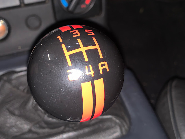

Back to the major repairs:
A new gear knob. This is actually from a Mustang, I was looking for one without the red go faster stripes but with the gear pattern. This will have to keep me happy for now.

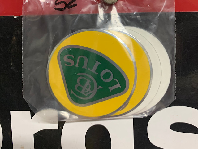

Some replacements for the union flag wheel centres, they were definitely a mistake!

Mustang?! Are you trying to make an assemblage of all the great historical convertibles in one go? I thought if you were going for the ball knob, you'd have gone with like an esprit S2(?) wood one

Postby 378S2 » Fri 27.08.2021, 00:54
Yea... I am not sure they fit the look of the car. I am not sure my Mustang one does either, but in my defence I was being forced to watch something terrible on Netflix one night (some sort of cooking themed 'celebrity' singing on ice death match) and eBay made me do it.

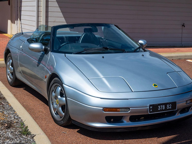

Postby 378S2 » Sun 19.09.2021, 11:47
I had a very enjoyable and pretty long (400km) run out with the Lotus Club today. I’m quite a bit slower than the pack, but it’s my driving rather than the car!
My boost now hits the 0.65bar max, but it is odd because I can only get it there when I am accelerating between 100kmh and 120kmh in 5th gear. That’s ~2800rpm to ~4000rpm. I can't get it to work in any other gear and it doesn’t work in 5th every time. It routinely gets to 0.5bar in all gears no problems. So it is a bit odd...
Is it normal to be speed dependent or do I have a loose wire to find? Any likely culprits? Sadly no Elan scan to offer as I am a Mac user and haven’t got around to borrowing a PC yet. My throttle cable is at max adjustment, could it be that it is not quite hitting 100%?
Any tips very welcome.
What I lack in speed I make up for in pop up headlights, which everyone knows are cool.
Side angle - the paps were out in force today.
Nice place for a drive.
It rained a little, but as long as you don't stop you don't get wet.
The car is running beautifully. I did need a push start today, but only because of some dodgy wiring on the immobiliser that I’ll fix when I get a moment.

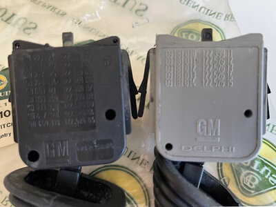

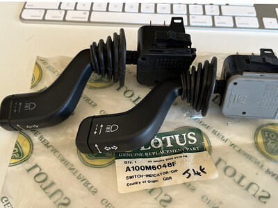

I decided to change the control stalks, not because there’s anything wrong with them but just because they’ve faded over the years. It’s a little frustrating though because the new indicator stalk doesn’t auto-cancel when turning right, it does when you turn left. I’ve tried a couple of different options (one genuine GM and the other a copy) and no dice.
I think the problem is with my aftermarket steering-wheel and boss. I’ll give it a go with the OEM steering-wheel.
Don’t suppose anyone else has had this problem and knows where to find a stalk with a slightly longer tab?
The old one is fine, but I wanted to freshen the paint. I think the problem lies with my Momo steering-wheel’s boss.
The pop out tab on the original black one on the left is 0.45mm longer than the new one on the right.

Postby Rambo » Wed 26.01.2022, 11:36
Have you tried swapping out the tabs?
Postby 378S2 » Wed 26.01.2022, 12:04
Hi Rambo - well I tried to take one of them apart, I was going to swap the new lever on to the old switch but I couldn’t get them apart without forcing it and so I decided to stop
378S2
Posts: 268
Joined: Wed 09.09.2020, 02:19
Location: Australia
Postby dapinky » Wed 26.01.2022, 12:15
It may be a bit of a botch, but may work.... can you extend the tab a bit with a dab of epoxy resin? Maybe drill a 1mm hole down it, add some wire which protrudes a bit, then some 2-part epoxy. Allow to set and fettle to the right shape?
Postby Rambo » Wed 26.01.2022, 13:33
Worth a try anyway
Postby 378S2 » Wed 26.01.2022, 13:35
Nice idea - I have two spares now so I will try it out on the non-GM one. Thanks for the suggestion.

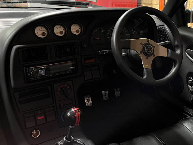

Postby 378S2 » Sun 30.01.2022, 07:25
Right well mystery solved - with the proper steering wheel back on the replacement stalks work just fine. It is the Momo boss that isn’t right.
I promise to do something more interesting soon. I’ve got plans to rebuild the suspension in the winter!
The original wheel feels a bit more ‘relaxed’ - I will drive around with it for a while and get used to it again.
Smaller Momo Tuner steering wheel feels a bit more ‘sporty’ but it doesn’t look like it belongs there.
