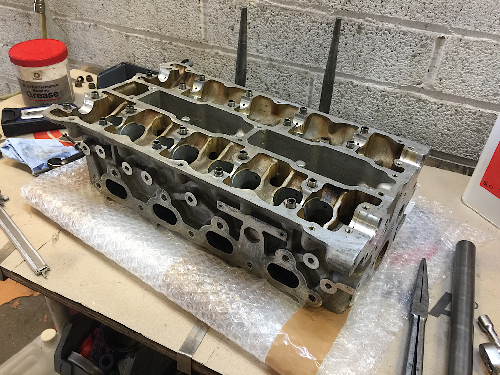

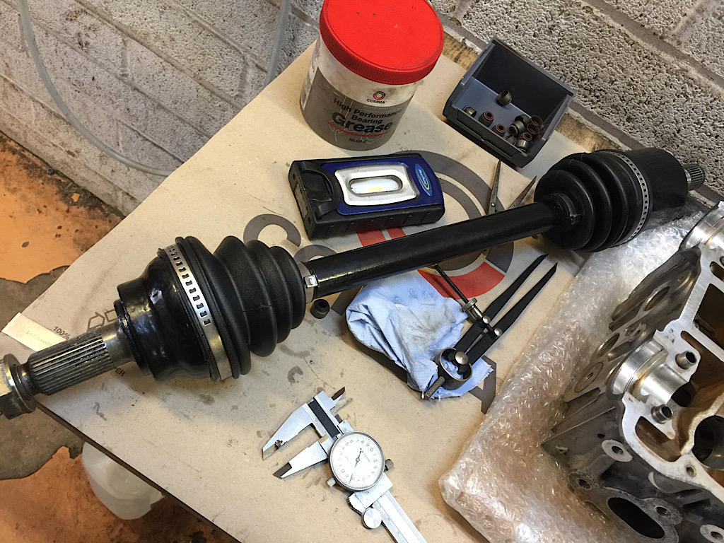

The bad news is that the valve stem oil seals don’t fit. As far as I can tell, they’re about 0.4mm larger in diameter than the existing seals (hard to tell because you tend to damage the existing seals taking them off). So the new ones are sloppy and just fall off the valve guides.
What really puzzles me is that the guides are steel, and I’d have expected them to be cast iron. I can find no record of the engine previously having been worked on, but I’m wondering if someone has fitted different valve guides in the past - or machined them down.
I’m hoping I’ve found an alternative part that will fit, but am waiting to see if it’s in fact available. So at the moment I’m left with a bald head and a feeling of doom and gloom :cry:
Nice clean head

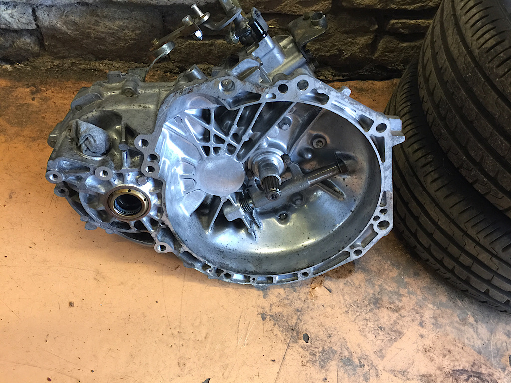

Gearbox like new with all seals replaced
Drive shafts cleaned and painted with new boots and grease

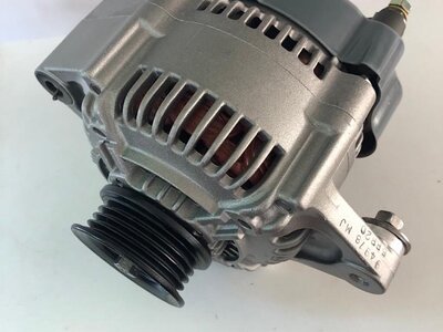

Refurbished alternator looks sparkling

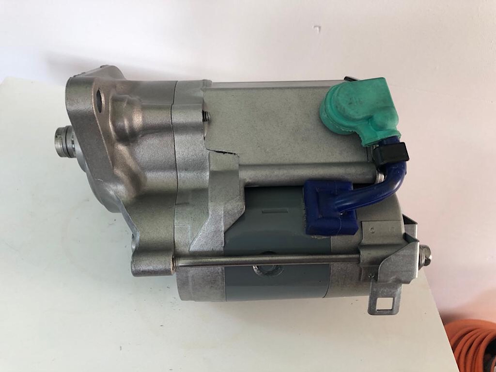

Starter motor too
I had these done through John, the very helpful manager at Motor Parts Distribution in Swindon. Collected, restored and returned within a week. And parts were obviously not a problem, because they’ve even replaced the rusty old cover plate on the alternator.

You know that the stem seals need to be driven on?
Let me know if you need anything measured.
Re: It’s only a small leak, honest
Postby Saltire » Thu 02.07.2020, 14:11
Simon_P wrote:You know that the stem seals need to be driven on?
Yes, I do :D
Except that I can’t drive mine on because the seal internal diameter is bigger than the guide external diameter.
Or am I missing something?

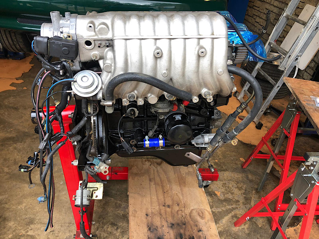

We haven’t fully solved the problem of the valve guides. I had three replacement sets which were close in diameter, but not an exact match. I elected to leave all but two of the original ones, and replaced the two I’d already taken off with the closest match from the new ones. They’re not a perfect fit, but I think they’ll be OK - they’re certainly a better fit than the ones In the gasket kit from Kelvedon. Anyway, the moral of the story is watch out of you do a top end rebuild.

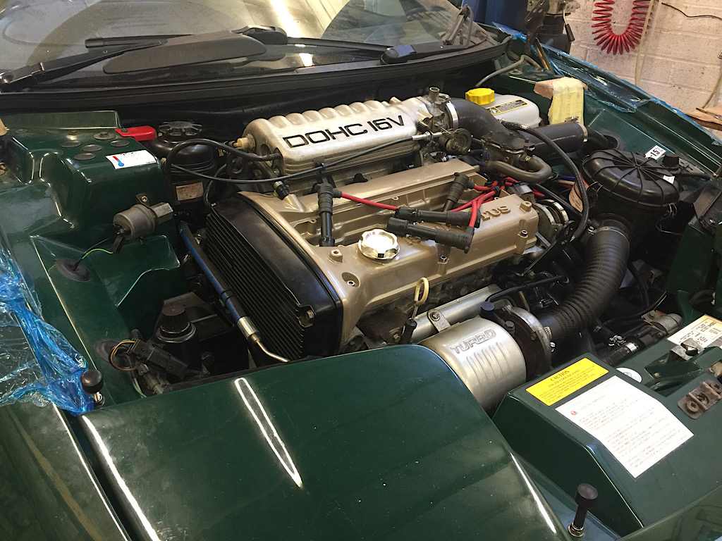

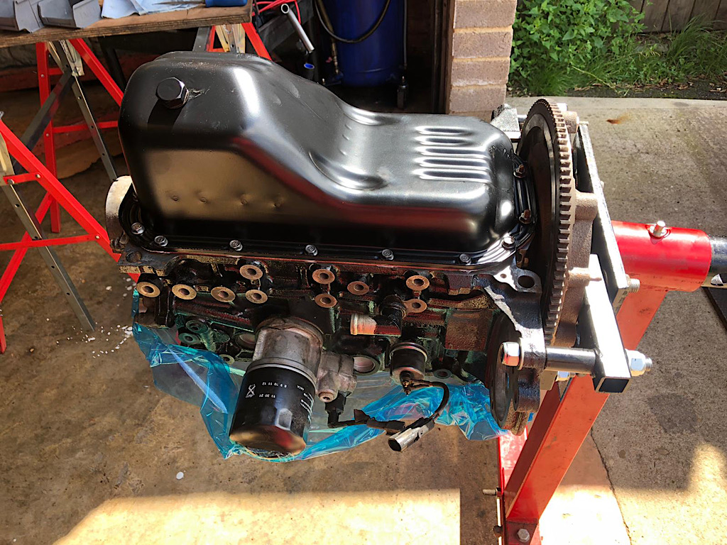

Engine rebuilt with new vacuum pipes and all sparkly

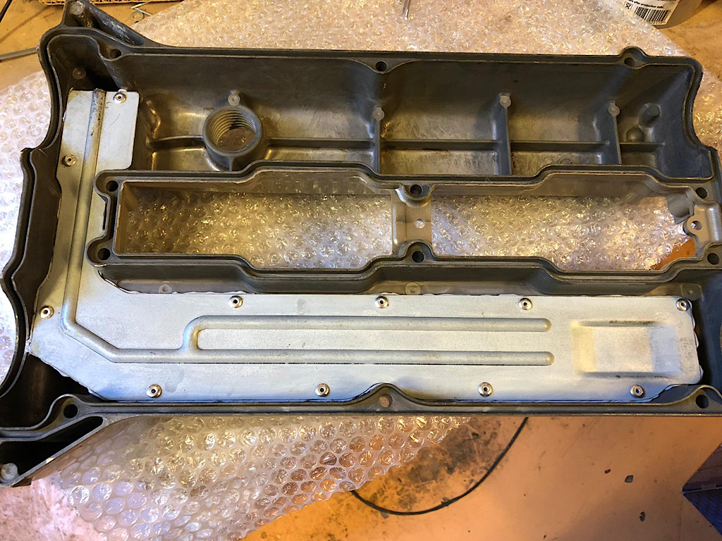

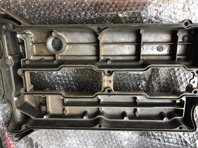

Cam cover baffle plate removed to check for blasting debris . . .
. . . and riveted back in place

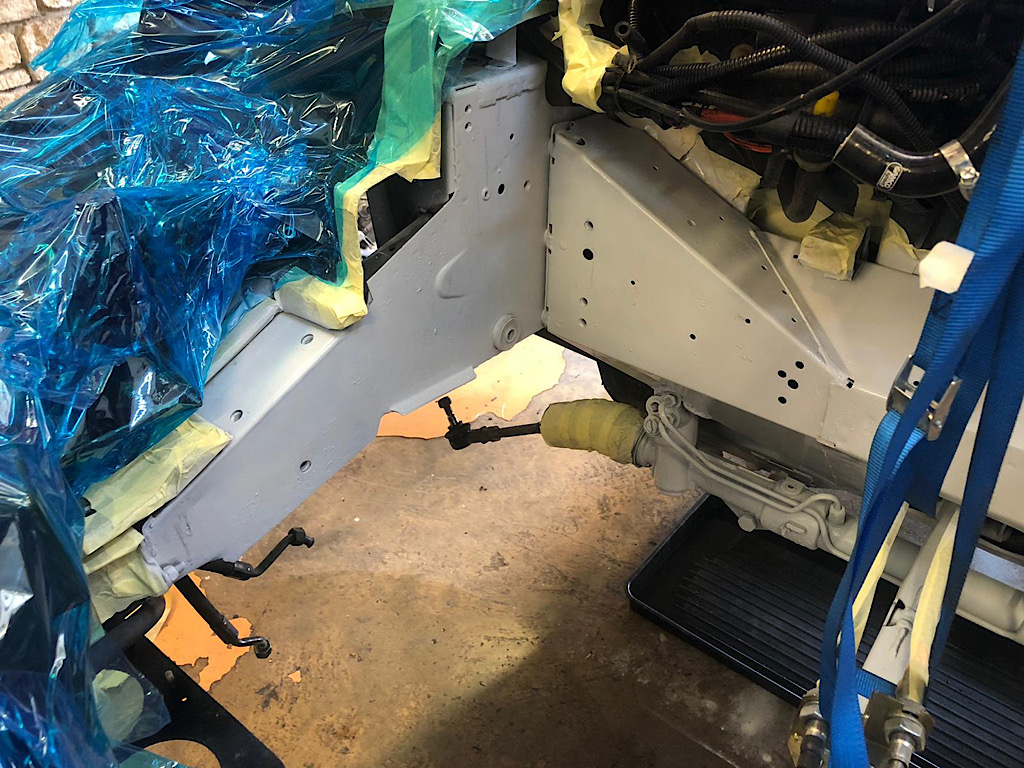

While the engine’s out, I’ve taken the opportunity to clean up the engine bay/bulkhead area:
While I was there, I noticed that the rack body was pretty corroded, so that’s been derusted and painted too:

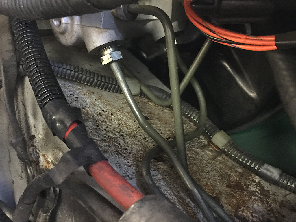

And during THAT work, I saw that the steering pipes were both in a bad state; the HP pipe was worse than the LP. I sent them off to Pirtek in Swindon, who rang me to say that the thread going into the rack isn’t a common thread type anymore. They suggested using adaptors, but that would stick out too far. Plan C was to make a new bottom piece with a right angle bend, but they’re now onto Plan D, which is to weld a couple of new unions onto the pipes to join into the rack. I think most of Pirtek in the south-west has been working on it for the last week :lol:

Alas, it is too late now, but thanks for the thought. I normally go to Cotswold Hose & Fittings for stuff like this, but they couldn’t help with this one, so Pirtek was the next best option. I must ask them what’s so unusual about the rack threads though.

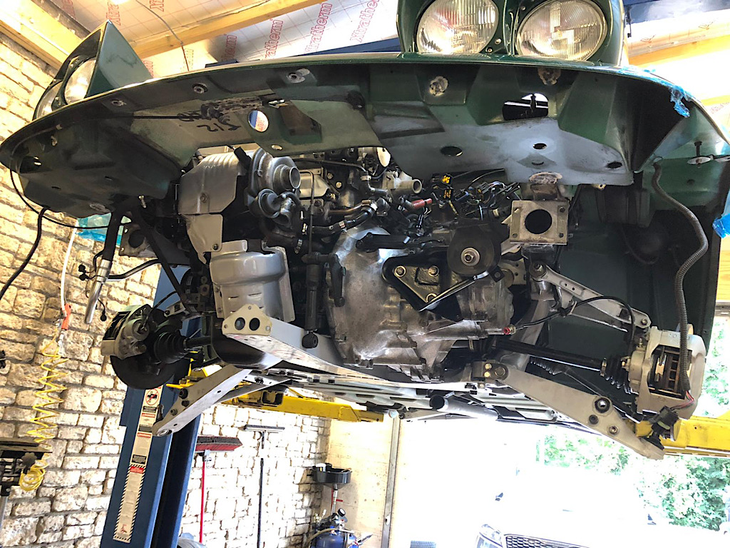

It’s much easier to take the front panel off and put the engine back from underneath:
Engine back in the car
On the home stretch, hopefully. Should be finished by Christmas :lol:
