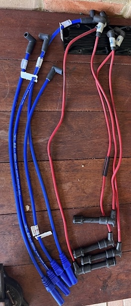

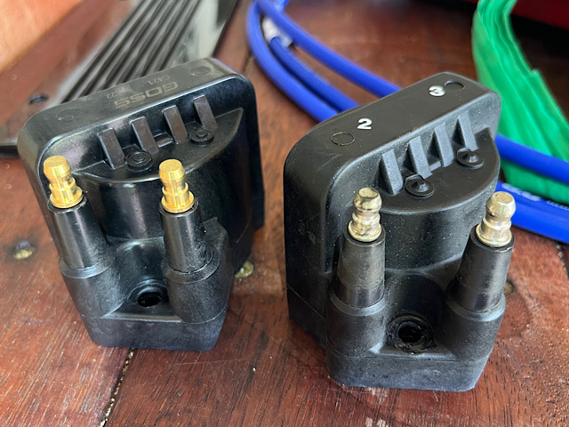

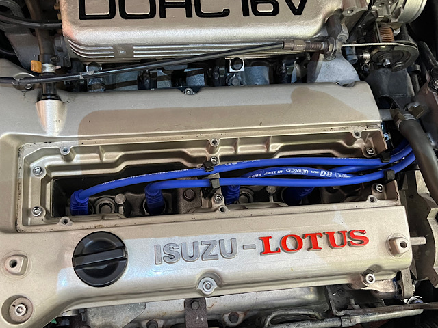

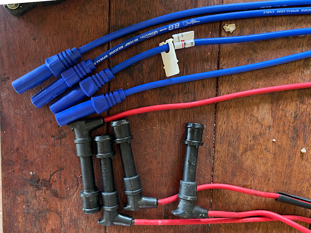

Postby 378S2 » Sat 19.11.2022, 06:54
Coils and leads swapped, and I’m going to give it 3 placebo points for improved performance. I think I’ve got a smoother idle and less hesitation in acceleration. My old leads had at least one rub where I’d had to add insulation tape, so they needed it and one of the coils looked to be from 1995.
I couldn’t find any leads that were a good swap but I did find some for less than $9 a lead that’ll do until some bespoke ones arrive.
The coils are identical, and very easy to get here since the Commodore V6 is everywhere you look. If anyone needs some let me know and I’ll bring them to the UK in January.
Not perfect, but better.
8mm fitted fine. The ends are wrong but I don't see that it'll matter much. With the old ones I still got water pooling around the plugs when I washed the engine bay that needed blowing out with compressed air.
For the leads I had to 'make a plan' - 30min sorting through the store room at my local shop found some that’ll do for now. They're 8mm and are almost the right length.
Goss C421 (check out the bling gold terminals) and the original OEM unit with the plug numbers on.

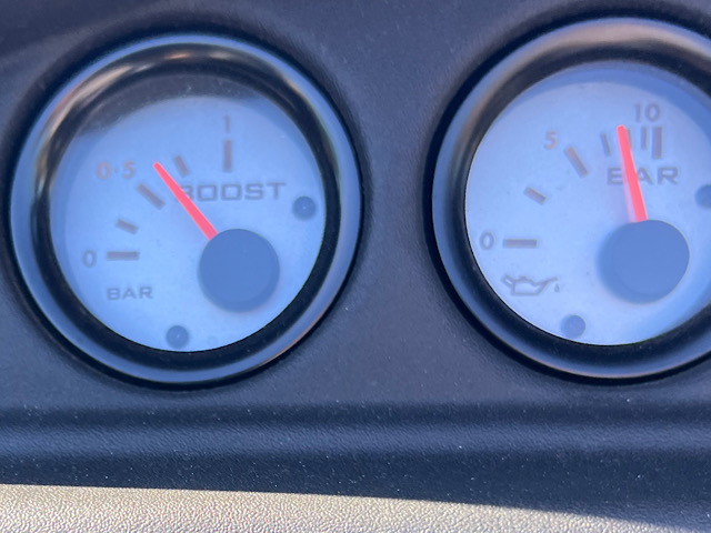

I’m adding one bonus placebo point because I now reliably have 0.6bar boost.

Postby FunElan » Mon 21.11.2022, 06:57
Interesting white face gauges....they look cool!
Oil still cold? That's higher pressure than I see on a warm engine.

Postby 378S2 » Mon 21.11.2022, 07:22
Hi FunElan - no that's hot. I'm using 10W-60 Castrol Edge Supercar, and to be fair that was running at full pelt. At idle it drops to ~2bar when hot, ~5bar when cool, and sticks around that limiting value when cold. Sometimes it will be sitting on 5bar while I'm driving, other times it'll be at that value.
Do you (or does anyone else) think I should be using a thinner oil?

Postby RonR » Mon 21.11.2022, 12:01
Considering the boost gauge is at 0.6 bar I reckon you must have been doing 3000+ revs at the time?
What's the oil pressure at Idle, hot and cold?
Postby 378S2 » Mon 21.11.2022, 12:11
Hi Ron. Probably closer to 5k RPM I would guess. At idle it drops to ~2bar when hot, ~5bar when cool, and sticks around that limiting value when cold. Sometimes it will be sitting on 5bar while I'm driving, other times it'll be at that value.

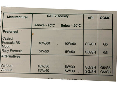

I've been using 10W60 because I read in the manual that was the most preferred, but I also read that 10W30 is preferred too. So I dunno!

Postby FunElan » Mon 21.11.2022, 18:21
Your climate is similar to mine in Los Angeles...if it were me, I'd switch to 10w30 or 5w40 for your next oil change. Does the motor have high mileage? I use a thick oil in my high mileage BMW so the oil doesn't all spill out of the seals!
At cold startup, I see about 8-9.5 bar. After a minute, cold idle reads 5 bar, and up to 8 bar when revving (low revs).
Warmed up, idle is almost always just under 2 bar, and 5 bar when on the move. If water temp increases, oil pressure decreases on these scales by a bit, naturally. I recall my chemistry classes, PV = nRT :-D

Postby 378S2 » Tue 22.11.2022, 04:31
I will give that a go and let you know.
Here's what I don't understand though...

Postby FunElan » Tue 22.11.2022, 07:19
Interesting...where is that from? The Manual scanned here is different, page 56: https://b64c533c-a9e4-41d4-a41f-7b1948b ... 6c2779.pdf

Postby 378S2 » Tue 22.11.2022, 07:32
That is interesting, my photo is from the S2 manual I got with the car, whereas that link is obviously the original. Same engine though, so I remain confused!

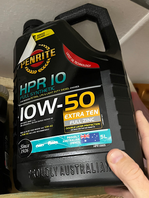

Postby dapinky » Tue 22.11.2022, 11:44
It is important to remember that oil (and every other) technology changed between the time of the SE, and that of the S2 - so with the benefit of the 'newer' stuff, together with the real-world experience of several thousand users, it is unsurprising that the oil recommendations change through time (and possibly even for the market it was sold in).
Nowadays, with things as they are, I use 10w60 Fuchs Titan Supersyn - this gives me pretty similar pressures to the OP using the same viscosity oil, and I have 140K miles on my unit.
I no longer track my car, so I am happy with the numbers, as the turbo lubrication isn't so much of an issue as it would be when running it under maximum load at all times.
Sometimes I look at the oil gauge and think that it is a tad high, but it hasn't changed really over the past 5 years that I've been using this oil..... I always found it to be too low when I was using 5w30 oil previously, and was "best" when using 15w40 (but there doesn't seem to be a big selection of synthetic oils in that viscosity, so used semi-synth.... probably no difference for the mileages I currently do anyway).
My choice for the next change is to either go for semi-synthetic, go for 10w50 synth, or even mix a thinner oil with 10w60 to get something closer to optimum. The great thing about oil viscosities is that they mix in a linear fashion - so 50% 0w30, with 50% 10w60 will give you a result of 5w45........ so if I mix 33% 10w30 with 67% 10w60 I will end up with 10W50
Postby Tuga2112 » Tue 22.11.2022, 11:47
what reading on that dial do you guys consider "normal"
Postby 378S2 » Tue 22.11.2022, 12:41
Thanks Dave. I’m due a change soon I think, so I’ll go for this stuff again which is what the previous owner was using. It’s a better price and is what comes up when you ask Penrite what oil the car wants.
