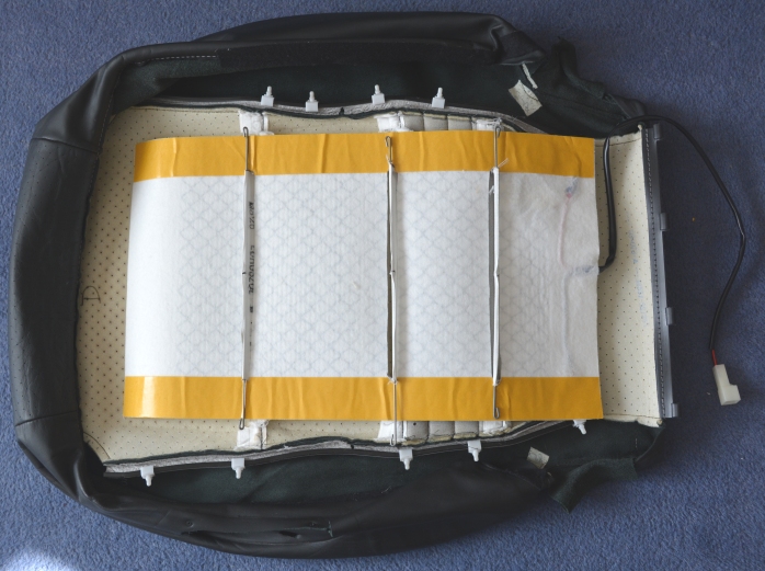

Porsche seats - Some more detail:
My Porsche seats came from a 2003 996, the seller removed them as he was fitting "sports" seats, so they were in pretty good condition. They differ from the older pure 911 seats, and are more like the ones used on the Boxster. They have electric recline but manual height and fore/aft adjustment.
I did see an improvement in leg room, the seats can now slide back enough to touch the rear speaker boxes, and they recline enough to touch the rear bulkhead. As I'm 5'9" the runners were kept roughly the same height as the originals, which meant using shorter 10 and 15mm spacers below the 10mm thick ally brackets.
The seats were dismantled, small repairs made to the foam, Hessian reinforcement added under the squabs, then seat heaters were fitted:

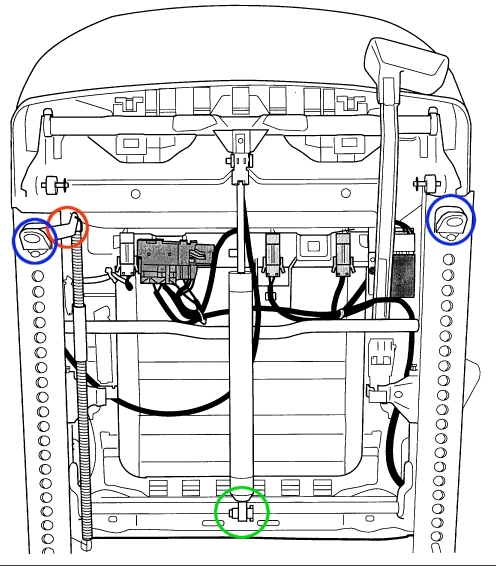

The porsche runners were used with brackets made to suit, but there's a gas strut for height adjustment (green) which got in the way of the rear bracket when the seats were at their lowest. This was overcome by making 3-part rear brackets, the centre section fitting under the 2 outer sections - I forgot to take photos of those, but if I ever remove the seats I'll take some snaps.
The front mounting hole tabs (blue) were flattened and re-drilled, and the spring mount (red) moved to the new front bracket.
