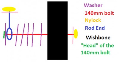

Postby Tuga2112 » Sat 18.06.2016, 23:49
Dave,
I've been re-reading the thread Par linked about the ball joint alternatives you made that Im going to place.
I want to confirm I understand the assembly process correctly.
based on the picture of the ball joint from, SJS.
the small "stick/thread" that is vertical. is the rod end, in the car the thread part will be facing upwards and held in place with a nylock nut at the top ?
the long "stick/thread" that is horizontal is the special "extra large" 140mm bolt and will have a nylock nut on the side that comes out of the wishbone. (rear of the car side of the wishbone) meaning the bolt head is facing the front of the car ?
My understanding is that i need 6 washers per side.
this being 1 at the bolt head (front of car side of the rod end)
5 on the other side of the rod end, between the wishbone and the rod end.
no washers touching any of the nylock nuts.
is this correct? wrong? or my explanation is soo confusing that a picture would be more helpful ?

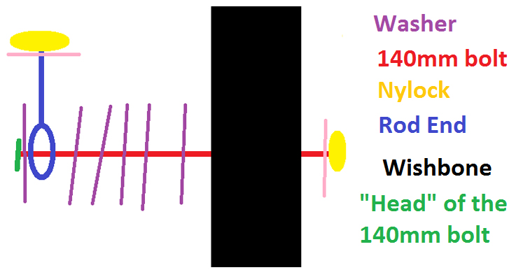

EDIT
adding a picture just to be as clear as possible
Posts: 3089
Re: Small (or maybe not) project. 91 elan
Postby dapinky » Sun 19.06.2016, 11:25
Joao,
nearly there....
...i've modified your picture a bit - it now shows the rod end/balljoint in the upright plane (as it will be fitted in the car), and i've added 2 washers under the nylocks (pink lines).
It is impossible to say exactly how many washers you will need as the 'spacer' between the balljoint (rod end) and the shock absorber as yours may be a bit different on their thickness than mine were (All Form 'A' washers should be the same, but they may be a bit different).
The best way is to remove the old unit and lay it next to the new (assembled) one on the floor - as long as the centre of your new rod end is in the same place as the centre of the ball on the old/broken one, you will clearly see how many washers it needs for them to work the same.
