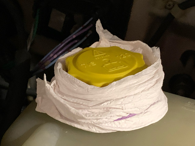

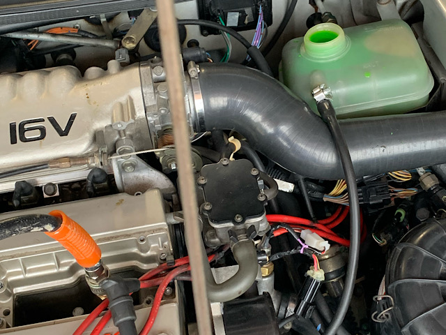

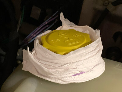

I don’t want to be too quick to declare victory... but I think I have solved the mystery of the bubbles (with help from a few of you on here, especially FredJohn) and the source does not seem to be the head gasket but an airlock in the cabin heater.
What a relief! Half a bottle of water wetter (which is just a surfactant), parked it nose up on a steep hill and I have both hot air and no more bubbles. Just a short test drive tonight, during which I got smoked by an Audi R8 but I’ll put some miles in over the weekend to convince myself.
And yes, I am a dumbass but I try hard.

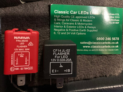

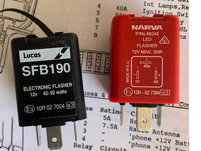

1. LED lights all round, except the headlights which I think are pretty good and I’m not sure what the fuss is about. The replacement flasher for the LEDs doesn’t click, and now that I’ve done a few kms I wish it did, I’ll either get another one or wire up an external sounder.

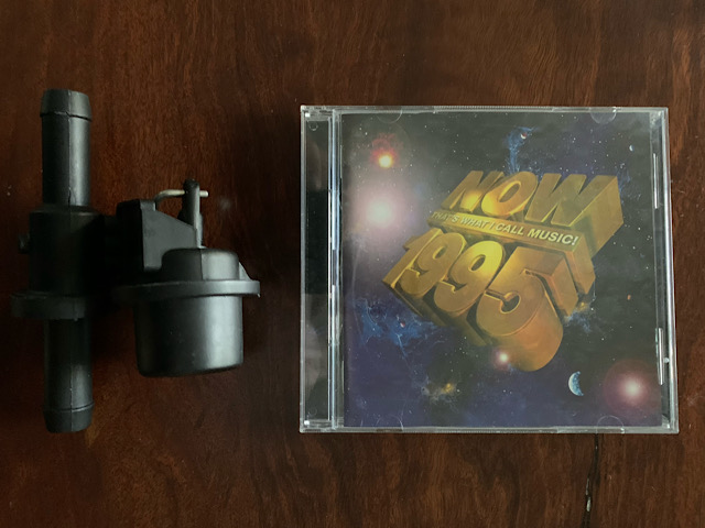

Update - I imported one of these from Classic Car LEDs, they’re a good bunch and very helpful. Works, clicks, no hassle.
UPDATE: Replaced the Narva unit with this one from the UK which works and clicks. My ying has been restored.

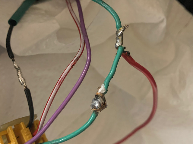

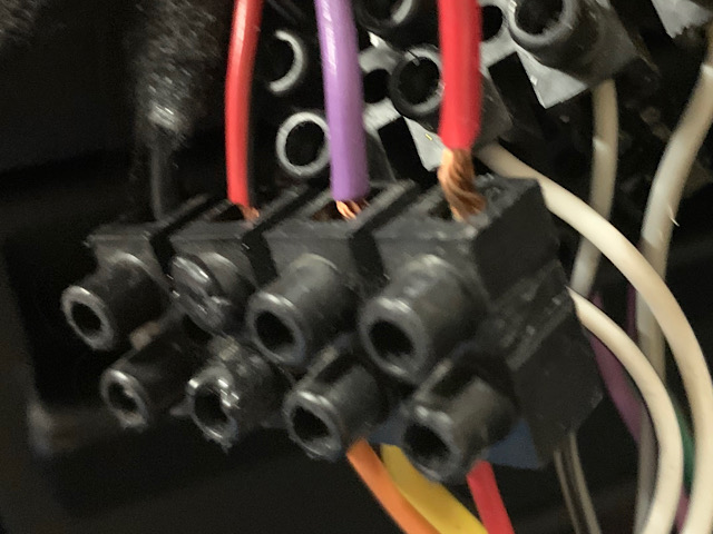

Not a fan of this style connector at the best of times, especially when live wires are poking out. I’ve jointed in a proper harness now, better than original - or at least the same as.
The ignition services feed had been connected to the clock. I’m ok with that but the work didn’t pass inspection and needed a bit of love.
The new one on the right doesn’t click, and I wish it did.

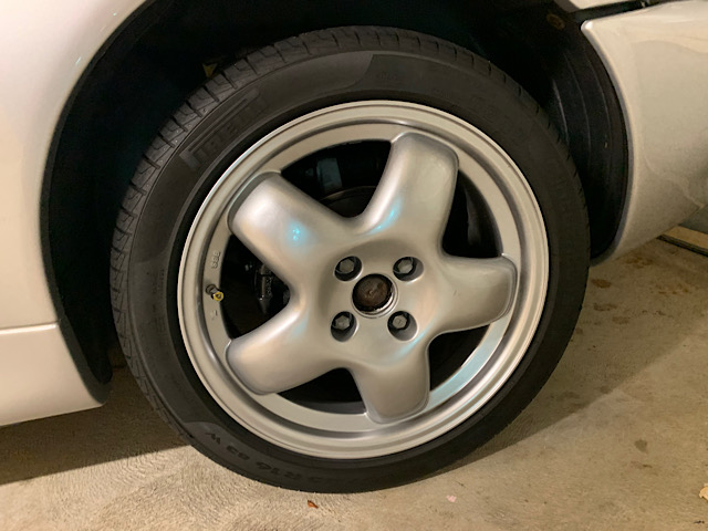

Major catastrophe here in Australia - I’ve lost a wheel centre! Can anyone recommend the best ones to get? The ones on are from SJS but they’re cheap and don’t fit well. Recommendations most welcome.
Lost, somewhere along Sunset Drive!

Postby Saltire » Fri 18.12.2020, 19:42
Last time I looked (a couple of years ago when I had the same problem), S2 wheel centres were completely unobtainable. They’re a different diameter from those on the SE wheels, which you CAN get hold of.
After pursuing several fruitless avenues of enquiry, I eventually went for four of the SJ centres, which are actually Elise centres. They are a fraction small, so can be a bit of a loose fit, but some double sided tape or a smear of sealant will sort that out. Certainly mine haven’t worked loose subsequently - I checked them when I checked the locking wheel nuts only recently.

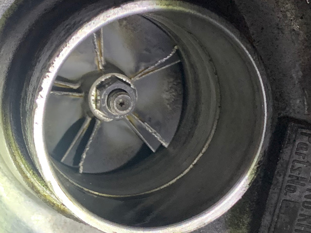

@H2J - thanks for the advice, here’s a photo. I don’t think that it is too bad, no noise etc. but I’d love to know what you think.
Some damage to the intake compressor.

Re: “Trust me, this is way better than a Mazda 3”, #378 (Ste
Postby HJ2 » Tue 12.01.2021, 13:25
Looks a little scaffed indeed, but not scrap yet. I have seen worse. If there is no noise and you want to save a few pennies then you could try re-using it.
Perhaps fold / force the real sharp edges smooth where there is damage.
Anyway, my 2 cents :D

Postby TorqueHorse » Tue 12.01.2021, 16:06
What causes this? Bad air filter?
Postby 378S2 » Tue 12.01.2021, 22:13
I think so - we have a lot of sand and dust so it wouldn’t take much. I bet the filter was mis fitted for a while.
