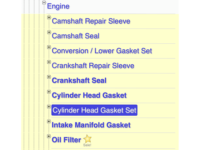

Saltire wrote:Rock Auto in the US are very good for parts which were used on other cars of the period.
Just logged in to Rock Auto to have a poke about and I couldn’t find any cam belt related things. What am I doing wrong?

Look under timing rather than cam.

I have 2 sets of 'searches' for use on RocakAuto (and other USA) websites....
Isuzu > 1991 > Impulse > 1.6 Turbo
Oldsmobile > 1989 > Cutlass Supreme > 3.1 V6
The first is for engine (mechanical) parts (not ignition leads, as the coil packs are in a different place, so lengths don't suit us), Gearbox parts....
..... the second for rear brake callipers/repair kits/pads/parts (but bear in mind that GM used a calliper on the left, when Lotus use it on the right - so look for the side you don't want!).
They can usually deliver here within 72 hours - and I suspect the delivery to Aus won't be a lot different on either cost or time (but I may be very wrong, so don't quote me).
I have found over the years that 'odd' things differ between the Isuzu application and the Lotus application - ie, the belts for PAS and Altenator are slightly different lengths to allow the unit to fit without hitting the bulkhead - only an inch, but makes all the difference (apparently ;-) ) - so worth checking the Wiki which has the details of what is needed.
Certainly, I have a 'standard' list of parts I buy from them:- Dayco Timing belt kit, with belt, tensioner and idler - waterpump with gasket, PAS belt, Altenator belt, Thermostat..... usually lands on my doorstep after 3 days and costs vary with exchange rate etc, but IRO £70 all in.
