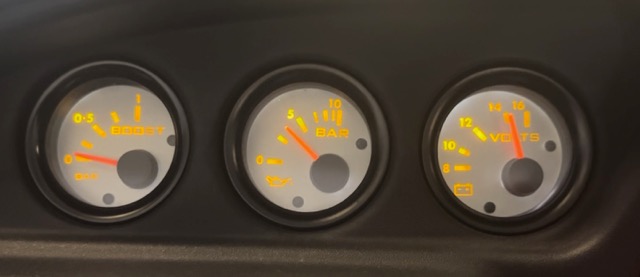

after posting the video for the alternator being rebuild. i have spent the afternoon re-installing the alternator.
now on iddle the voltage meter is reading 16v which seems a bit high.
so. im going to add another thread on the electrical section to get some input from the certified sparky-es before starting the car again.
no video of installing the alternator will be released. because i tried to film. but clearances are so narrow that its practically impossible to get a camera to point at what you are doing.
depending on the conclusions about the 16v i may be refitting the subframe (and doing a video on that topic) or possibly removing the hood.

Postby chrism » Fri 27.01.2023, 22:53
Aw, I feel for you...that's bad luck Tuga :( .
If it's any consolation I felt that your vid was really informative and certainly gives me confidence to have a go (assuming the recon parts are still available...)
Imo it can only be the voltage reg at fault? In your place I think I'd put the old one back in and give it a whirl.
The job was certainly worth it to renew the bearings and brushes, clean it out and 'sort' that overheated diode bridge.
Perhaps get another voltage reg to keep as spare if that was the fault. (What would be the odds of getting two bad ones in a row?)

Postby 378S2 » Sat 28.01.2023, 09:26
If it is any use to you, here's my 'normal' at idle.
