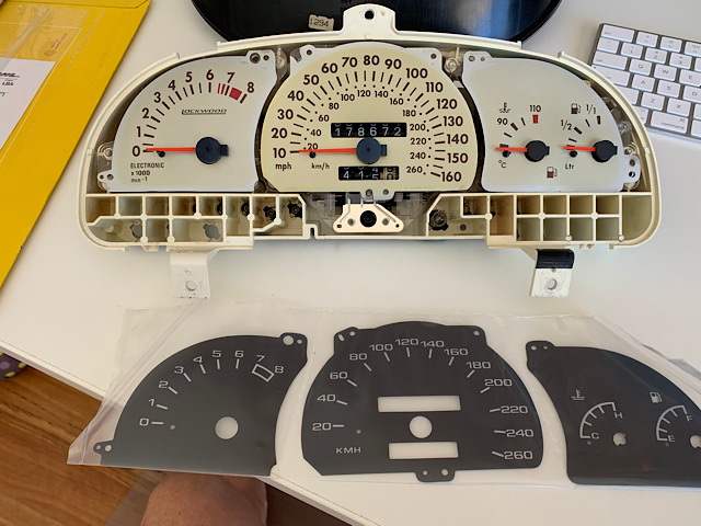

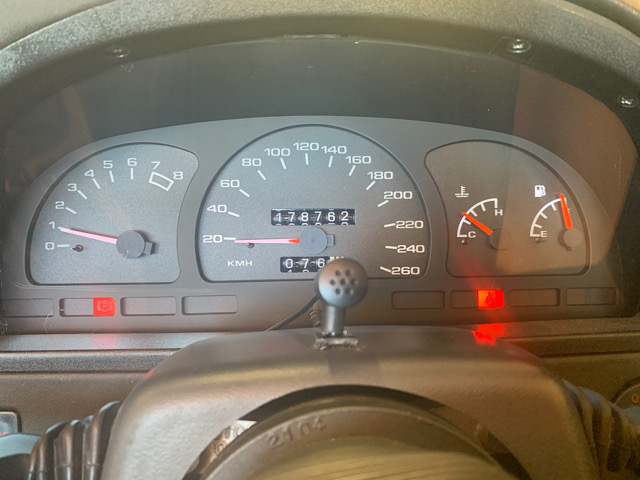

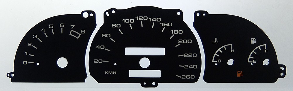

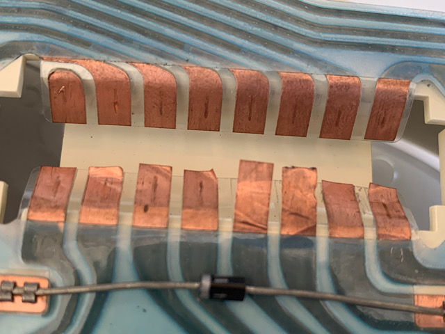

They’re faded, cluttered, and the main scale is in the wrong units so it had to go.
Cliff - you motivated me!

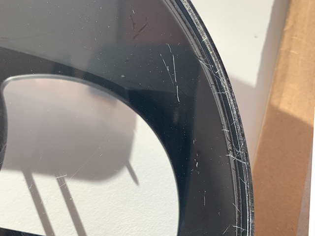

With the cover removed you can see the fading, not sure why the Speedo has faded the most.

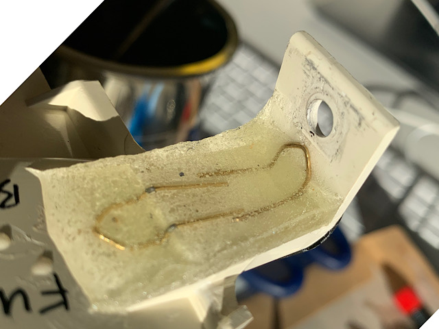

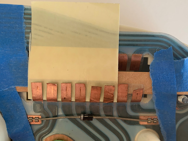

Disassembly included some scope creep, not sure if I did it or it was broken already but I had to epoxy the Mount back on. I put some metal reinforcing in there too.
I don’t like the bubbles... and it didn’t turn out as neat as I would have liked but it is strong as an ox and it’s the sort of thing you’d have to be very keen to find.

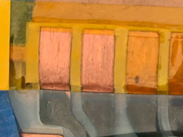

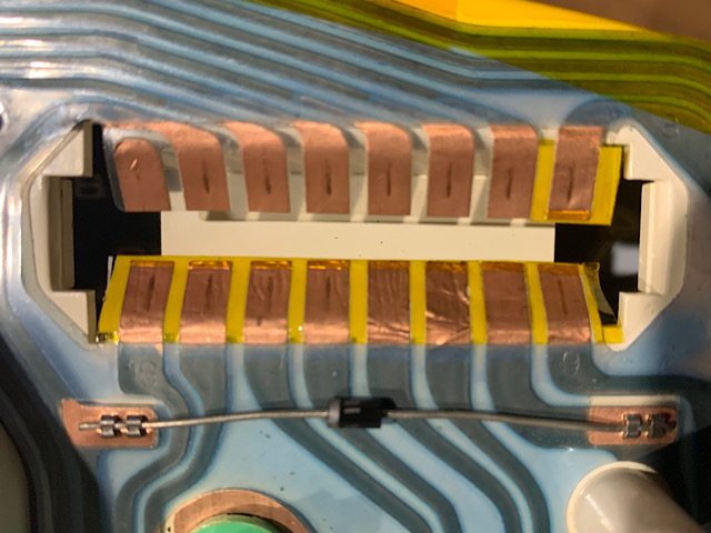

The connectors were in a mess, particularly the long one. I used double sided tape to glue it back down and then kapton tape on top, cutting out the contacts to redo it.
In a bad way...
Stuck down
The finished connector - not perfect but solid and will last for a good few years I think.

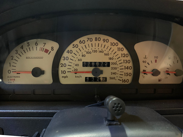

Cutting out the masks - love kapton tape.
I used acrylic polish to refresh the cover glass
My Lotus Easter egg!
Looks much better I think.
Top tip if you’re doing this job - you’ll need to go for a test drive to check you got the Speedo and tachometer needles in at the right angle as they are not keyed. However, inserting and removing the cluster involves so much swearing you won’t want to do it. What worked for me was to put it back in without the black plastic top and glass assembly - that is very quick and easy. I went for a drive like that, recalibrated my main gauges using my GPS (and a bit of guess work for the revs) and then put it all back together.

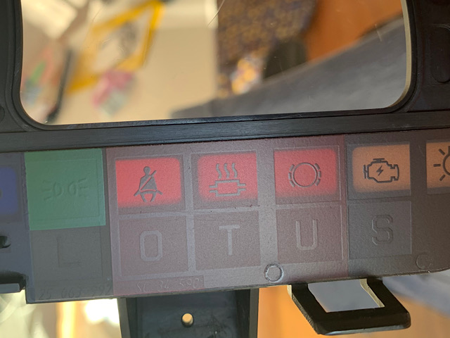

Top tip #2, it’s a right pain putting LEDs in as you need to know which way round they go. I figured out the pinout of the three connectors and then used a 12V source to check each one on the bench. The copper tracks are old and easily damaged so I don’t recommend mucking about with them if you can’t see what you’re doing properly, as you have to when it’s on the car. If you want a copy of that pinout let me know.
With it all done I think I looks great. Very simple, and uncluttered. The LEDs are very noticeably brighter than the old bulbs and the backlight is now a very pure white rather than a dirty yellow. I’m not a fan of the red on black, so this is a compromise for my otherwise completely stock S2.

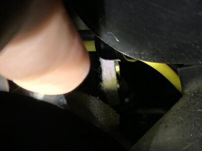

While I had it apart I took the photo of the felt pad / heater switch mod that I promised...
This was the best photo I could get, sorry!! Self adhesive felt pad stuck to the heater valve flappy thing so it makes better contact with the vacuum micro switch and closes the valve when not in use.

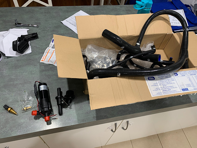

1. I’ve ordered a nearly complete set of Samco hoses from Hans in Holland, they should be here soon

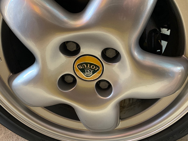

2. I’ve had some very nice 3D printed wheel centres done by a local engineering student. The ID is 52mm for the decal and I couldn’t find and Lotus badges that size so I have two sets of Union Flags on the way - proper colour and greyscale. Will decide which one I like best.

My Samco parcel has arrived (thanks Hans) - which means I now have all the parts needed for a brand new cooling system with the radiator and thermostat already done and a two year old water pump. I do have a water pump in my box of parts but I’ll leave that well alone.
My set of hoses came at a great price but I am missing the turbo hoses (TB1836 and TB1837). If anyone has those in stock I would love to take them off your hands.
The Samco hoses are beautifully made and I see now why they are so highly rated. My existing hoses are original and showing signs of coolant seeping down the fibre inserts, so it’s time for them to retire. I don’t fancy the job of changing them much though.
By my calculations, it’ll take a full weekend and all the skin on my knuckles to change this lot over.

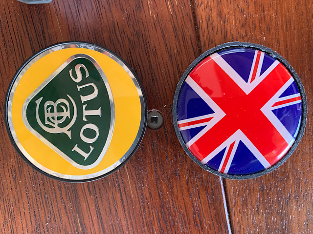

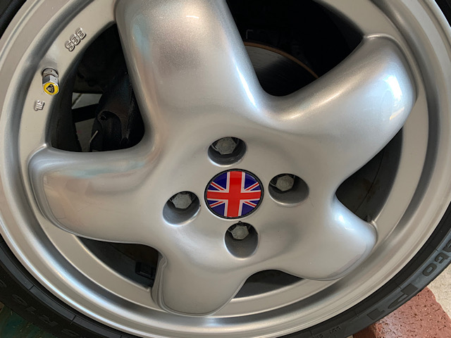

Another huge update from Perth - new wheel centres. I lost one of the Elise ‘Lotus’ centres and didn’t want to replace with the same badly fitting ones so I had Toby’s design 3D printed and waited approximately 15 years for some union flag stickers to arrive.
I think I prefer the Lotus centres! The union flag options fit beautifully though, if only I could find some 52mm Lotus badges.
Next update will be something meaty I promise.
EDIT (+1 day) - they are growing on me. I don’t like that they’re not stock, but as ‘mods’ go they’re hardly difficult to reverse. I quite like the splash of colour, and being that I am overseas a little bit of me likes flying the flag in some small way.

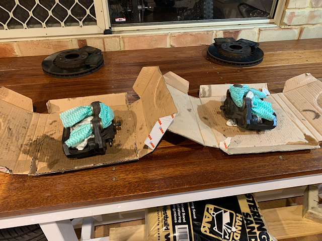

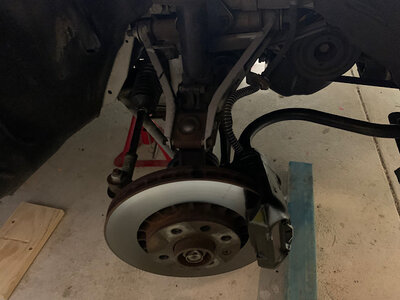

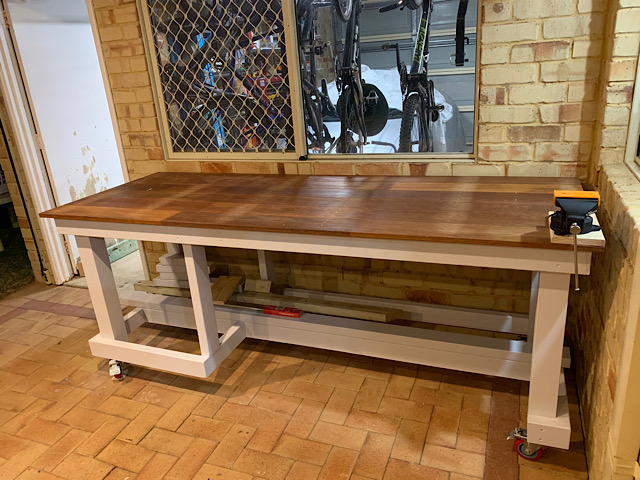

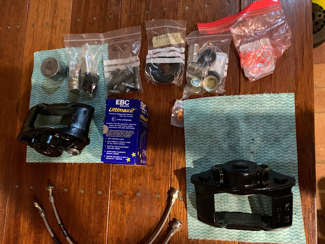

Now the real reason I haven’t done my front brakes yet is because I needed a workbench (which I have now built) and because I have a rational fear of jacking the front end up. When I did the radiator my friend the all knowing car guy helped me so it was not a stress. But I’ve been looking at it for months now and making plenty of excuses.
We’ve had a mini-outbreak of COVID here (sorry for my UK and US friends, we had one case that leaked out of quarantine) so I’ve been working from home and I finally ran out of excuses. The callipers are now off, stripped ready for clean up and paint over the weekend. The sliders were really stuck in there, needed a hell of a lot of persuasion to get them out so I am expecting big things.
I’m open to paint suggestions. I have half a can of black from the rears and I bought a can of yellow because I thought it would look cool. What’s the consensus? Understated black, stop-faster yellow? Tesla white? Red? Gold? Silver? I will eventually have them blasted and gold passivated per the OEM spec so I don’t mind a temporary detour from an otherwise bone stock car.
Should look a bit fresher with rotors, pads, hoses and a full calliper rebuild. The key question though is what colour to paint the calipers?
Needed a workbench - man it makes life a lot easier. Still have the drawers to go.

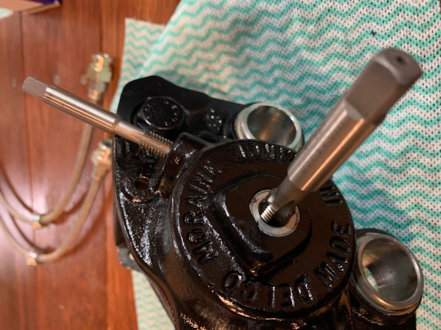

Stripped down and ready for clean up and paint. The pistons and sliders were well jammed in there, and the pads were unevenly worn so I am expecting a big improvement.

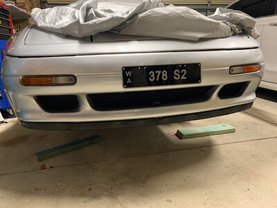

I grew a pair and jacked it up using my hydraulic jack on one side and the OEM jack on the other. Jackstands on the secondary points. Maybe my fear was irrational…

Postby 378S2 » Sat 01.05.2021, 14:25

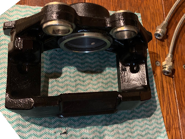

Paint selection competition is closed - I sprayed one of the old rotors yellow as a test. The shame I would feel doing that to the car means temporary or not, they’ll be black!
EDIT: some photos so far

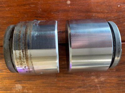

The cylinders needed a tickle with metal polish but they came up really well.
New everything will make a huge difference. The old moving parts were so well jammed in there I suspect they were original.
I used the old seals for masking the paint work, they did a good job.
Painting is hard - so glad I didn’t make these yellow.

Postby Simon_P » Sat 01.05.2021, 15:12
Was just about to say black because it won't look dirty.
With the OE front calipers it is worth taking the piston out and making sure that there isn't a rubber tide mark on the sealing surface - it can make them sticky.
Nice bench!
Re: “Trust me, this is way better than a Mazda 3”, #378 (Ste
Postby 378S2 » Sun 02.05.2021, 14:55
Simon thank you, yes I pulled them out and cleaned them up. Just finished fitting all the hardware - wish I’d waited a bit longer to let the paint harden.. few chips to touch up now. Doh!

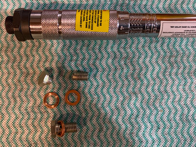

Quick question for the Collective please: I lubricated the sliders with plenty of silicone grease but in the cylinder I only used brake fluid. Is that correct? It’s an easy fix right now but will become a pain once I refit them. Thanks!
378S2
Posts: 268
Joined: Wed 09.09.2020, 02:19
Location: Australia
Postby TorqueHorse » Mon 03.05.2021, 04:59
Yep :)
Postby 378S2 » Mon 03.05.2021, 14:42
TorqueHorse… I will just leave this here:
Not as hard to fix as a main shell but an extra dumb mistake given the reminder you gave me a few days ago!
