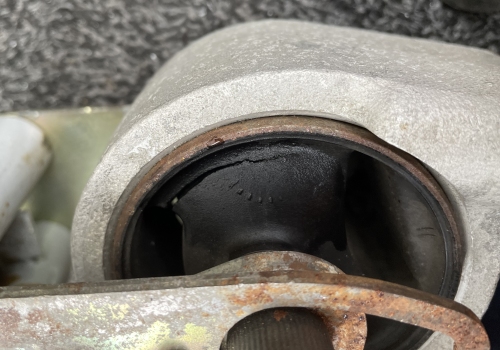

and finding a crack in the rear engine mount bush:

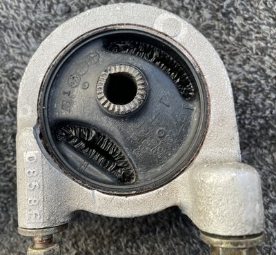

Here's the new bush after it's appointment with some copper grease and a 12-ton press:
The voids in the old bush were just right for feeding a hacksaw blade through - I didn't fancy my chances of pressing the old one out without b*ggering up the ally housing.
