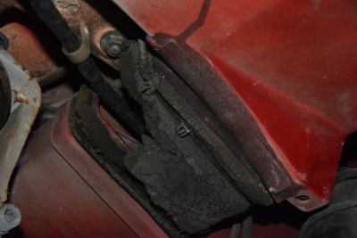

    Fixed leak into passenger footwell - The foam heater intake shroud deteriorated + the wiring loom dropped and cut through it - new foam is wrapped in neoprene sheet to keep out water and give some strength.

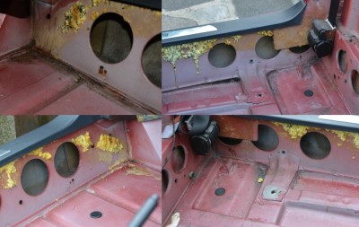

    Removed seats and carpets, inspected outriggers (all good!), painted outriggers and replaced underfelt with 12mm closed cell foam

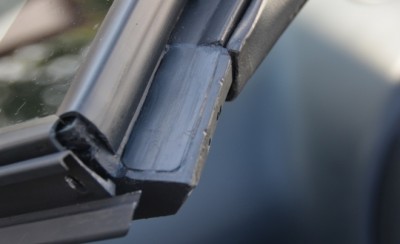

    Fitted a set of Jamie's one-piece Windscreen and A-pillar seals - Jamie the Seal my dry knees thank you!

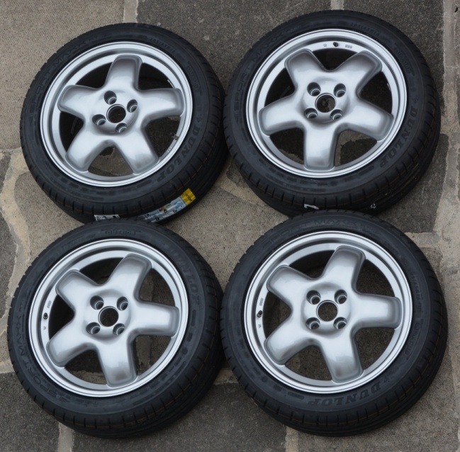

    S2 Alloys refurbished and new Dunlop SportMaxx RT tyres fitted

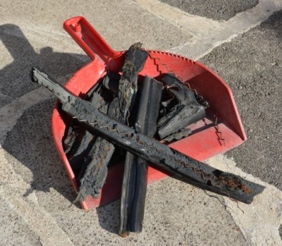

Reason for leak into passenger footwell:

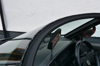

What was left of the A-pillar seals:
Sealing old seal attachment holes in header rail with Neoprene sheet and Sikaflex:

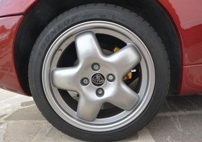

Wheel refurb - IMHO darker colour suits silk red:

Not sure if you meant the back of the car or the outriggers Clemo:
The other meaning is too dire to contemplate! :shock: :shock: :shock:

Neither of those and least of all the last option ! ... i thought you had put the Kia's back on .
Both very good photos in different ways
It is very pleasing to see that your inner sills are in exceptional condition ( as are mine )
So it goes to show to those who are fearful to go and have a look. They may be pleasantly surprised .

I must admit to crossing my fingers when removing the underfelt/sponge around the outriggers. It looks like the car had the drain holes in the sills from new, so that probably helped.

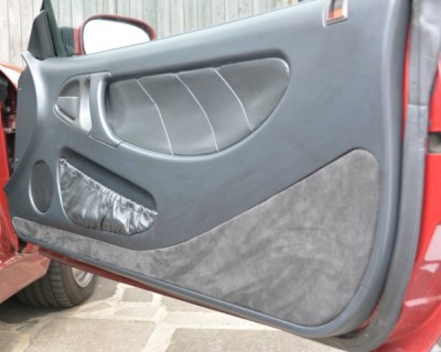

Replaced door card carpet with removable panels of Ply / Neoprene closed cell foam / Alcantara

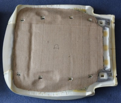

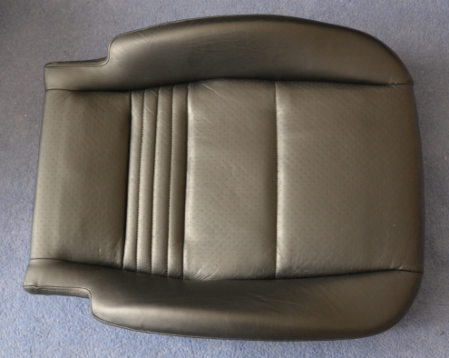

Repaired split in Porsche seat squab foam and reinforced with 15oz Hessian, rebuilt seats with seat heaters

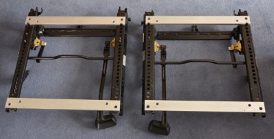

Made Adaptor brackets for fitting seats into car - still need to fettle the rear brackets a bit as there's contact with the seats gas struts

Very nice, I like the carpet replacement and have been thinking of doing something similar. Couple of questions if you dont mind:
-What thickness of ply did you use?
-How have you fixed it to the door panel, is it just bonded in place?
par
Posts: 572
Joined: Thu 19.02.2015, 23:22
Location: Fife
Re: Step by Silky Step
Postby dapinky » Sat 28.04.2018, 12:45
This is similar to how i did mine a couple of years ago.
For fitting, i made the 'base' out of 3mm hardboard, which I painted with fibreglass resin to give it some water resistance. I drilled 3 x 6mm holes straight through the board and the door panel (making sure that they were clear of anything underneath!)
They were fixed with 'Fir-tree' fasteners.
Then removed from the door card, covered with thin neoprene foam (spray glued). Once dry, i used a sharp blade to pare down the slight lumps where the firtree heads allowed the foam to bulge out a bit, resulting in a near flat covering.
Then glued the alcantara over the top, and tucked in round the back.
Once dry, they simply pressed into the holes in the door card. They are still there now, but easily removable if required.
Postby RonR » Sat 28.04.2018, 18:54
My method was almost exactly the same as Dapinky's but using 3mm Ply, varnish, then 3mm foam and finally Alcantara.
Fixing is by 3 x plastic 'rivets', the top part is stuck to and passes through the ply and the bottom part goes through the door card:
It seems to be quite secure although time will tell....

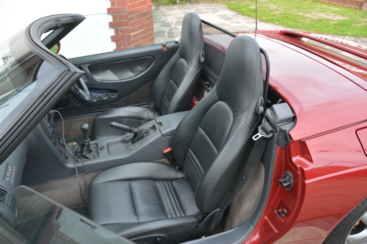

Porsche seats fitted after making 3-part rear brackets, finally resolving the gas strut clearance problem. Had to add a couple of washers to the outside seat brackets tilting the seats inward ever so slightly to stop the hood frame from rubbing on the seat back.
Still need to fit the seat heater switches somewhere, possibly in the centre console cubby box?

My wheel centres were looking a bit tired, so it was time for a refurb. Decided I like the look of black badges, so ordered up some domed ally ones from Epay to try. Removed the old badges and the outer lip from the original S2 wheel centres, the new badges (56.5mm) just overlapped the old centres but still fitted in the wheel recesses, so I Sikaflexed them on and now they're looking a whole lot better IMHO. Well worth £10.28 for 4!
