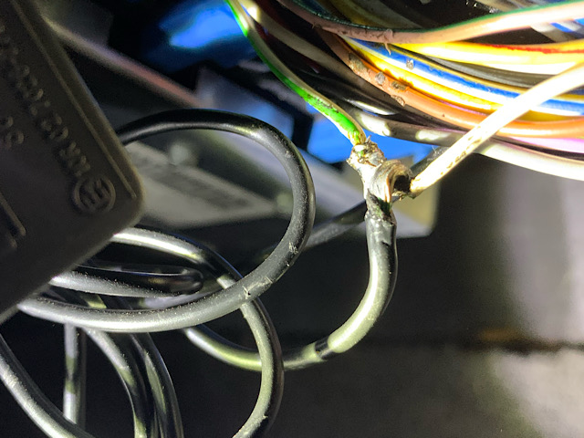

Did you own #378 in October 2016? Did you pay $500 to a garage in Gladesville I won’t name but do have the invoice for fixing a lack of power to the fuel pump?
You need your money back.

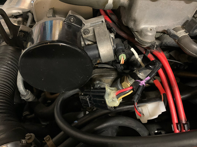

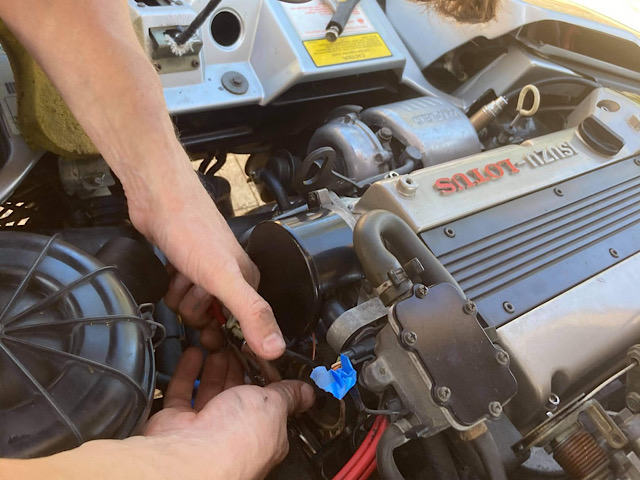

I didn’t get enough photos, sorry, but they butchered the job. Rather than fault find and discover the issue was with the immobiliser (of course it was) they ran a non-fused cable straight to the pump, chopped up the ECU harness soldering a new relay in without even insulating the hack job and - worst of all - bypassed the inertial cut off switch. I’m glad nobody has needed to rely on the crash fuel cut off since then.
My first job out of uni in 1999 involved, amoung other things, wiring changes on military aircraft so this was a good job for me to get started on. It’s all back to factory now.
ECU harness butchered, badly soldered and not insulated.

Glad to hear that problem’s been solved once and for all. Appalled - but not surprised - to hear about the Gladesville Bodgers Company. :evil:

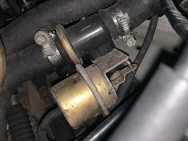

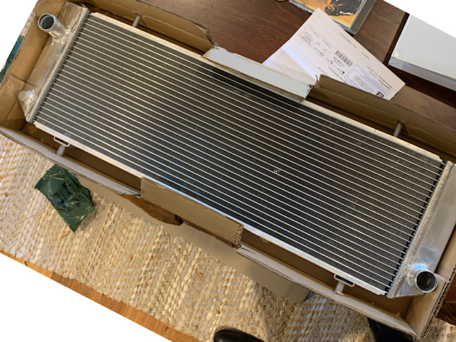

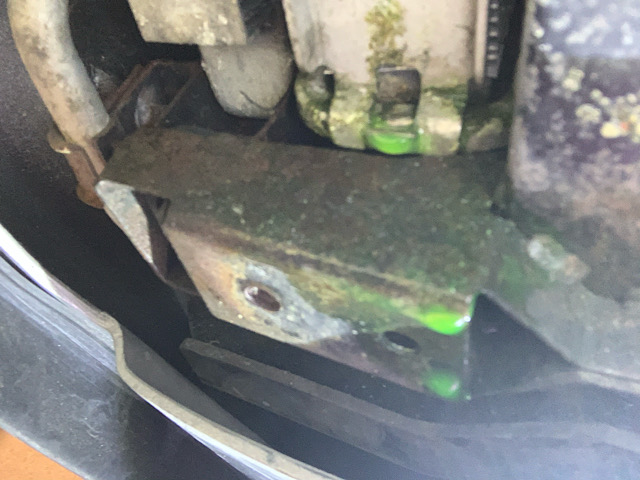

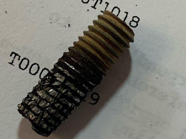

The radiator started leaking on day 3 of ownership, it took a couple of days to swap it over but no issues since. The biggest challenges were the access and a sheered bolt on the thermostat housing. I also bought a new coolant recirculating pump but the spigots are too small, I’ll do that another time. The one on there works but is a bit noisy. Given our summers are >40C I wanted the cooling system on top condition, which it now is.
Not a big leak, but it’ll only get worse so I replaced the whole thing.

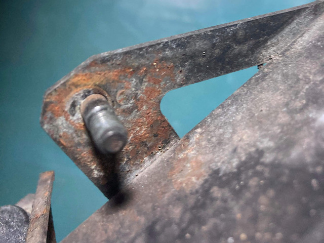

WSM said that it would take 2 hours. It didn’t!
One of the fantastic things about Australian cars is the lack of rust. This is the most rust I’ve seen so far on the car. (Fan mount)
This little piggy went weeeeee all the way home.
We were just about done when the bolt sheered. My girls learnt some new words. Gentle application of fire and a new pair of mole grips got it out. I was pretty worried I would need to pull the whole lot out to extract it. New bolts fitted, lots of anti seize, torqued properly.

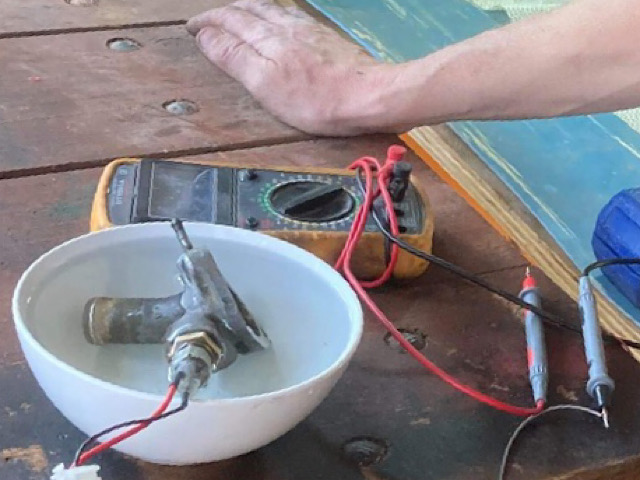

Confirming the theory that I have a 90C fan switch. I can’t see any downside to it coming on early nor to the pump running after most outings so I will leave it.

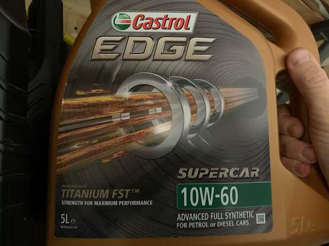

Glad you mention that... ok so the great oil debate. So many posts, so much conflicting information.
In the car there’s a sicker, the log book’s ‘preferred’ contradicts it and then there are a thousand posts.
So... is this oil the right one? I just want the best possible!
Is this the right one? Hot climate advice please!
Exhibit B
Exhibit A

Postby rip » Fri 16.10.2020, 13:58
Yes, they've changed the name of it a few times, presumably as they update the product.
I think:
Edge & Edge Sport replaced RS
I have no idea what the difference between Edge & Edge Sport is (was). They were not split by viscosity ranges. 10W/60 was certainly available in both.
It looks like these have now been replaced by Edge Supercar.

Postby 378S2 » Fri 16.10.2020, 14:37
Thanks for the reassurance. I would like to know if it was the engineering team or the marketing team who put titanium in it!
Any tips for the oil change? I’m half tempted to go to a small garage near me and get them to use my parts and save me the hassle of doing it on the floor. I should have had a good look when I did the radiator, but at that point I thought the interval was 12 months so it wasn’t on my radar.

I use 10/60 oil too, but only a decent brand.

Oil viscosity is a personal preference. I prefer 30 oil as it would have been what the engine was designed and tested for and is pretty standard in terms of its composition. Also thicker oil takes more pumping around so you are losing power and fuel economy. Lotus' change to 60 has always struck me as standardising for newer models rather than for technical benefit - I don't imagine they did much in the way of testing.
The standard fan switch is 110 and the thermostat should be 82c. It starts to open at 82C and may only just be fully open at 90 so a 90 fan switch is a bit low. If you drive in traffic you'll be watching the volt meter as the battery goes flat..... especially with a high ambient temperature.

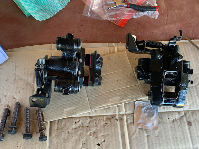

Brakes Part 1 (Rear Calipers)

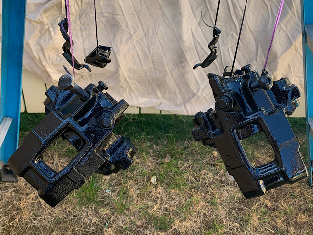

Postby 378S2 » Sun 25.10.2020, 03:33

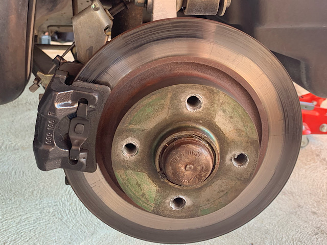

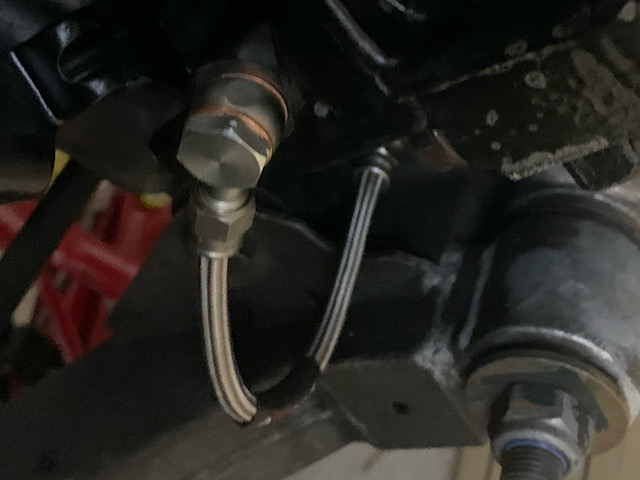

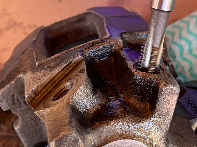

A phenomenally satisfying few hours stripping, cleaning, painting and rebuilding with all new seals and hardware of the rear brakes. The SJS rebuild kit (seals and sliders) was great, not quite enough grease so I borrowed some from the front caliper set. I’ve also got the new hoses to replace the originals.
The rebuild was the harder part, although the second one went together much faster.
I wanted to paint them red, but the sensible bloke in the shop talked me out of it. Apparently single piston calipers don’t help you stop faster no matter what colour you paint them. I may gold passivate them next time, just very time consuming so this time I have not.
The SJ stainless hoses were excellent - they were no trouble. A couple of stuck hose bolts that needed a bit of heat. I must get some proper brake line spanners.
The old pads were spanked and the sliders were all stuck. Should see a nice even wear pattern when it’s all done.
Very little corrosion on them, just a general rub down and clean up before paint.
Early summer and already my grass is terrible
Ready to refit once I swap the hoses over for the new SJS SS set.

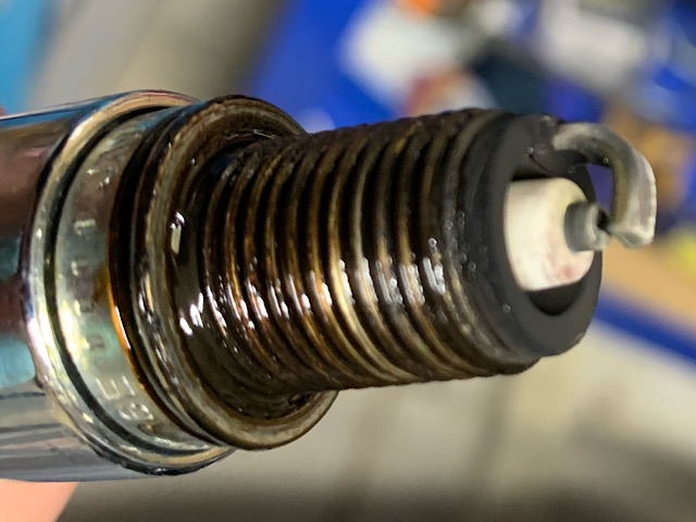

Cooling system - What’s wrong with it? Anything?
Postby 378S2 » Sun 25.10.2020, 12:26
Hello Folks
I really need a little help with an odd problem.
Since I changed the radiator (and before as well, although I was less paranoid about it then) I have observed air in the top of the radiator radiator after every use. I’ve followed the WSM, bled like crazy but almost 2 weeks on it’s still coming. I can see bubbles coming out the top breather line (see video) but when I did what I have named the ‘Chicken Test’ it does not inflate.
Does anyone know what it could be please?
I do not have...
- Oil in the coolant
- Coolant in the oil, nor emulsion signs on the dip stick or filler cap
- lumpy idle at cold start
- white smoke
- any stored fault codes on the ECU
- any coolant leaks, nor any noticeable coolant usage

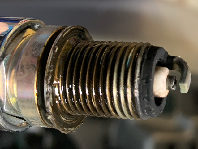

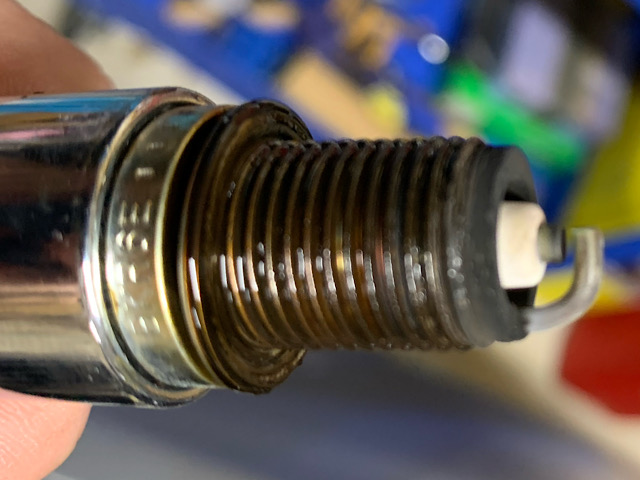

- any signs of badness on the spark plugs IMHO
- any other observable engine issues while driving or idling
The car passed a ‘sniffer test’ yesterday. The guys at the garage I took it to were confident it wasn’t HGF, he removed some coolant and sent me home. To be fair he has been turning spanners for 50 years and had two stunning E Types he’d just finished restoring so who am I to disagree? But something isn’t right, and I don’t agree. That void above the radiator is filling with gas from somewhere, and if it really isn’t a head gasket problem then what is it?
I’ve ordered a leak down test kit, is that the only way to rule out HGF? I’ve read about others who passed a sniffer test and still had one. Is there anything else I should do? I’m really hopeful it isn’t too serious but my aim here is to make it as close to perfect as I can and I’m not interested in taking chances by ignoring it.
Chicken Test: https://youtu.be/uiL_vvTS2m8
Top hose bubbles: https://youtu.be/ZNrl5MXEqog
Thanks!
George

Postby Fredjohn » Sun 25.10.2020, 12:56
Presume you are bleeding it through the bleed screw under the nearside headlamp.
Is the heater element hot? Air can get stuck in there. Is the heater water control valve functioning properly? A non rusting plastic version from a Volvo is the usual replacement.
As a basic precaution tighten all your hoses. A leak could be hidden by instant evaporation and not show up when cold and no pressure. Did you put the new thermostat in the correct way up?

Postby 378S2 » Sun 25.10.2020, 13:08
Hi Fred John,
Yes from the top of the rad. The coolant level is higher after a run when cold than before a run when cold, and returns to the original level once re-bled. So I think air is entering the system from somewhere.
<updated> comparing to Wiki I can see I have the original heater valve design, looks to be in reasonable condition. The part for a Holden Commodore is easily available here for only AUD15 so I will change it next time I open the cooling system.
Yes, jiggle pin to the top, bulb outwards. I’ll check the hoses again.
Really got me scratching my head!
Is this the original heater valve?
