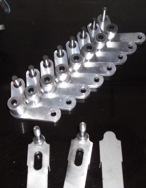

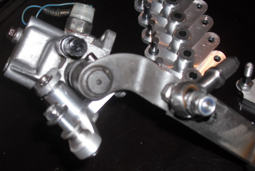

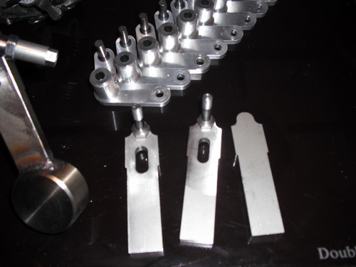

Postby bobbrown » Tue 03.01.2012, 17:55
Here's my version of Dave's short shift or Bob's short shift.
Pictures are not that good as the battery was getting low on the camera but I think you’ll get the idea.
The crossgate bell crank is now made of Aluminium (6082 T6 equivalent to HE30 old money), machined from a solid with maintenance free Iglidur bushes and a hardened and tempered steel pin. I have done away with the square holes as they are a pain when fitting the stainless steel gear cables, if the short shift is fitted with standard cables I will supply a pin to take the standard cables.
The fore/aft lever now has a slot so that the amount of travel can be adjusted from a little under 30% less to 50%, this is slightly more than Dave's as his was something like 40%, of course you can set it any where in between to suit. Still with the counter weight on the end although not shown in the levers as they are waiting to get TIG welded.
Bob
