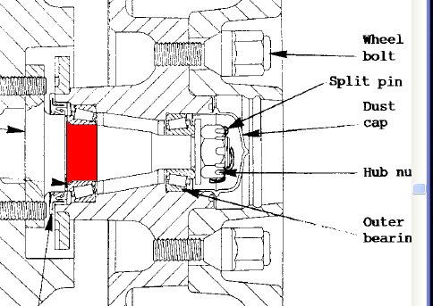

Postby RayD » Thu 04.07.2013, 19:48
It is only a slight problem Karl,
Under normal circumstances you would make sure the inner race (item 2) fits securely onto the red part of the stub shaft before assembling the bearing (items 2 and 3) and oil seal (item 1) into the hub.
The reason for doing this, is in case the bearing has spun on the shaft at sometime, reducing its diameter.
If the bearings are fitted at the factory only the oil seal would need to be removed to gain access to the loose inner race.
And in any case ... you will have the old inner race laying on the garage floor which you could try on the shaft. If the old one fits properly the new one certainly will.
Being considerably harder it is unlikely the inner surface of the bearing would wear away ... only the shaft would suffer in the event of a failure.
How tight does the inner race want to be on the stub shaft? ... you ought to be able to tap it on ... you shouldn't be able to simply slide it on ... it certainly shouldn't be possible to turn it by hand ... it ought to be the sort of tightness you would associate with it staying exactly where it is, considering the only thing trying to turn it is the greased movement of the bearing rollers, albeit with a quarter of the weight of a car on it.
The new outboard inner race will be accessible.
