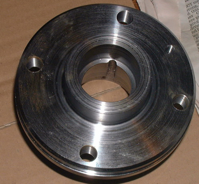

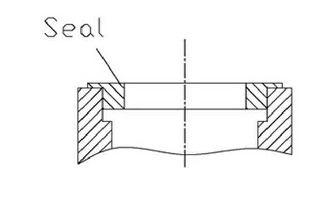

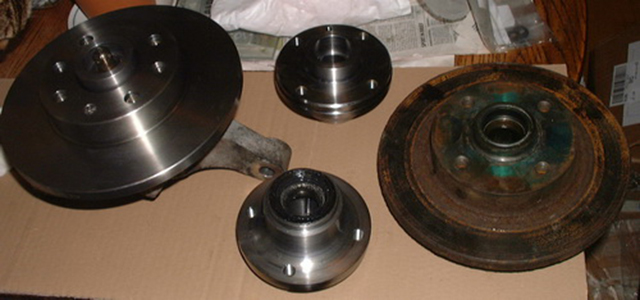

As promised here are the drawings & photos I supplied to the manufacturers. Do note these were largely unnecessary as they already had the plans before. There will be more detailed versions coming soon back from them.
I believe the hub with the curved bevel to the centre spigot are the aluminium versions. You can see the new versions compared to the old, some test pieces, and a back brake installation with the hubs and grooved discs, and a cat. I've had permission to post this and don't have credit for it all I am afraid. Lets never speak of aluminium again....

Postby Elanlover » Fri 05.07.2013, 02:06
Clearly the cat's not impressed. :poke:

Postby Jeemy » Fri 05.07.2013, 02:51
I doubt it will survive the safety testing.

Doesn't shiny new steel look good ? :wink:

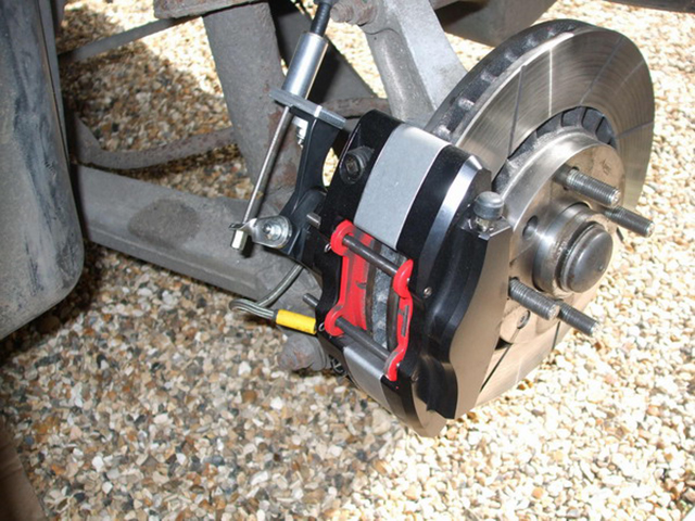

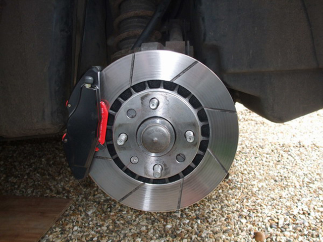

- you can fit any disc with the same PCD, thats the beauty. This also means you need to pick the right disc for your application.
- the original recommended discs are slightly too small for the PNM caliper replacement kit (as it is now) I believe
- there is obviously a slightly larger disc that will fit the PNM set - cliff is testing out 2 types but I am not 100% to post up the disc type just yet
I am working to gather together all the information for fitting with OEM, Hi-Spec, PNM and anything else people have working. But its a lot of cross-checking before I can post stuff without risk of getting rubbished which I am a lot more concerned about now. So I won't post on the thread until everything is checked and verified so I don't get any mud slung at me.
I am fitting the PNM callipers to my rears. Its a question of getting a disc to match but others are doing this as we speak and I should have a definite answer to post hear.
