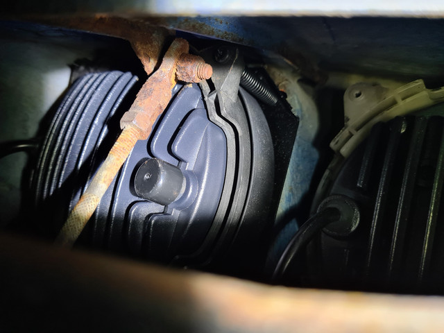

I have the first test fit of all four complete. there's only on f in Geof Smith was great help with resistor sizing.
They are bloody bright, these still need adjusting but I'm impressed.
There is a minor clash with the heatsink on the back on the headlight & the pod operating rod, I'm going to attend to this at the weekend.
As far as a group buy goes, I'm not sure it's worth it, literally a set of 4 lamp using, a resistor, a little wiring & some grinding is all that's required, they fit with all of the standard mounting hardware, one of the lights units had a keyway on the back that required a small cutout to the plasting headlight mounting ring, or you could grind the lug off, it was pretty small.
Having said all of that, if people want a "ready to go" kit of parts I'd be happy to look at something & put some funds into LEC funds whilst at it.

I have 3 headlights of that style. They were my first attempt at an LED headlight upgrade and they work quite well. I then installed a slightly uprated version which are on the car now. Both types require a load resister to be wired inline for them to work or the pods won't activate properly.
One will do for all the lights but I used two, one for each side, because I like to over-engineer everything. :-D One of the lights was installed and tested but never used on the road so they are all as new as it gets. I'm pretty sure they are marked DOT and suitable in North America - not sure about European use. I'm in Canada so shipping overseas would be more expensive than to somewhere in North America. I'm not sure what people's intentions are regarding replacing all 4 lights so if the idea is to do the dips/low beam then I have 1 and a half sets. If you want to do all 4 (that's what I did) then I have almost a complete set.

No need to burn the fibreglass and require an alternator upgrade Blair - it only needs one 100 ohm resistor.

Fortunately I mounted it to the metal bracketing at the back of the pod but I hear you. I have a bunch of resistors like this of varying size and I might very well replace it with a smaller one. Good suggestion Geoff. :clap:
