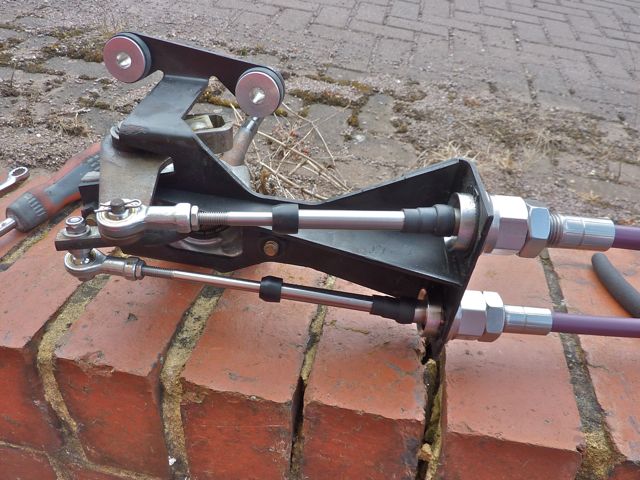

I start with the cables but that's where it ends :lol:
Nice cables
Gear change.jpg (70.46 KiB) Viewed 23181 times

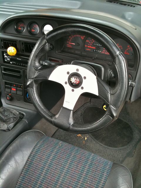

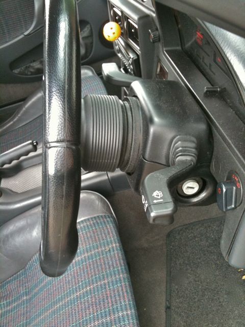

Very tactile
(59.59 KiB) Not downloaded yet
Nicely finished off at the back
(61.19 KiB) Not downloaded yet

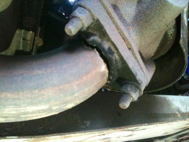

Ok so I've started to remove the Turbo to port the waste gate :bonk: , this was brought forward because my down pipe decided to part company with the catalyst housing, it sheared leaving the flange still bolted to the housing :roll:
So drawing on the experiences on here (some bad)I proceeded to remove the Turbo.
So far it's all gone quite smoothly, no sheared studs or bolts (so far).
I'm now at the point where the large catalyst housing is loose and sliding nicely along the studs, there are three remaining studs as the shortest one decided to unscrew with the nut.
I've released the power steering pump but there's not quiet enough room to slide the housing off the remaining studs,
so I'm now wondering do I need to remove the studs (which need to be replaced) first and or the coolant outlet pipe from the block that seems to be in the way too. :?
I'm also going to sort out the oil cooler pipes while the cars off the road :wink:
So this is why it sounded like a tank at St Mary's

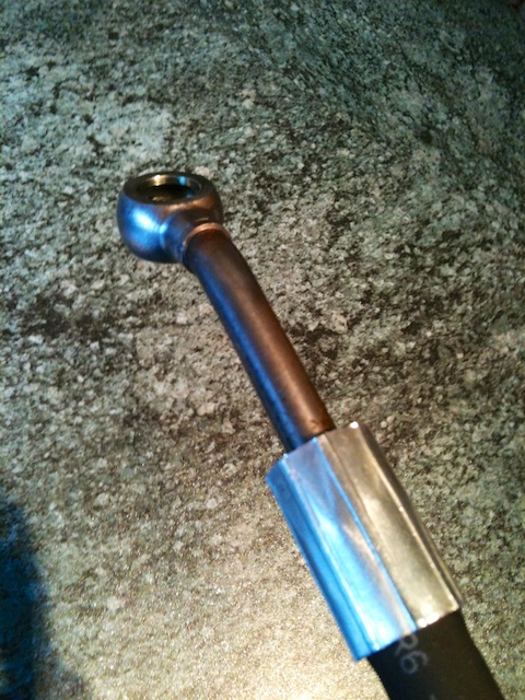

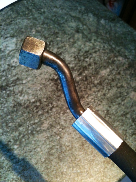

Postby Steve A » Tue 02.10.2012, 14:16
:D The waste gate has now been ported so the Turbo can be put back together.
The Piper down pipe has just arrived so that's ready to fit.
I've removed the oil cooler because there is a leak coming from somewhere not sure where yet :?
The pipes to and from the cooler don't seem to be the cause but you could turn the fittings in the hose
without too much effort so they need changing anyway :roll:
Has anyone had an oil cooler leak before? :poke:
All I need now is time :roll:

Steve A wrote:Has anyone had an oil cooler leak before? :poke:
Yes, it was several years ago, but an OEM one costs about £450 & SJ Sportscars did a £165 replacement. The SJ one needed its fittings modifying slightly IIRC.
Re: Not so Pinky III
Postby Steve A » Tue 02.10.2012, 16:15
I'd be surprised if it is the oil cooler, it's not like a rad that corrodes inside and out :?
If it's just a nick I'll probably repair it.
looking at the hoses though, the fittings are easily spinning so the hose material must be breaking down with age.
I didn't have a dripping oil leak as such, I just noticed the front lower edge of the wheel arch
liner was looking oily :shock: definitely worth checking out you guys :poke:
I'll know more when I've cleaned a cooler and filled it with a suitable liquid that will show up any leaks.
Posts: 2662

Postby Steve A » Tue 02.10.2012, 21:16
Now I've cleaned the cooler up and blasted it with an air line all the flakey paint has come away,
underneath the paint was a bit carroded though :roll:
Postby Steve A » Sat 06.10.2012, 22:34
:roll: After examining the inner arch I found oil in the inside around the route of the oil pipes
so it looks like it was the pipes after all :roll:
I've given the cooler a good clean out and it will go back on tomorrow along with the reconditioned pipes :wink:
I can't stress how important it is for people to check their cooler pipes, I was lucky I didn't heed the warnings of others
on this forum who also had the same or worse, lets face it all our cars are roughly the same age so the rubber hoses
will all start to break down as mine had and the fittings will become loose, it's an easy check so do it :poke: .
I'll very pleased with my reconditioned hoses, they used my original ends, replacing the rubber hose and compression fittings
better than the original. :-D
