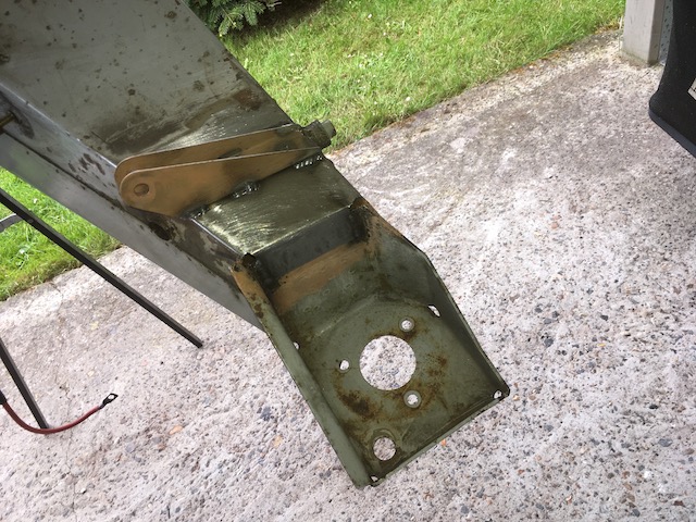

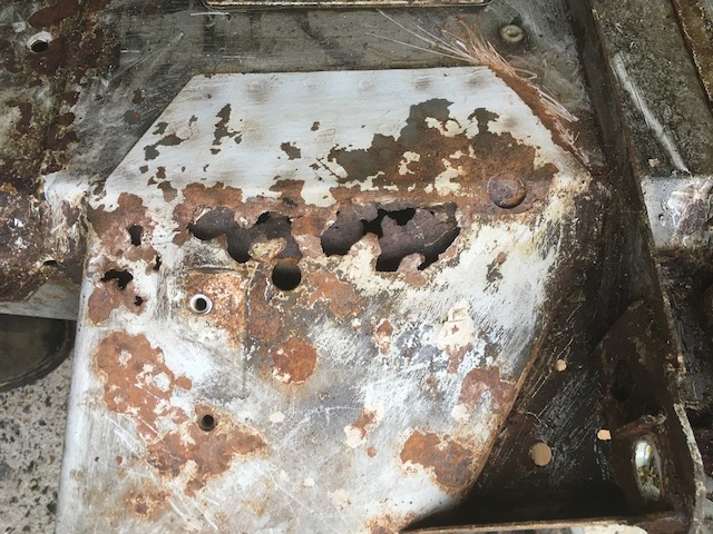

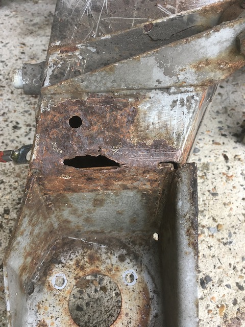

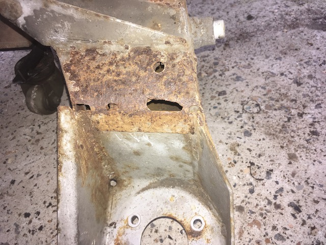

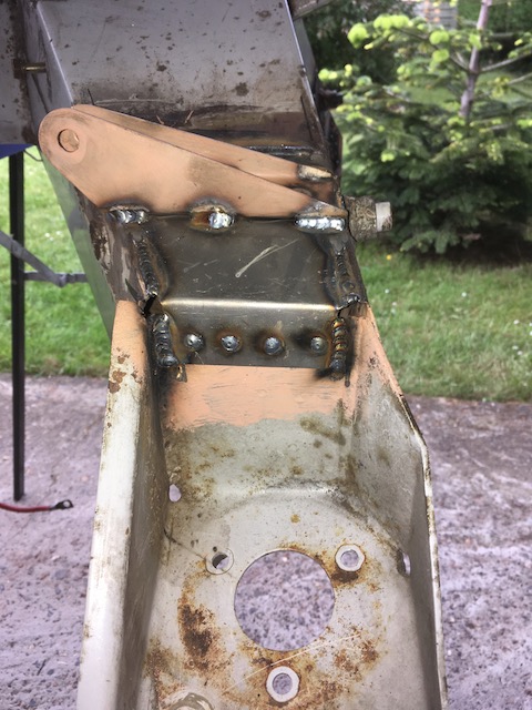

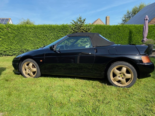

Hi all, if you remember I bought an S2 in February that had been stood in showroom for 4 years, so needed a service and some odd jobs doing,
first job was to check the outriggers for rust, took the seats and carpets out and found only a small amount of surface rust in both front corners,
sandblasted, treated and painted so to the chassis, rear end was covered in rust so began to clean it up and found this,
geoffelan
Posts: 17
Joined: Sat 22.01.2022, 09:58
Location: Bredene, Belgium
Re: From service and minor repairs to Project
Postby Rambo » Sun 19.06.2022, 20:19
The dreaded tinworm :?

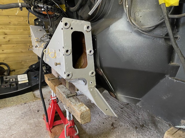

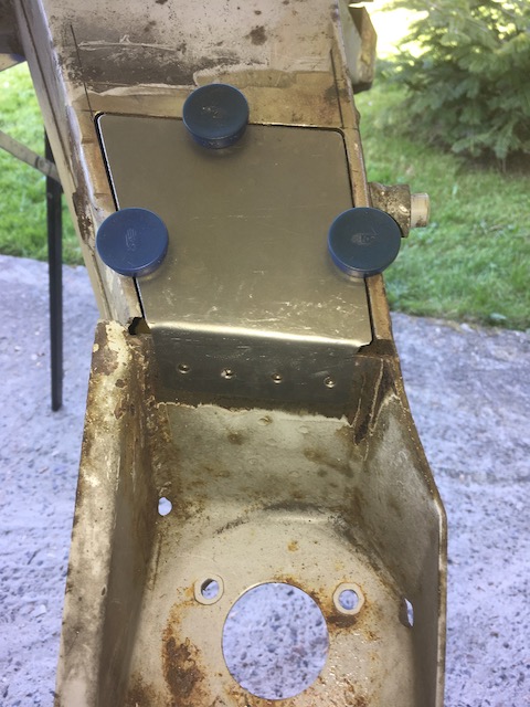

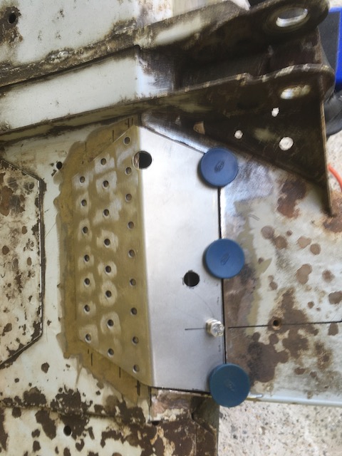

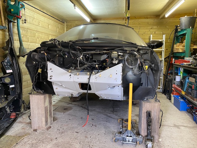

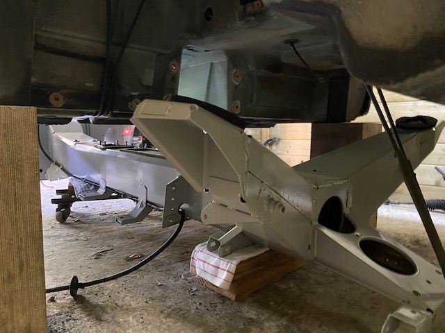

Postby geoffelan » Sun 31.07.2022, 16:27

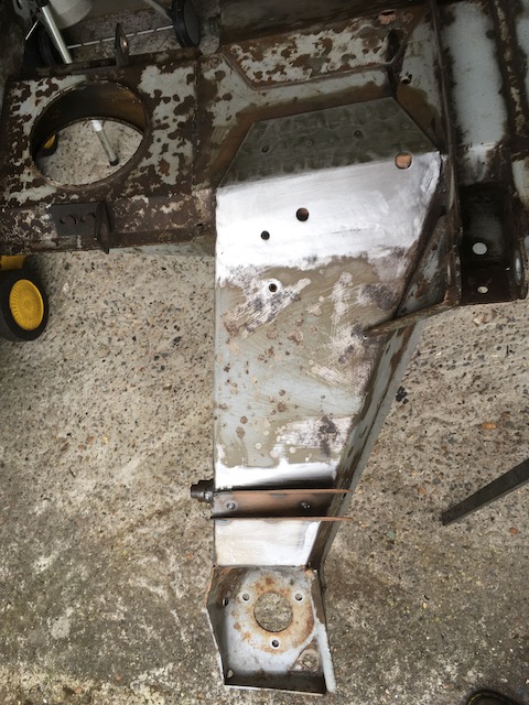

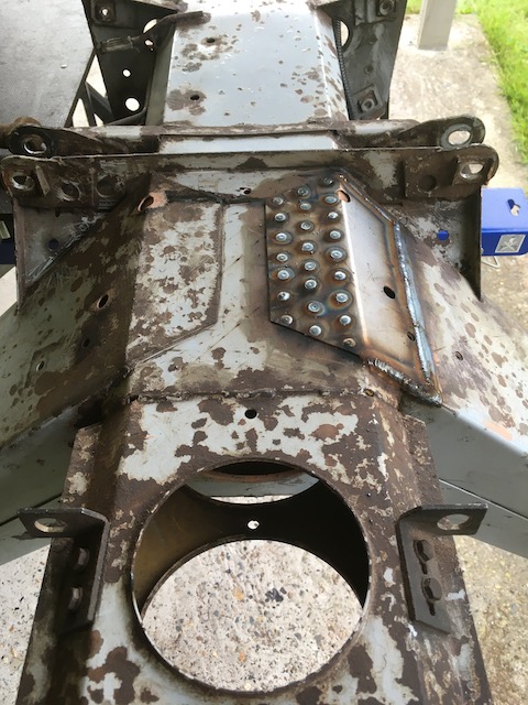

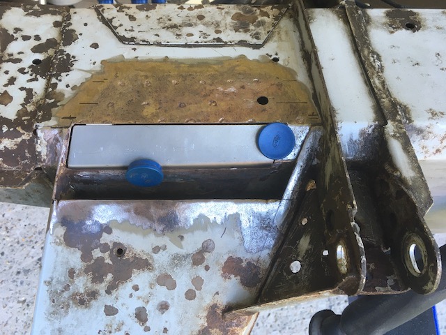

Hi all some pics of chassis repairs,
geoffelan
Posts: 17
Postby Tuga2112 » Sun 31.07.2022, 22:17
:clap:
good job.
tempts me to go that extra mile and completely separate the chassis from the body, But i think its too late for me now. and ive dealt with the outriggers in my car in a different manner.

Postby Steve A » Mon 01.08.2022, 18:18
:clap: that's some great fabrication work :clap:

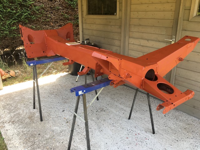

Postby geoffelan » Wed 03.08.2022, 19:40

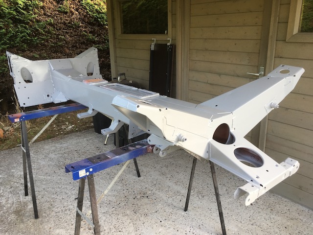

thanks Steve, more pics , welds cleaned up and chassis painted, nearly ready to fit.
Postby TorqueHorse » Thu 04.08.2022, 02:22
Wow, that is amazing. Are you painting it yourself? What is the primer coat you used? Just fantastic :)
Postby geoffelan » Sat 13.08.2022, 16:16
I sandblasted all the rusty areas and treated with brunox epoxy, the primer is Motip acrylic spray can, top coat Motip industrial coating RAL 7004 signal grey,
I did not strip all the paint off just treated rusty areas and flatted down the rest with wet and dry, so most of the original paint is intact, the spray cans are ok
for a freshen up if I had stripped the chassis completely I would have used a spray gun.
I have parts all over the place, carpets, dashboard, centre console etc. in the attic, one seat in the corner of the dining room and one in the bedroom
the rest are all around the shed, a bit pushed for space because my Elan S4 lives in the garage.
The suspension parts are all rusty, need sandblasting and painting.
Going on holiday tomorrow, hope to refit the chassis when I get back.

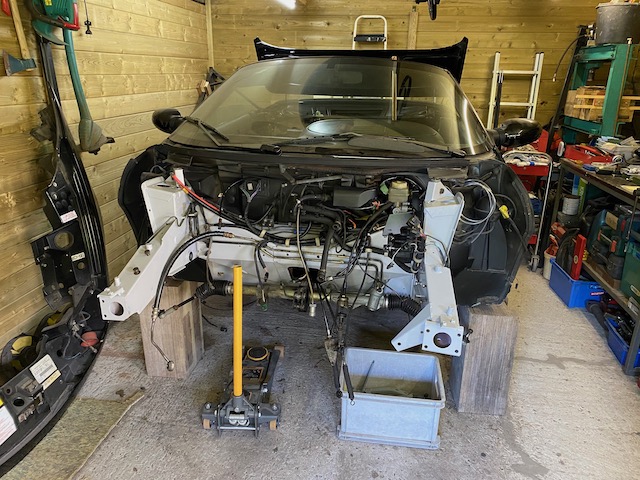

Postby geoffelan » Wed 28.09.2022, 19:26
chassis back in place

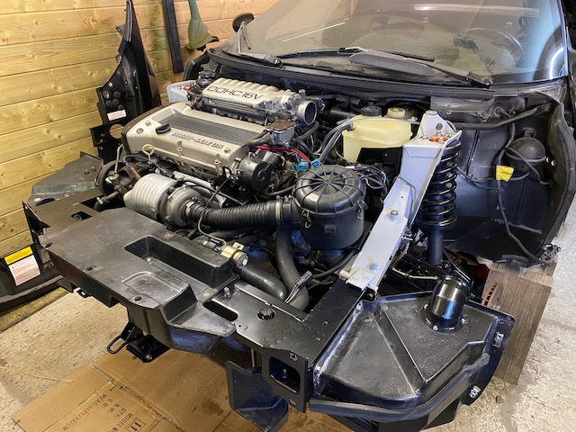

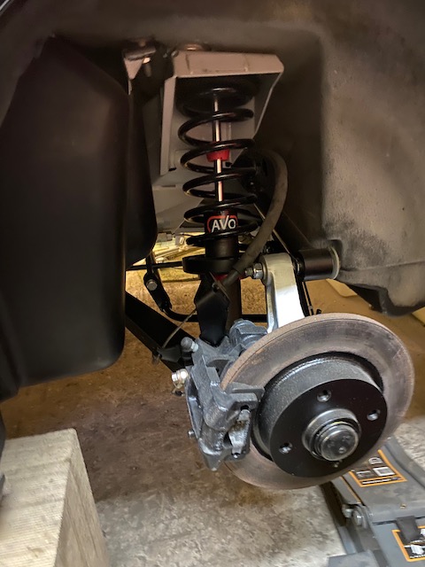

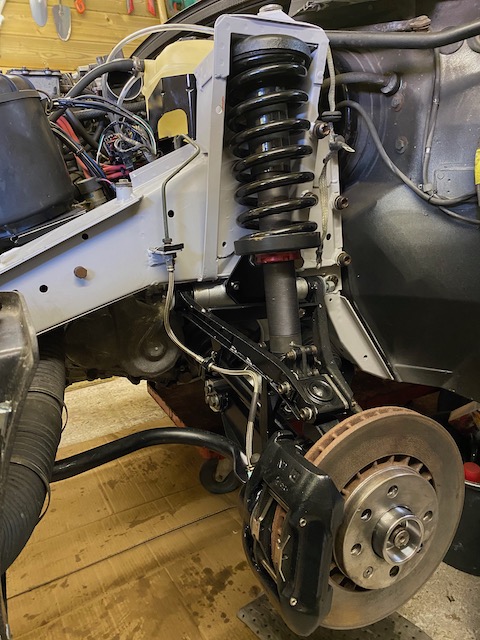

Postby geoffelan » Sat 19.11.2022, 17:50
Hi there, made a bit more progress, fitted steering rack, dashboard, fuel tank, longerones, some brake pipes, master cylinder, brake valves, new fuel filter
and steering column, pressed new wheel bearings into the hubs, sand blasted and painted suspension components,
waiting for bushes for the suspension rafts, meanwhile overhauling the brake callipers. Fuel tank needed a small repair, there was a small hole in the the front where somebody
had drilled a hole through the rear bulkhead to fix a bracket for a C.D. changer, fixed with some plastic welding rod,
also received some shiny bits
regards, Geoff

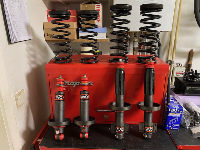

Postby geoffelan » Sat 25.11.2023, 15:05
Hi to everyone, a few more photos
geoffelan
Posts: 17
Postby Jamie N » Sat 25.11.2023, 20:24
Wow! :shock: , absolutely wonderful work there Geoff, not many folk go to those lengths to preserve their pride and joy. Highly impressed. :bowdown:
