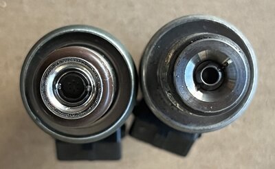

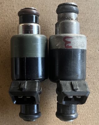

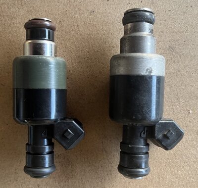

New on the left and old on the right
The replacements are 3mm shorter than the originals, however the seals are spaced correctly with only ~0.5mm difference.
The advert for the new injectors say that the new hole pattern is an upgrade. 5 holes, not 1. Well I can't vouch for any improvement coming from that, but there are definitely more holes.

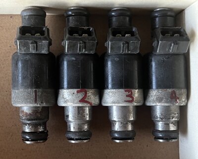

#1 was quite shabby.
