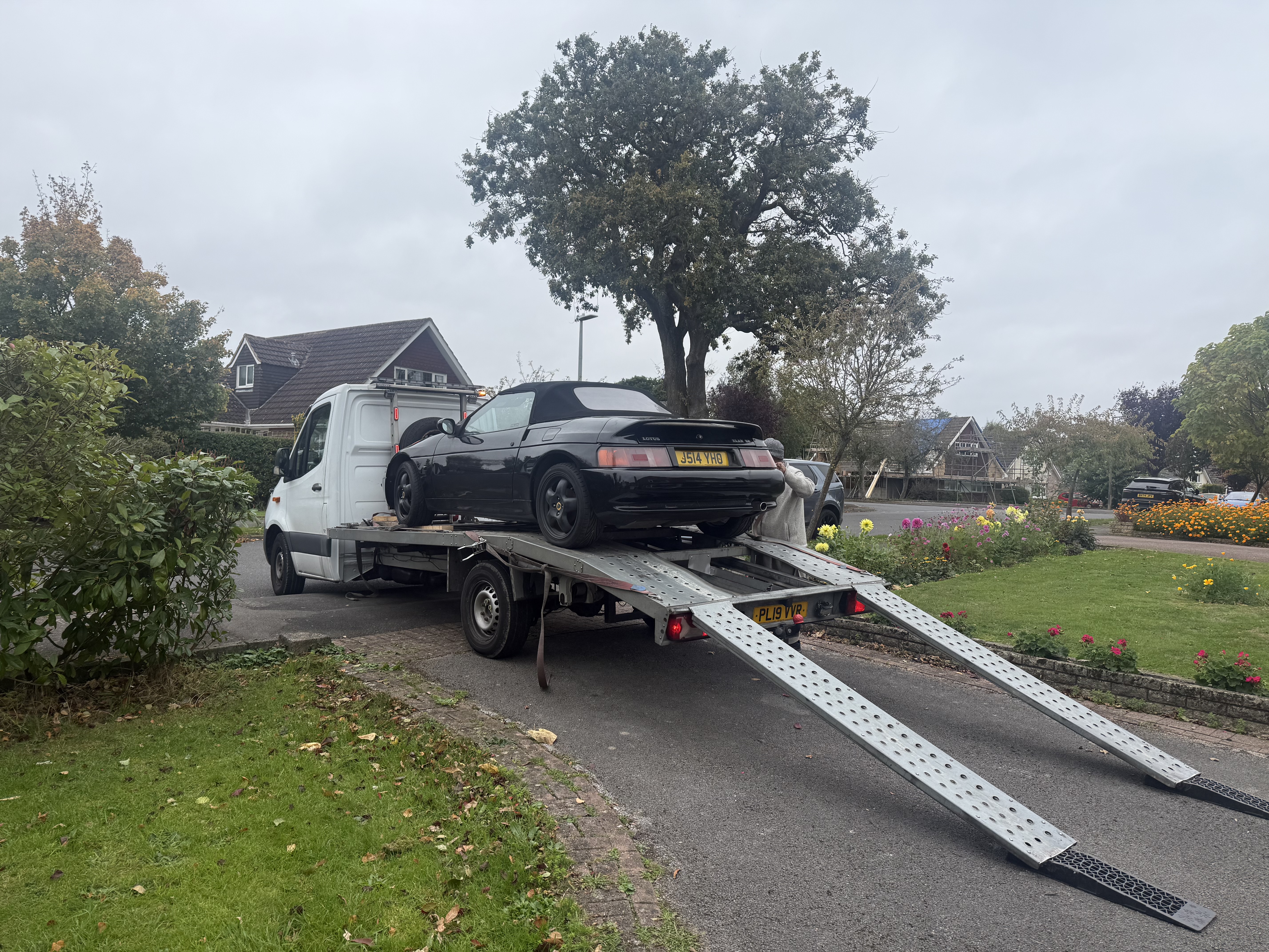

Postby maz_r » Mon 12.10.2026, 12:34
Good bye....
Off she goes to a new (old!) and dare I say better home. Wishing her and Muley happy times together
