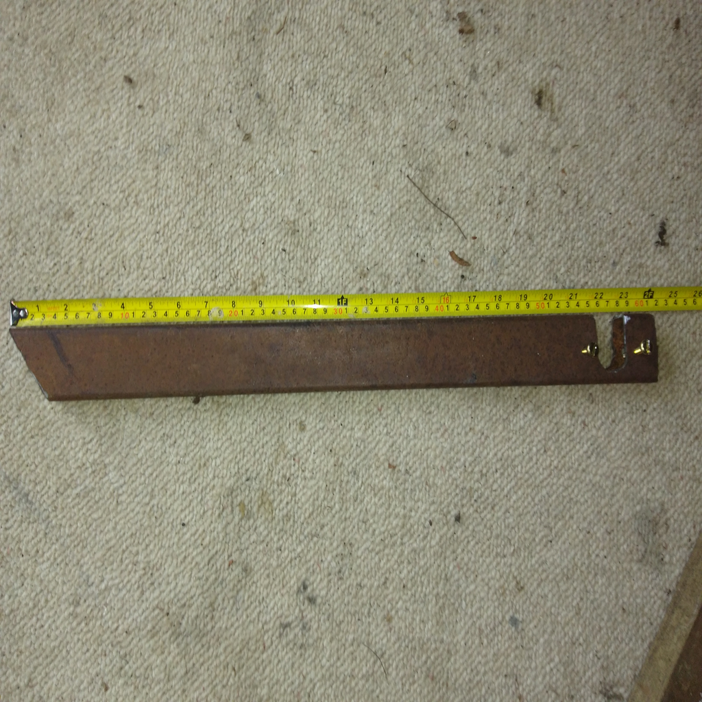

A block of wood against the roll bar, trolley jack handle on the breaker bar and three grunts is all it took.

Postby muley » Tue 31.12.2019, 17:03
....leant on the 1/2" drive bar and ping! she came undone

Postby Steve A » Wed 01.01.2020, 13:10
It is highly advisable to run a 6mm tap into the pulley holes before trying to bolt whatever restraining device to your pulley.
Just to clear whatever shite that may have collected over the years.

Steve A wrote:It is highly advisable to run a 6mm tap into the pulley holes before trying to bolt whatever restraining device to your pulley.
I always use a rethreading kit like this. Less likely to clog and ruin the thread than normal raps and dies:
