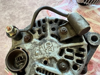

Hi
Would like to know what the component attached to the aternator is (see photo). Is it just a car radio suppressor or some type of condensor? Depending on answer, would you recommend transferring it to a new alternator or not?
Thanks David

Postby dapinky » Sun 13.10.2024, 14:25
David,
I don't know the 'official' answer, but I assumed it was a radio suppressor, so I transferred it to the new one....... it works, so it hasn't sabotaged it!

Postby M100TURBOFR » Sun 13.10.2024, 16:38
Thanks for reply. I assumed it was - memories from the 70s!

Postby Tuga2112 » Mon 14.10.2024, 11:10
just based on my rudimentary understanding of electrics. i would expect something like that to either create a permanent drain in the battery (because its connected to the positive stud and shell) or be a completely bogus snake oil adition to the setup
as neither of my cars have one, and they both operate fine. (without issues picking up old fashion radio signals) my suggestion would be to get rid of it.
or at a bare minimum check for the parasitic drain with and without it.

Postby RonR » Mon 14.10.2024, 15:48
It's a suppression capacitor so there's no drain at DC, it attenuates the voltage spikes from the alternator diodes as they switch on & off, which can play merry hell with other electronics.

Postby Tuga2112 » Mon 14.10.2024, 15:50
RonR wrote:It's a suppression capacitor so there's no drain at DC, it attenuates the voltage spikes from the alternator diodes as they switch on & off, which can play merry hell with other electronics.
is this just "belt and braces" thing in the event the regulator fails ?

Postby RonR » Mon 14.10.2024, 16:27
AFAIK the regulator is not directly in the path of the alternator output, so can't filter the diode spikes. It senses the average output voltage and varies the field winding to adjust it to the correct figure, around 14V.

Postby M100TURBOFR » Mon 14.10.2024, 16:39
Many thanks to you all for answering my query. Have transferred said component to a new alternator.
Thanks David
