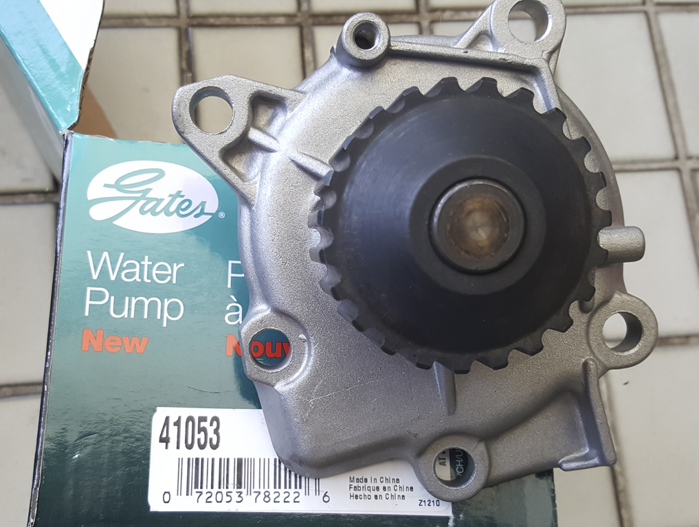

Just got round to checking the water pump that came in the Rock Auto cambelt kit ...
Mine is a Gates 41053, listed in their catalogue as Isuzu Impule 1.6 (1990-92). Made in China, with no sign of being modified.. :twisted: so may have to do it myself..
Front wall thickness is only 3.25mm so will only be removing just enough to achieve clearance ... IF I decide to fit it.
DaveIOW - have you checked the remaining wall thickness? If I removed as much as yours seems to have shown in your photo I'd have a hole or be down to 'paper thin' !
