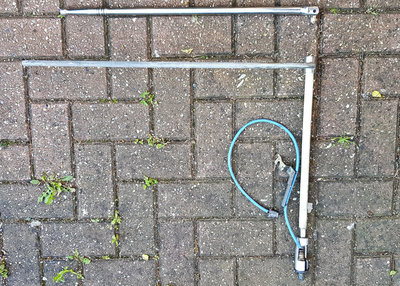

Castle Coombe I had been trying to remove it for two week....well.....today I managed it!!
I tried....
Standard size 3/8 ratchet and O2 remove tool and penetrating oil
Standard size 3/8 ratchet and O2 remove tool and three jubilee clips and penetrating oil
Standard size 3/8 ratchet and O2 remove tool and three jubilee clips and penetrating oil. Ice.
Cutting off the end of the o2 sensor and trying with a socket. This time I broke the ratchet!
Turbo torch to heat it up. Standard size 3/8 ratchet and socket, penetrating oil and a pipe around the ratchet.
Today I got this puppy, https://www.amazon.co.uk/gp/product/B01 ... UTF8&psc=1
IMG_5678 (1).jpg (14.34 KiB) Viewed 5665 times
AND HOT DAMN, 10 minutes later and another squirt of penetrating oil...
IMG_5679 (1).jpg (12.72 KiB) Viewed 5665 times
:bananasex: :cheers:
This will go down in my top 10 life time achievements :lol:....didnt think I'd say that when I started.

Re: O2 Sensor finally removed and replaced!!!
Postby HJ2 » Sun 24.06.2018, 13:56
Good Job!
Next: try the crankshaft pulley nut :wink:
