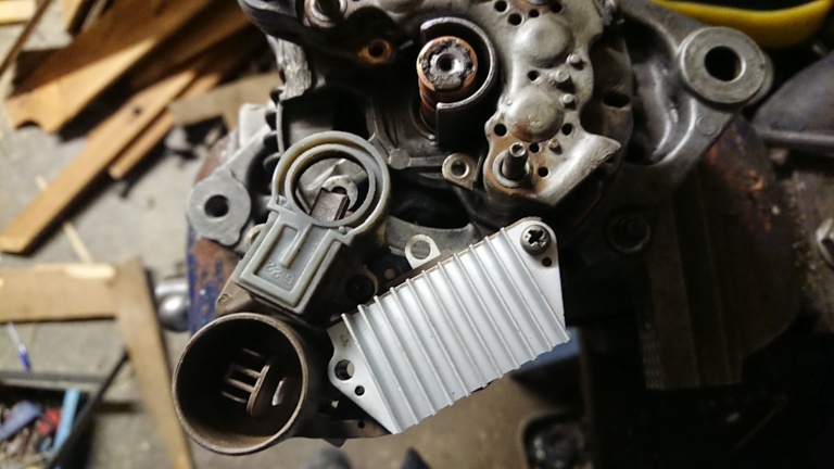

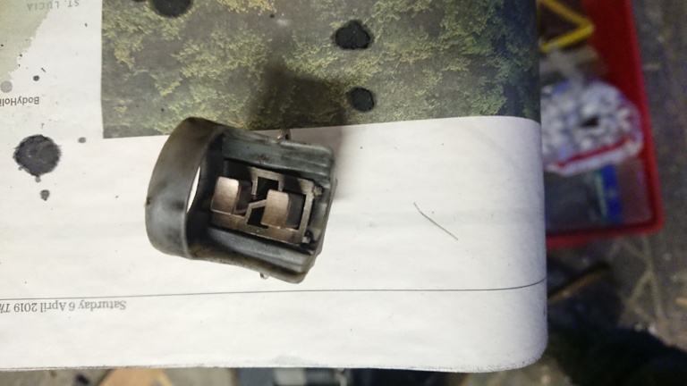

The rubber cover for the brush box might need a nick out of it to fit the new brush box snugly. I didn't bother and a very slight difference between the old and new brushbox makes it sit slightly proud at the base.
For ease of assembly, attach the brushbox to the VR with 1 screw. Put a long screw into the end of the VR and screw it onto the alternator just a couple of turns. Now swing the VR into position and drop the other long screw in.
VR and Brushbox easy assembly
