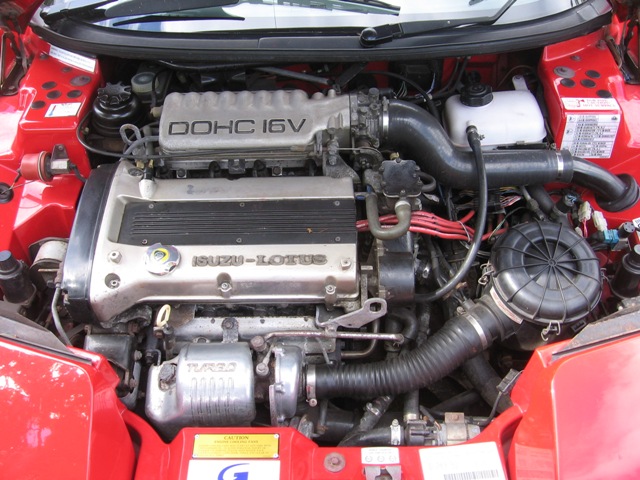

Ailwyn - I'm sure there was a thread a few months ago called "show us your engine bay" - or words to that effect. It may have what you are looking for ?? In the meantime here's an old shot of mine but I guess it is too far forward and you want one from the rear - so to speak !

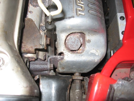

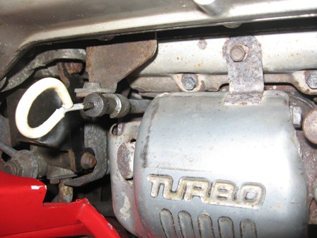

That pic is spot on... just couldn't remember where the bracket should go, once that's in the rest of the routing is fine.

I did find the torch and took a few close-up pics just in case.............

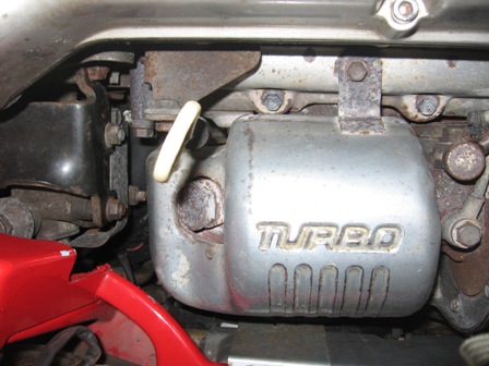

Postby Doug » Wed 20.08.2008, 05:04
I found the picture I took of the dipstick routing in 2005 at Donington:
