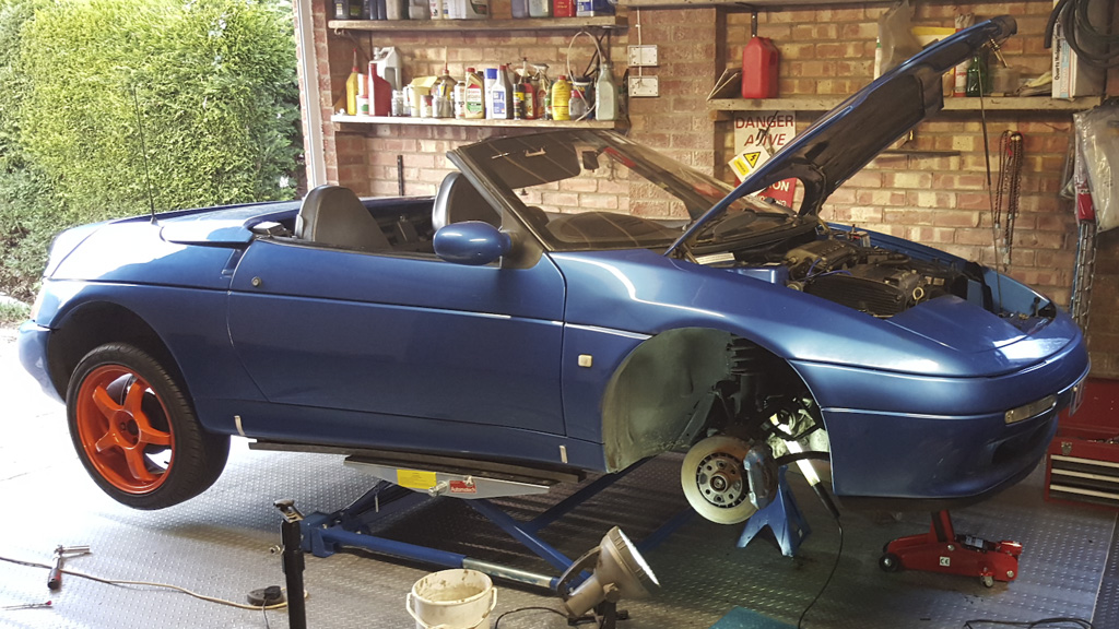

I had mine up on a scissor lift and had removed the power steering reservoir - thought I'd take the opportunity to replace a large proportion of the fluid. Makes it a convenient height to go in the top without backache and get underneath without of a struggle. With the reservoir out of the way, I don't remember the adjustments bolts were particularly tricky.

Thought maybe an update on this thread with a few comments on my experiences of replacing the alternator might help those about to start -
First, it generates 'project creep' - it's much easier to remove the oil filter for access to the alternator from below (the Manual says so too) so an oil & filter change are obvious things to do. From the top the Power Steering reservoir needs to be unbolted and pipe clips released for it to be pushed out the way, but why not remove it and lower the pipes and get probably more than 50% of the fluid out the system. I've seen something in the Manual (HC2 Page 5) that warns air in the system can damage the pump and a procedure for cranking the engine with the inertia trip switched when it's been drained thoroughly as part of a fluid change. So my thinking is change 50% twice as often and avoid having to prime the pump. Vauxhall dealer told me GM Dexron VI is the current evolution of the PS fluid quoted in the Manual that is suitable for the Elan. Bought my Elan a few miles from Kelvedon Motors so it went straight there for cambelt, PS belt, alternator belt and a big service a couple of years ago so after inspecting the alternator belt it went back on as it was still perfect, but otherwise it's a good opportunity to fit a new alternator belt. ( I use a Burroughs gauge to tension my belt but it should be tight enough to not slip but not so tight to wear the alternator bearings. Should get about 1/2" of deflection on the length to the crank pulley and slipping produces a squeal just after starting when it's trying to put full charge back into the battery.)
The alternator is not too challenging to unbolt if you have a decent range of tools but feeding it out alongside the O/S driveshaft is like doing a Rubik's cube. I bought my replacement before I started so as soon as I got the old one out I started feeding the new one in but still got the sequence of twisting and turning wrong. It's a very tight fit so I wouldn't try that route with a higher output alternator as it may well be a millimetre or two wider that proves critical. So it's not necessary to remove the prongeron but that remains an option some people use. (There's a thread on here by a U.S. owner who fitted a higher output alternator on the engine before installation and then was having trouble removing it with engine in situ. Think he was going to try removing prongeron but haven't seen an update).

Sorted. 1/2 time in Wales vs Japan. Used a mirror (from an Xmas cracker) to check alternator was lined up, wedged set screw into long 12mm ratchet spanner held in place with long screw driver and screwed (gentle) away.
