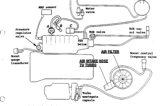

Yes this is the EGR valve and should stay connected, the EGR opens during closed or small throttle openings when the cylinders require extra air to overcome the vacuum of the engine. The EGR also helps with emissions and fuel economy.

EGR is Exhaust Gas Recirculation.
At certain engine conditions it introduces exhaust gas into the induction system to reduce pumping losses, lower the combustion temperature and control emissions. The valve is operated by vacuum and controlled by the ECU using a solenoid valve. Check the vacuum pipe connections (they look ok)
The wire is for a temperature sensor (I have only seen it on S2s) and it isn't used so there is nothing to plug it into.

sinannasirli wrote:But this wire is definitely coming out of egr valve and has a connector.
Yes, and it is definitely an EGR temperature sensor, and the EGR valve is definately Vacuum operated.
sinannasirli wrote:Will plug it and then compare.
That'll be interesting! where exactly will you plug it in and what are you expecting to happen? Let us know how you get on!
The point of the EGR on the elan is to cool the charge to prevent formation of NOx so you probably aren't going to notice if it is working or not. you can check its operation by sucking on the vacuum pipe.

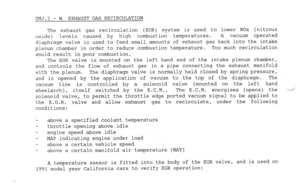

Well I was looking for something else and came across the closed loop manual.
Which explains why all of the ones I've ever seen have been unplugged and why it doesn't do anything... Unless you have a Californian car?

It means that the EGR temp sensor is not supposed to be plugged in and you have connected it to the CAT overheat sensor wiring.

Will you believe me if I say that the Catalyst temperature warning light (Japanese market only!) is to indicate high catalyst temperature as required buy law in Japan. The Japanese require this as a hot catalyst may set fire to the grass under the car when parked if the catalyst is too hot. They leave the engine running and when the catalyst has cooled to a safe temperature the light goes out.
The warning light has absolutely nothing to do with the EGR valve. As above if you did actually have it plugged in correctly (California only) and the egr valve wasn't working, it would light the CEL which is the one with the picture of an engine.
sinannasirli wrote:(THe engine really fells hotter than it should be , so I suspect that my EGR is not working properly as it should decrease the combustion chamber temperature, I don't think this is only a sensor error, would you agree?).
No I completely disagree - The EGR valve has nothing to do with engine temperature. It is job to control emissions, if it doesn't work you produce more pollution.

Postby GeoffSmith » Sat 27.08.2016, 08:57
Unless you install the Californian Elan PROM, it ain't got a hope in hell of working.
