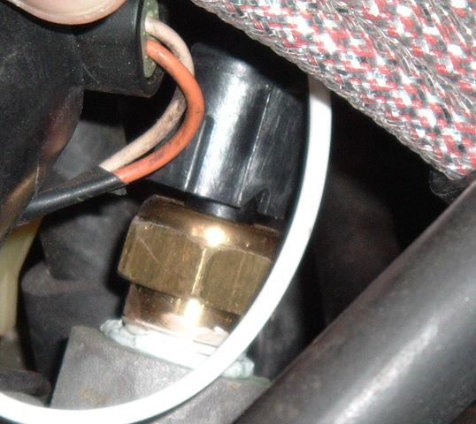

Postby nitroman » Mon 23.07.2007, 22:30
KmcKmc, I've got the 195° / 185° Fan Switch in now. See post here... http://lotuselancentral.com/forum/viewtopic.php?t=6707&start=100 Will try the other by this weekend when I acquire a 21mm-deep socket, as installing by wrench is a drag.
nitroman
Posts: 3554
Joined: Fri 18.04.2003, 01:17
Location: Jacksonville, FL
Postby nitroman » Fri 27.07.2007, 21:08
Final report sirs (also Lords, Earls, Knights, Duchesess, Dukes, and Squires):
The 210° / 200° Fan Switch turns the fans on at just a tad over the 1/2 mark, then cools to exactly between 1/2 & 1/4. I'd say this would be the one to use as the duration the fans are running to acheive this result is MUCH shorter than the cooling period of the 195° / 185° Fan Switch; which must labor very hard to get temps well below 1/4. It all makes sense as a hotter object is more thermally able to shed heat to a gas many degrees colder. Just physics lads.
I'd say this thermal-switch will also extend the life of the electric fans as well, being that the fans won't be on near as much. Anywho, it's the one I'm sticking with.
Going to the 3/4 mark always made me uneasy, but I can live with a tweek over half.
