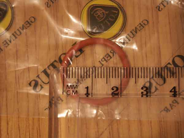

Don't suppose you know the dia of the o-ring, so I can try to get one in stock before I take it apart rather than running around afterwards trying to get a match ? :?

Postby lotuska » Mon 16.04.2007, 20:24
Here goes, a picture for you...
Oh and the Lotus Part number is A100E6339S
Lotus Original o-ring

Postby GeoffSmith » Mon 16.04.2007, 21:09
lotuska wrote:Oh and the Lotus Part number is A100E6339S
Yours looks like 19.8mm ID and 2.4mm thick - how much did you pay for the Lotus plastic bag Mark?

Postby lotuska » Mon 16.04.2007, 22:19
Geoff a bargin for a Lotus original part...£98p...can't think I've ever paid that little for an original part before from a dealer, maybe there's competition here, "What's the cheapest Lotus original part you've bought?"
Ah, but it is a lovely shade of brown and not the horrible black ones!!
