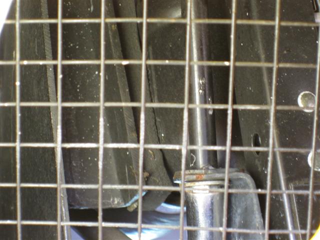

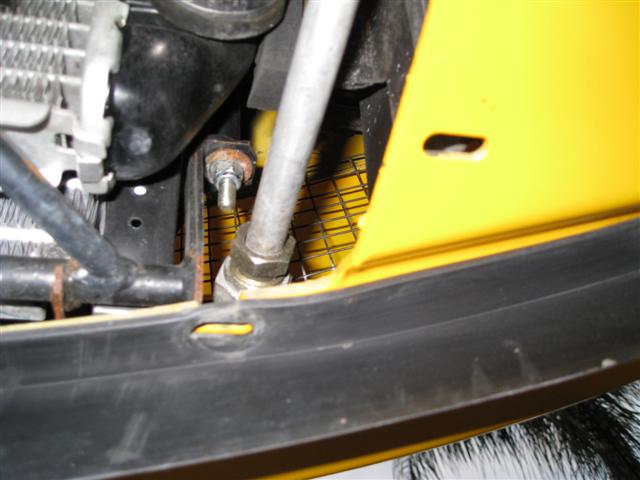

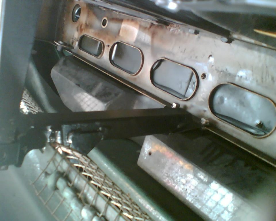

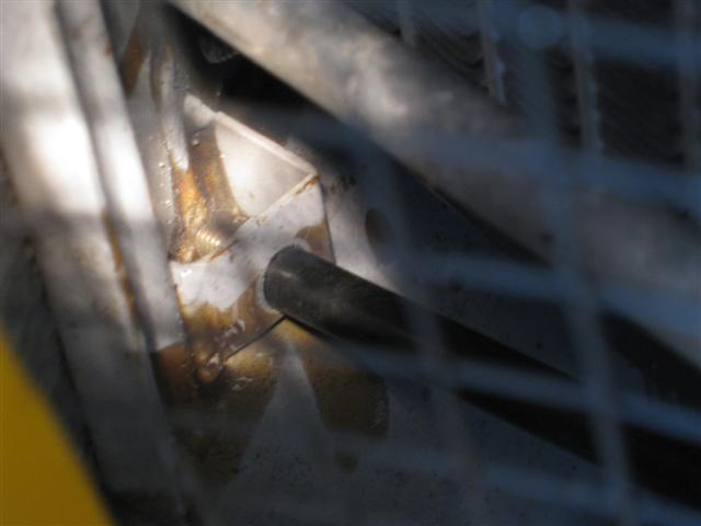

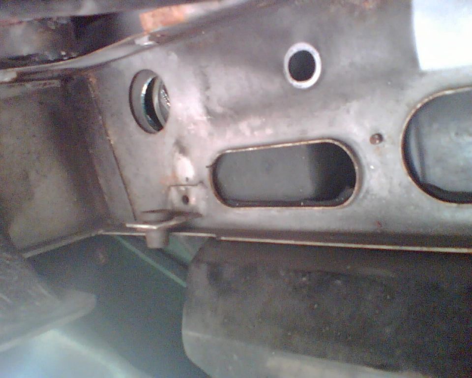

All that is informative but I've got the USA version. All I want to do is put in a new radiator-support-frame I had powdercoated. The old one looks like someone beat it with a hammer! You can see the basic difference between the two in section KD of the repair manual. Non-USA is shown on page 9 & USA on page 10. Here's the problem: I can't get the two nuts off without also backing out the threaded-shaft inside the spacer-tube. That's bad because the nut on the top of the threaded-shaft is not captive. If I remove the shaft I'll never be able to mate it again to the "loose nut" on top. As you may know, a loose nut is something best avoided; so I've heard.
I have two possible thoughts and look forward to what you might have to say.
1) If I remove 'everything' I might be able to displace the A/C condenser enough to glue the top nuts to the frame. To me this stands the best chance. Still though, I can't remember disassembling other components with only a hunch in hand.
2) If I have enough room to get my drill's flexible extension shaft into the narrow space I could cut a 'trough' into the bottom of the threaded-shaft such that I could insert a screwdriver to keep it from rotating whilst I back the bottom nut off. I am almost certain there is not enough room though.
Here are some pictures to keep you from fantasizing.

I have one other half-ass idea: Cut off enough of the chicken-wire-mesh on either end to be able to reach in and palpate the top nut.
