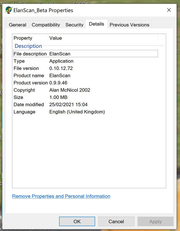

Postby MPx » Fri 14.07.2023, 21:34
My Dell XPS laptop is windows 10 and I have still been doing the odd ES capture successfully. I say successfully, but not successful enough to diagnose the misfire, but able to capture the data as normal. As windows is on auto update, I can't be sure of the exact version last time I was successful. Its currently telling me its Windows 10 home version 22H2. The ES version is actually called Elanscan_beta and I cant remember where I downloaded it from when I got this laptop a few years back the details are here
Not sure where to look for driver versions but happy to do so if pointed in the right direction

Re: elan scan drivers
Postby chrism » Fri 14.07.2023, 23:48
Thanks MPx, Yes I've seen this beta copy somewhere, I'll try to find it again and try it out.
In view of the difficulty of loading ES directly into win 10/11 is iy possible that you might have originally loaded it into win7 which subsequently upgraded itself to win10? Can you confirm please? Plus, did you separately load any FDTI files?
I wonder if anybody on this forum loaded ES directly into win10/11 and got the ALDL to 'start talking' or logged any data? I know that mine reads previously logged ecu files - that's why I thought it way okay - but currently won't do the talking stuff with a new file.
I seem to remember that there was a change in the win10 architecture which meant that once upgraded to win7 you couldn't revert back. I wonder if this is the cause of our woes? Trouble is, I've tried downloading a copy of win7 and it doesn't complete due to 'time-out' of M/soft support with upgrades, so I can't try out an ES load on it to see if it's the problem.
I'm getting the feeling that all the working ES originated in win7 and were converted upwards to win10/11...

Postby MPx » Sat 15.07.2023, 08:44
I'm sure I loaded this ES version from a link somewhere on this (LEC) site - may have been Alan's MC bit - took me a while to find and wasn't the one I've seen referred to most recently? The installation was definitely not from Windows 7 and I've had ES (poss other versions) on previous laptops and the last of those was W8. I don't remember loading any separate drivers, but can't be sure I'm afraid. I do remember it took me a while to make it work as it used a different comm port to previous. So for me at least a successful load directly into W10.
