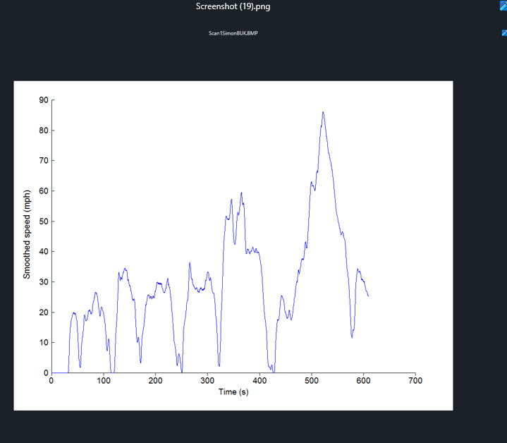

From a quick look I noticed that I have had maximum boost but rarely had over 100 bhp ? Only once I think - seems odd ?

Your zipped file came through as this and I'm not sure what it can tell us, especially about bhp and boost...

Yes ignore that graph - it doesn't relate to what I was saying !

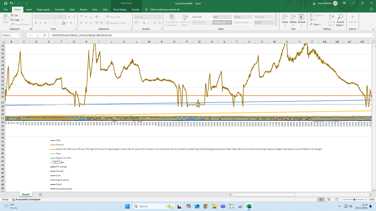

Looks like I'll have to do it all over again unless people like looking at Excel spreadsheets !

I don't use excel much at all so I don't know much about it but I unzipped your 2nd scan - the excel one - and pushed a graph-drawing button :o .
I think it's drawn some sort of graph of everything but the axes and scales don't make a lot of sense, if any, and I couldn't see an obvious way of seperating the elements. I'd imagine there's a way of drawing graph lines seperately for chosen columns but I can't imagine excel to be as 'clevva' as EScan by sorting out axes and scales in order to make the data mean anything more sensible. :?
Just a couple of thoughts:-
1. Why not do a (say) 5min tickover EScan data grab that might outline anything basic before giving it beans to check bhp or boost etc. That way the 'horse' could be inspected for injury before it bolts out of the stable and gallops off down the road?
2. Your excel data shows you're on promid 1499, your air:fuel ratio is constantly spot-on at 14.7:1 your boost peaked at just about 0.6 at 86mph (line 2008) - so a standard ecu map? Horsepower readings made no sense on line 2008. I couldn't see an O2 sensor voltage, so I wonder if you're using Ron's excellent EScan_beta update and new protocol?
3. ps it looks like your highest revs were ~4200 at your highest speed...again line 2008 on the excel spreadsheet

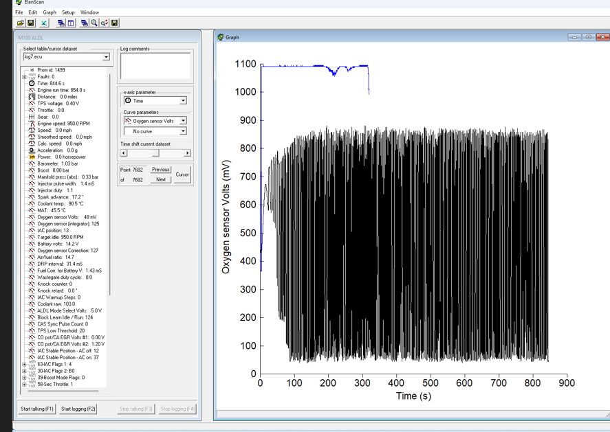

Yep, that's much better :D
I've attached a recent .zip scan of mine. I'm no EScan expert but if you overlay my data on your graphs I think you'll get more of a 'feel for the normality' of your m100.
Lots of bits co-incide but in particular if you compare O2 sensor volts with mine (yours are blue mine's are black) they're VERY different - yet your air:fuel ratio is fine - so I'm a bit confused.
My first thoughts are a 'duff' O2 sensor, or perhaps a different version of Escan + its protocol, so let's hope an EScan guru might be able to provide more insight.

Postby simonbuk » Thu 07.11.2024, 14:32
@ChrisM - think you might be onto something !
Checked the O2 sensor and had no reading when checked with an ammeter, checked the one in my other car and had a reading of .35 (or maybe 3.5 ?! can't remember :lol: ).
But the one in my new car seems dead. I'll swap them over when i've found a tool big enough ...........
As you say though, odd that the air/fuel ratio seems corrct :?: .
