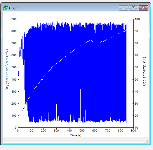

What I could have done was to graft some more wiring onto it - like yours seems to have done - but heigh-ho we live and learn. There's a thread on LEC somewhere where I made a point of listing a couple of O2 sensors that had the correct lead length. From the top of my head the Denso, Walker and Bosch 15701 'qualify'...
Regarding your EScan, instantaneous results a moment after start up won't really give much info (especially with O2 sensors).
With respect, I think you need to zip and send a (say) 5min warm-up log or a run around the block, for example. I think I'd be looking to see if your O2 sensor 'warms up' and varies with time between ~0.1V and ~0.8V which you'd get from a graph like this:-

Looks like you're using the old 'M100 ALDL protocol.ini' file, which gives a misleading (wrong!) voltage for the Oxygen Sensor. I've played with your figure above to get the real voltage of 484mV, which is in the right ball-park for an O2 sensor just after staring up. If you want to see the correct figure in your scans, please follow the instructions HERE.
As said above, a scan of the first few minutes of warm-up should give you the info on whether the sensor's OK.
EDIT: To get the correct voltage take your 2.1568 above and multiply by 224.4, which gives you the actual voltage of 484 in mV.
