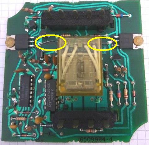

Why are the circled connections different? Did one overheat and stretch or what?
www.lotusm100.com/Module1.jpg
I would suggest looking at all the connections associated with the curved connector. Look at the relay closely to see if the contacts are burned for that connection.

BTW, I downloaded all of the pictures and then brightened them up and increased the contrast followed by resizing them as big as I could so I could actually see. Too bad we can't see the circuit board where the curved connection attaches under or behind the relay.

John's warning about powering the motor directly from a battery supply is correct - the primary function of the module is to cut the power when the current increases as the motor stalls. As long as you are very quick however, you should be able to prove that the motor is driving the headlight up and down (I'd start from halfway up so you don't damage the gears if you get the direction wrong) but first off I would put a voltmeter across the motor connections to see if power is being sourced from the module. If not it's probably worth twatting† the relay.
I think the kinked wire is mechanical though. This is what happens when the module burns out:
From what I found out a few years ago, they are susceptible to damage - probably voltage spikes from bad +12V and 0V connections. Seeing as they use 4000 series logic (which is notoriously prone to damage to transient of little more than 18V and there appears to be no transient protection on the module supply inputs) I am not surprised.

GeoffSmith wrote:16511949 is probably a GM part number and therefore a custom device that you are unlikely to find anywhere other than in a GM headlight module. Date code appears to be 8931 so manufactured in 1989.
the only other reference i found of this IC was on the corvette forum https://www.corvetteforum.com/forums/c5 ... d-why.html where they suggested the same
upon close inspection i found a cracked solder joint. which was rectified but proved to not be the culprit of the failure.
GeoffSmith wrote:PS if anyone wants to lend me a left hooker for the Winter, I can probably take a look. :-D
not sure if your asking for a bribe, or a spare unit... (blame it on the language barrier)
Posts: 3089
Re: RH pod not working
Postby GeoffSmith » Tue 09.10.2018, 22:51
Tuga2112 wrote:
GeoffSmith wrote:Correct - the 4001 is a quad 2 input NOR.
you probably quoted me before i edited my post. (and possibly made it wrong?)
the IC i found when googling for the data printed was a quad 2 input NAND (which according to my further googling is a 4011)
i need to do some further googling to learn how to test the IC, i have a suspicion of a process that could work, but given the fragility of the parts i will be googling further on the topic before doing anything else.
You can see that it is a 4001 in the photos above and is a quad NOR (both inputs low for a high output, otherwise low output). The 4011 is not fitted and is a quad NAND (both inputs high for a low output, otherwise high output). They are/were standard logic building blocks. In the loft I have an 8 bit 8085 micro with video card of my own design/build which uses a lot of similar devices.
Yup… but FastOne is talking bollocks if he thinks that a bit of heatsink will save his MOSFETs. If you've got bad solder joints then it would be worth checking all of them with a magnifying glass.
Left hooker = LHD.
