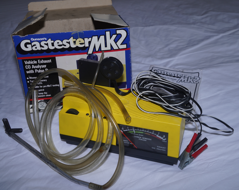

Postby chrism » Thu 13.06.2024, 19:12
Imageupload image to internet
rob/d I've got one. (I've also got RonR's dual 1499 chip + an O2 sensor - which I'd thoroughly recommend cos it means MoT emission time is totally stress-free :D)
If nobody near you comes forward with one I don't mind lending and posting - in the tue tradition of LEC - as long as you're happy to cover the costs?

Postby rob/d » Fri 02.08.2024, 11:36
Been a while !
So i bought this....
replaced this...
Added Redex .
Adjusted timing , , went at the pot for CO ............and Crap !
CO off the charts , 6 % +.
Start changing sensors ?
The A100E6283F air temp sensor seems to test OK , but i cant find out what the resistance is supposed to be for a good one .
Disconnecting it however makes no difference to the engine , strange .
The coolant sensor again , tests OK .
Funny little misfire on idle , only slight , could be the massive over fueling though .
Any clues people ?
