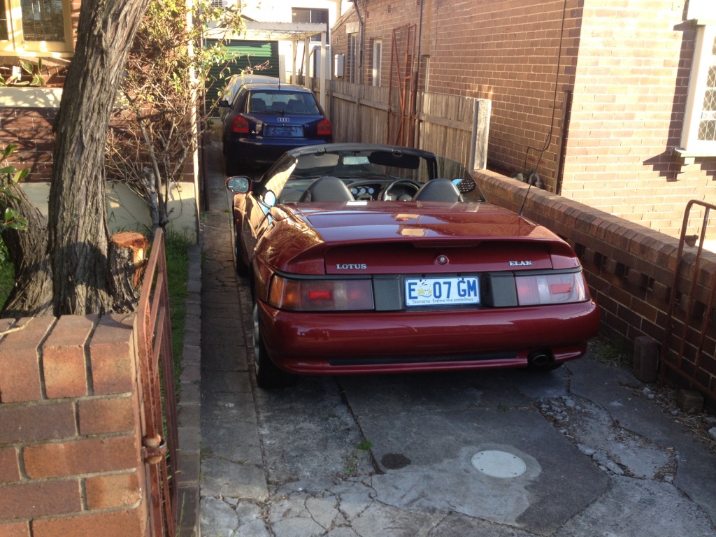

Hello to all on this excellent forum. My friend Tony and I have just jointly purchased Elan S2 Limited Edition number 438. While we're no strangers to the Lotus Marque (between us we now own six), this is our first foray into front wheel drive.
The car we've purchased was part of a deceased estate, and there were no logbooks, handbooks or any other information, just one key (which we've now have copies of, only took five locksmiths before we found one that had the right blanks!). Today we got it registered, and we look forward to driving it, it's in beautiful, tight condition, cosmetically and mechanically excellent, having covered only 118000 km. A shower cap is on order!
I have searched extensively on this forum, and it has answered many of my preliminary questions. However I would really appreciate any insights into the following:
1. If anyone in Australia knows anything about this particular car, we'd really like to know more about it, its history and even previous owners. We, the new owners, are Sydney based but the car was purchased in Launceston Tasmania.
2. The only mechanical glitch is worn synchro when changing from 2 to 3 and from 3 to 4. Not uncommon, I gather. Can any downunder owners point me to someone (preferably Sydney, but not essential), who can rebuild the gearbox? I'll tackle most mechanical jobs, but gearboxes have always left me befuddled.
3. The sump has been damaged by contact presumably with speedhumps. It doesn't leak and eventually I will take it off and fettle it back into shape. Alternatively, was there any Australian model of Isuzu or Holden (or other brand) that shares the same drive train or sump?
4. As mentioned, we didn't get any remote keys or senders.....but the car does appear to have the infrastructure in place (CDL unit, door actuators) for the alarm / central locking to work. That said, the door lock buttons aren't "talking" to each other at present. All fuses have been checked.....has anyone had any experience getting a system to work from this starting point? Any advice welcomed. Otherwise we'll just install aftermarket immobiliser and remote locking.
There will be many other questions I'm sure, as we get to know this lovely car. But any assistance would be appreciated.

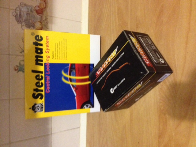

Thanks for warm welcome and responses. The good news is that even down here in upside down land where we can't play cricket, m100 Service parts seem to be readily available so far. So nice to own a lotus that's actually listed in the spare parts catalogues! Today was spent trying to work out why the door locks won't communicate. Quickly apparent when drivers side air duct removed that all three plugs had been removed from CDL CPU. Alas plugging them in made no difference. So stripped the door and only thing I could find amiss was one plug hanging off with no obvious socket to plug it into (see pic, any clues?)
Anyway rather that get this overly complex original system working again (what were they thinking?) I've decided to fit an aftermarket immobiliser /keyless entry system. Part of the reason for stripping the door was to see whether there is room to piggy back an actuator onto the existing locking rod....and there is! Tomorrow's job.

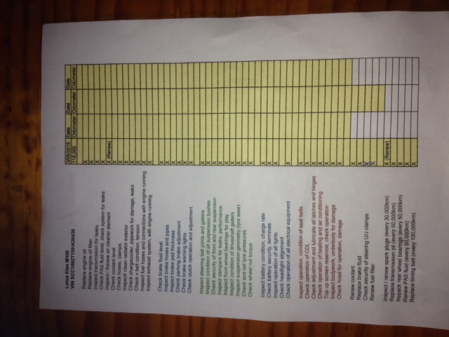

Quick update: Élan S2 438 has now been given a full service as per lotus service notes. Took a few days but I wanted to tick every single box. The good news is that replacing the transmission oil has completely fixed the slow synchromesh shift into 3 and 4, and the shift is now a delight. Aftermarket immobiliser and keyless entry installed....we're ready for a year's trouble free motoring!
