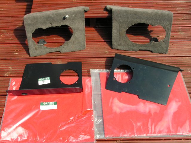

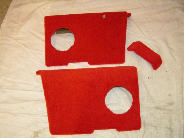

Postby jimbob » Thu 24.05.2007, 18:23
Got the front structure built up yesterday, and to my amazment everything fitted unlike the old chassis etc Anyway as usual everything is held up waiting for parts but Im sure I can find something else to do on my next days off.
Enclosed pic of new speaker boxes and carpet to cover them, the boxes came from lotus untrimmed, one of which is now n.l.a. as did the red carpets.
Funny thing, everyone else is cutting out their speaker boxes of modifying them in some way, and I just want them as they left the factory.

Postby jimbob » Tue 29.05.2007, 02:18
Off shift this morning so this afternoon I managed to get the speaker boxes and the little filler bit covered, that just leaves the door trims - another day!
And no I won't be putting the original speakers in, that would just be tearing the arse out of things :-D

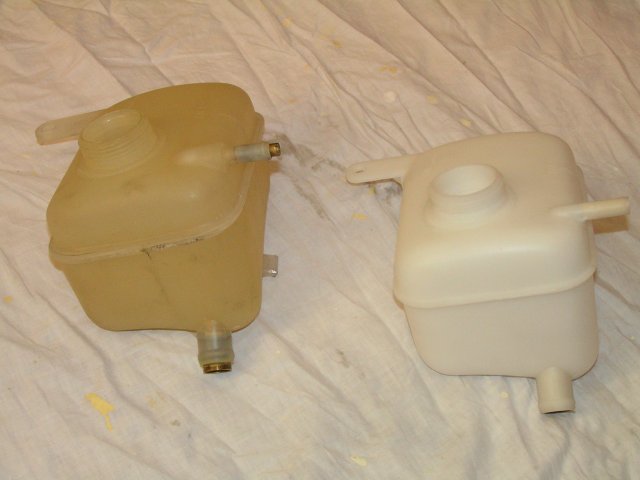

Got a new coolant bottle the other day "whats it off" asked the guy at the vauxhall dealership, I said "no point in telling you, that will just complicate things, just read the number". "Ahh so you have a nova" he said, I said " no, just give me the price first and I'll tell you what its off" :D

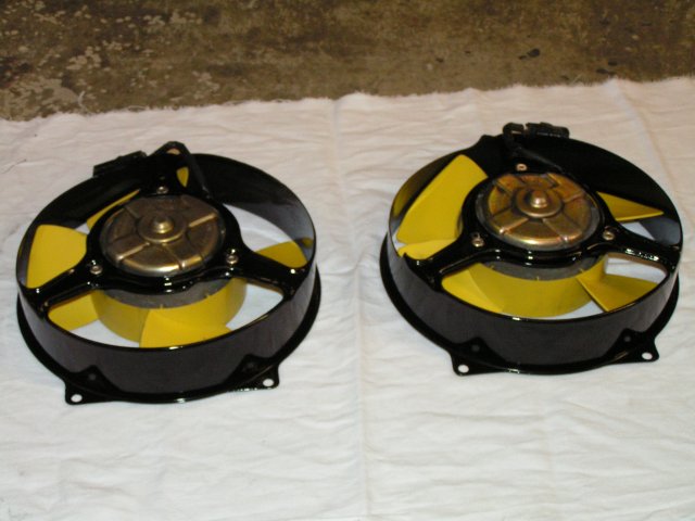

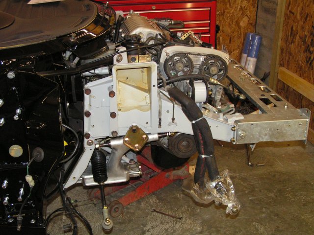

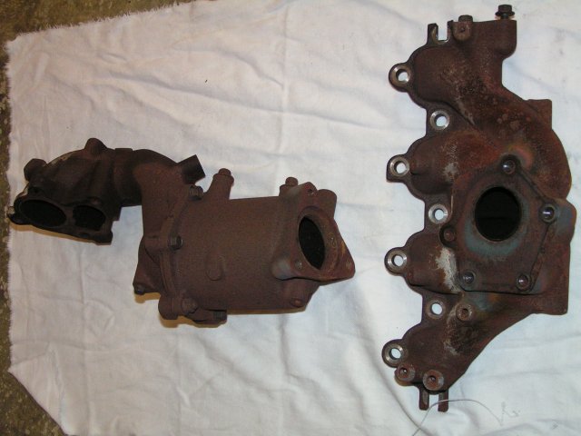

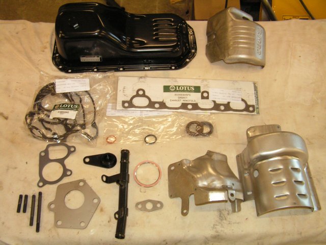

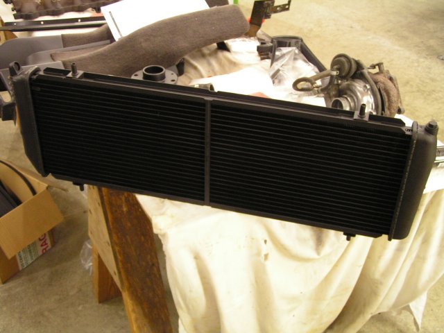

Postby jimbob » Sun 10.06.2007, 01:41

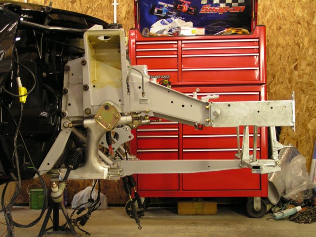

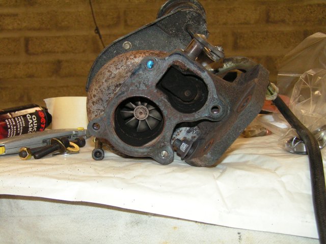

Not a lot of constructive stuff happening the last couple of weeks, although I did get my engine and box in today, slight mishap with the turbo though, you guessed it - snapped studs (all of them!). Even heating the turbo's lugs until they were yellow the studs put up a fair fight and 2 snapped flush with the casting. :shock: I had thought about drilling and tappping them out myself but will probably go to a machine shop, given a couple of the studs are long, I wouldn't fancy my chances of being 100% straight with the threads.
Same old story at the moment, still waiting for parts.
In case you were wondering, the sump was bashed underneath, new one fitted now.
Some pics enclosed.
More shine!
SJ Special, half price and identical to oe
Rad recored
Finished assembled items
A little bling
Engine in
oops

Postby lotuska » Sun 10.06.2007, 12:38
In my experience and reading everyone elses attempt at removing the turbo it seems splitting the nuts rather than trying to undo is the best option (Even if the nuts look in perfect order).
As I said previously I think the nuts are of a type that prevents removal, and could be why the cost so much.
Not that any of this helps now...

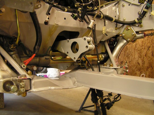

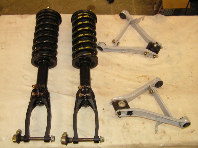

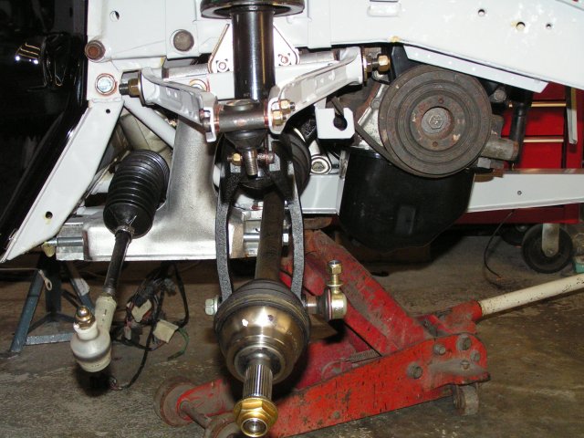

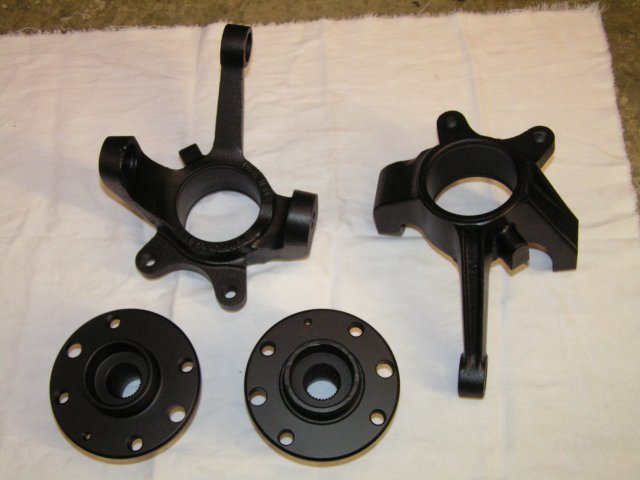

Postby jimbob » Sun 10.06.2007, 19:46

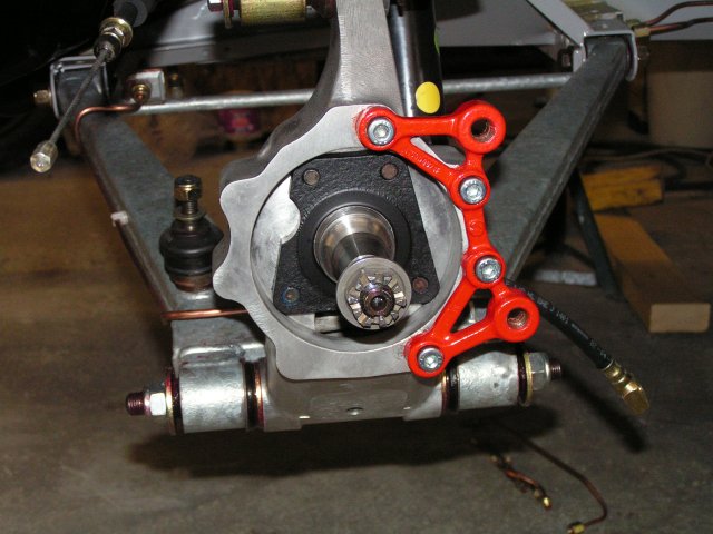

Some more pics taken today........
Studs removed awaiting replacements, manifold and pre-cat housing to be blasted and coated

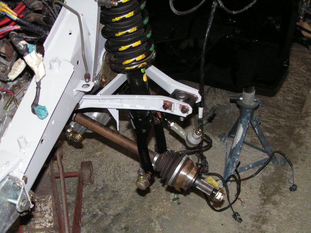

New drive shaft assy's, top wishbones, top ball joints, struts and arb links fitted. The yokes were blasted and painted.
Same as O/S
Hubs and hub carriers blasted and painted.
Fan cowls re-painted

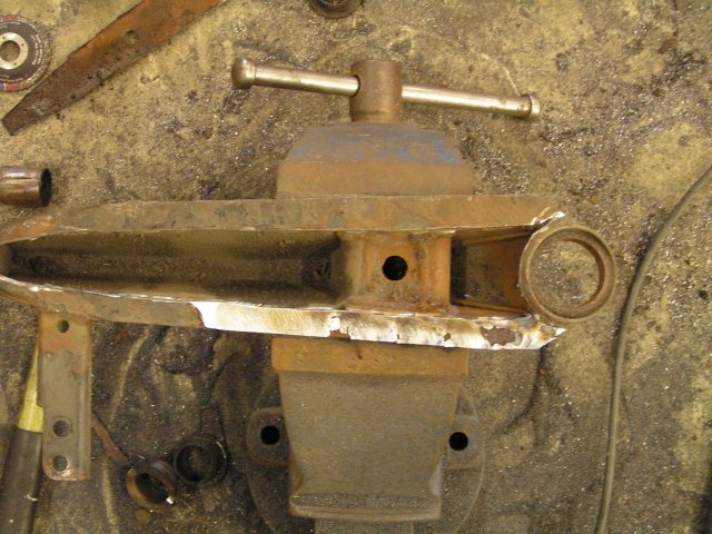

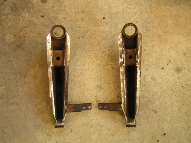

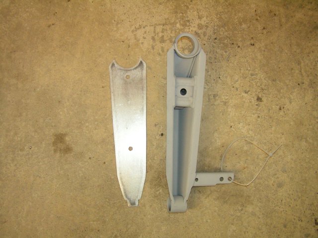

Postby jimbob » Sun 10.06.2007, 20:44

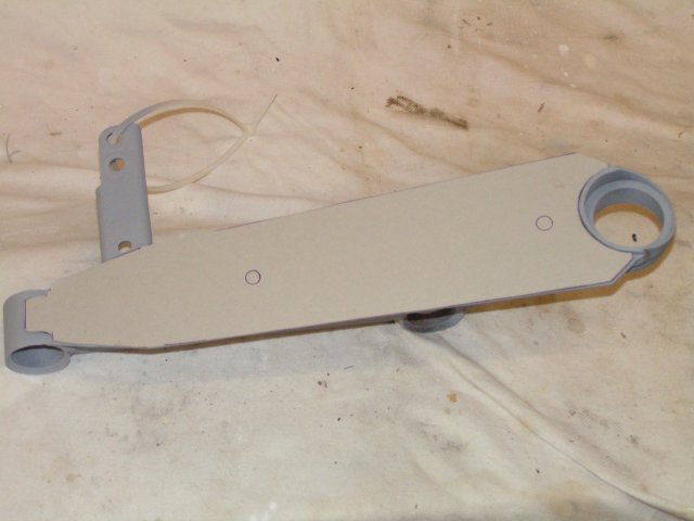

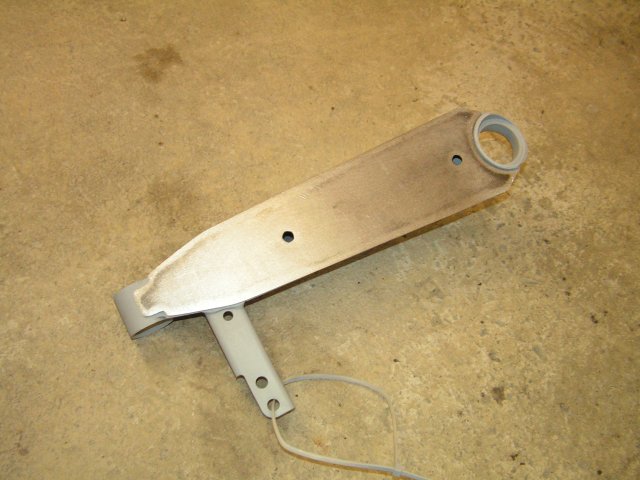

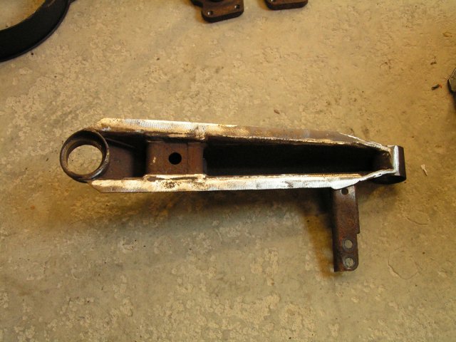

Given there may be some issues with front tca availability and the fact they are grossly overpriced Ive decided to retain the originals and give them a good clean up.
What Ive done to the tca's I would not reccomend for anyone who does no have access to a suitable pulse spot welder. This is a very expensive bit of kit and I would not even have considered doing this if it wasn't for the fact I had access to this equipment, bear in mind this is fairly thick steel plate and it takes quite a machine to produce a good quality weld in this material. Sorry for all that - just covering my rear end! :D
Cutting off closing plate, note rust between seams!
All of the closing plate removed.

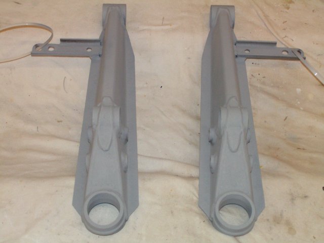

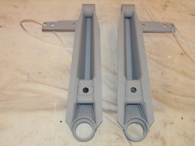

Ready to get blasted.
Blasted and a light film of temporary primer.
Underside view.

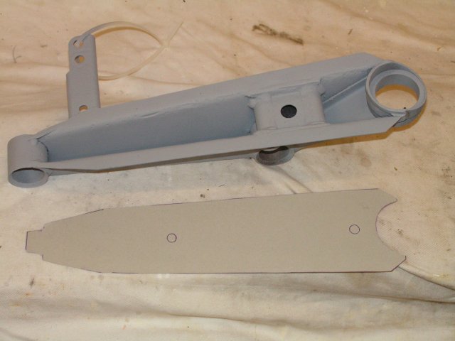

Cut Template.
Check fit on part.
Cut steel plate using template outline.(reverse for opposite side)

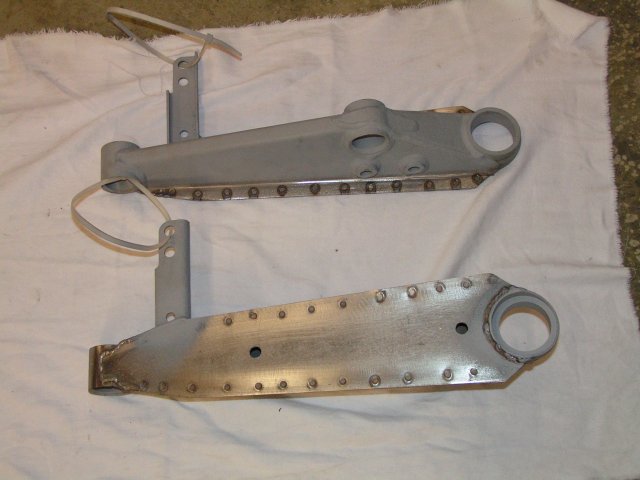

Ready to weld.
Spot welded at flanges, Mig welded at ends, Ready for primer prep.

Postby Doug » Mon 11.06.2007, 01:55
:smt023 :clap: :clap: Nice work on those TCAs :clap: :clap:
Postby Mike Y » Mon 11.06.2007, 10:32
Bloody hell Jamie thats superb work.
Regards Mike :shock:
Mike Y
Posts: 754
Joined: Fri 16.05.2003, 17:32
Postby dapinky » Mon 11.06.2007, 17:42
Good effort!
I'm going to have a look at my TCAs to see if this is a viable 'repair' for mine now that SWL are unable to supply some stuff.
Out of interest, what guage of steel did you use for the closing plates?
I'm happy with my ability to weld structurally (if not pretty!) so i hope that the main structure of the TCA will cope with it!
Are they originally spot welded, plug welded or seam welded on???
Posts: 10621
Postby jimbob » Mon 11.06.2007, 18:00
dapinky wrote:Good effort!
This might sound daft, but I didn't actually check what gauge the steel plate was, I just went to the local fabricators I matched up with some plate the same thickness as what came off. With regards to the welding, spot welded up the sides and seam welded at the ends, will be aparent once you remove your tca's and give them a clean up! The tca's are pretty ridgid without the closing plates so no worries there, when you put them in a vice to cut the bottom out of them grip them by the sleeves where the triangulation arm bolts go through. ;-)
Another point, might be worth fitting bushes and balljoint after priming but before painting as paintwork will be damaged pressing these in. Also my plan is to pour red oxide primer into one of the holes and fill up the tca, give it a shake and let it drain out (before fitting bushes and b.j.).
