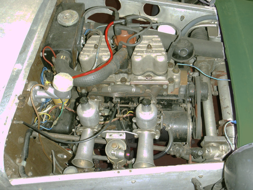

I'm following this topic with interest... One of my first cars was a Lotus 6 that came with standard Ford 1172cc engine but I improved that with an Aquaplane head (standard gasket) and then, in a moment of madness, bought a secondhand Willment Overhead Inlet Valve Head with twin SU's - shown in photo

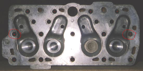

Combustion chamber was a weird shape with a huge inlet valve directly over the piston, rocker operated, and using original side exhaust valve - it had virtually no torque till 4,500 rpm and then flew when the gases flowed but con rods were supposed to break at 6,500 so a ridiculously narrow power band. Such 'a rare animal' that I had to make my own gaskets out of soft copper sheets.

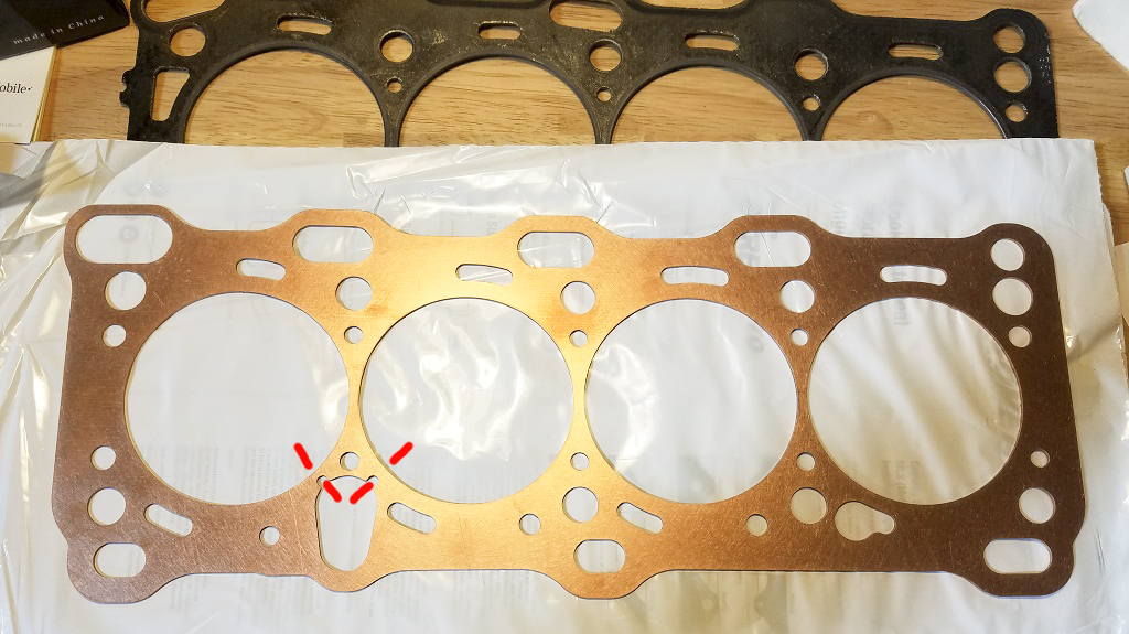

The problem with the OHIV casting was the centre front and rear bolts holes (ringed in red) were very close to the combustion chamber edge so the gasket was really narrower in this area and used to burn away in a few thousand miles. When this happened the bolt hole would become part of the combustion chamber and I'd get a hissing out of the washers under the bolt heads causing a very strange noise and loss of performance.

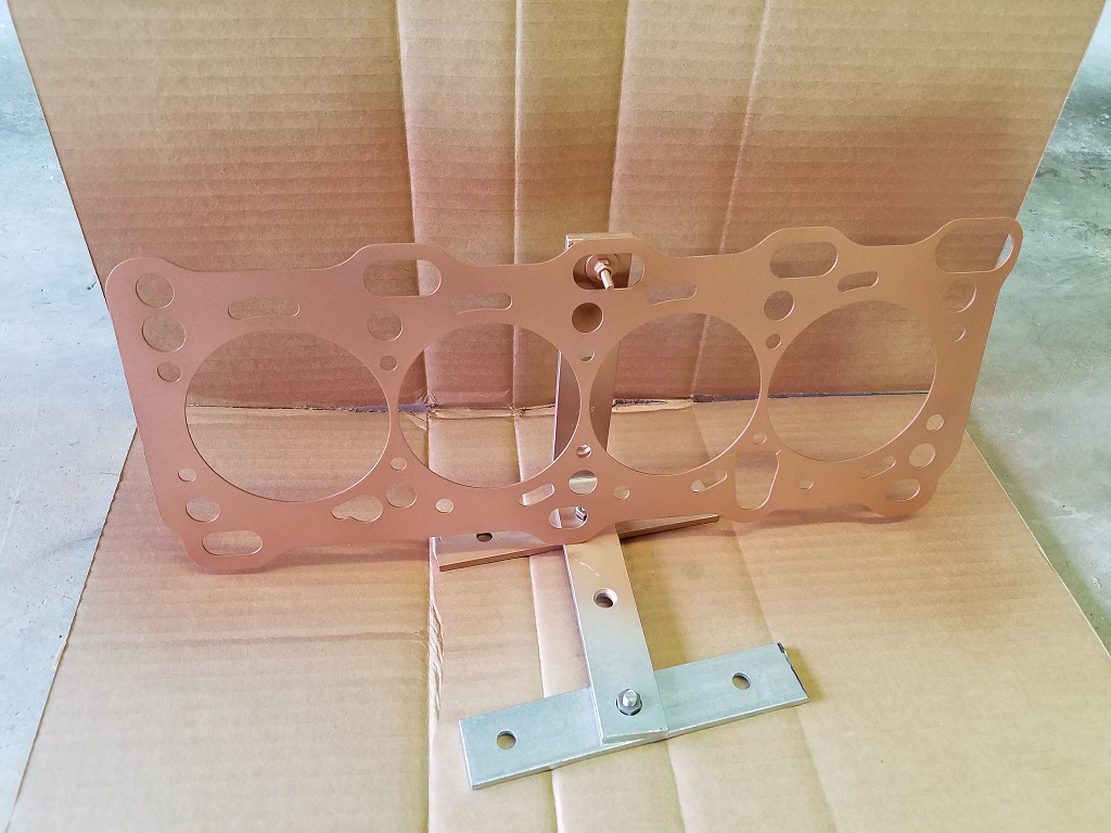

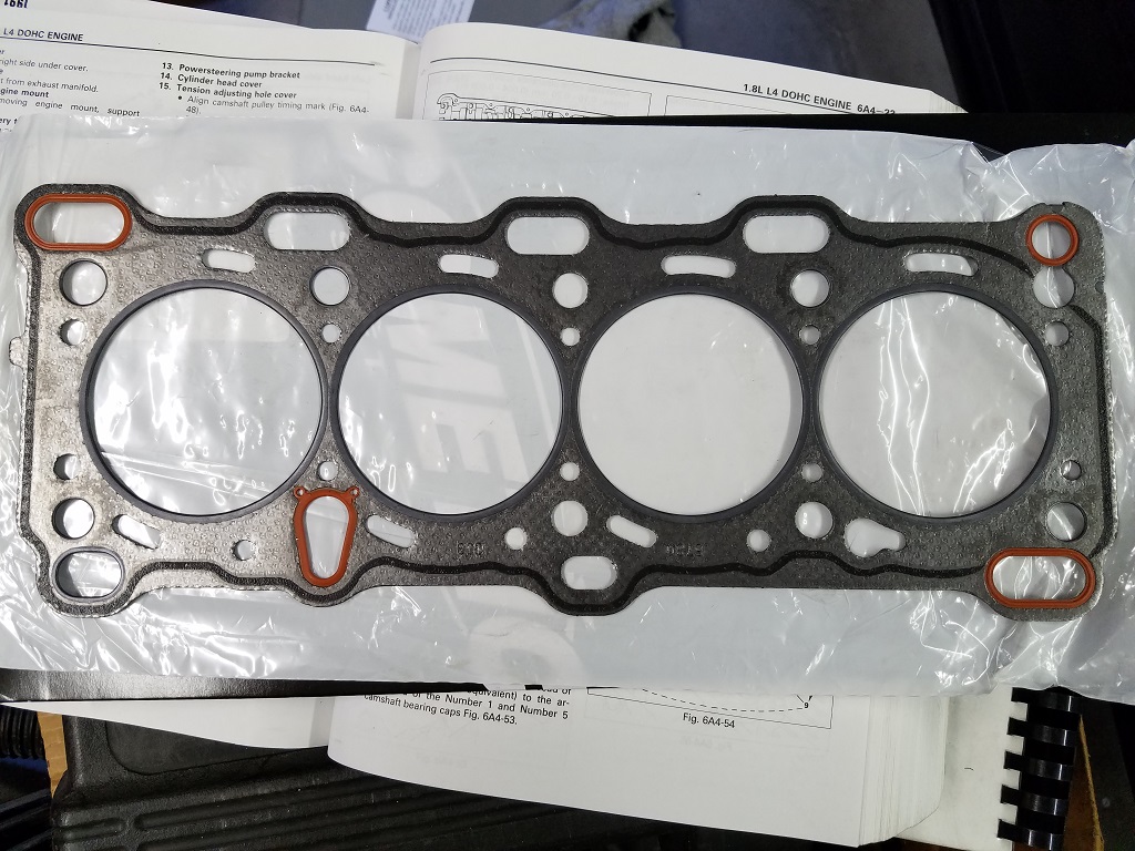

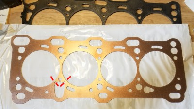

Now, looking at the photo of the copper gasket for the Elan I see a very narrow section that might cause similar problems - shown it with red lines, and the more the bore increases the more likely it is to become a problem ...

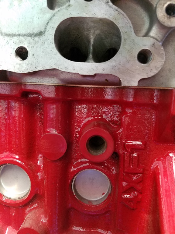

I do notice that the marks on the block in Chris's photo shows the OE gasket has the same cutout but cannot see the reason for this and wondering why this has been copied onto the copper gasket. I've never had to remove the head from any of my Elans so am curious to know what the purpose of this big cutout is... do you have any photos of the underside of the head? Looking at just the block it appears a bolt hole and two small holes is all that's required in this locality and thus would leave a lot more gasket in this area. Just a thought ...

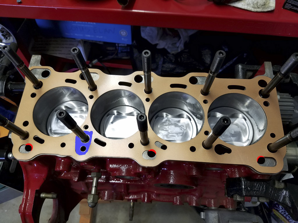

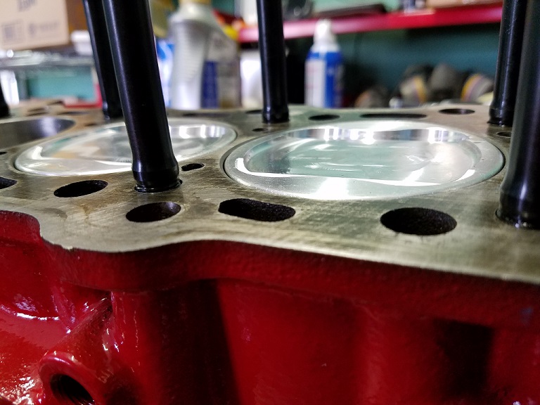

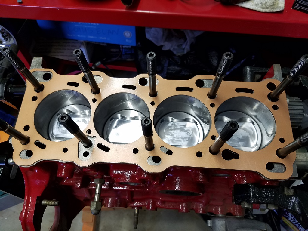

Glad it was helpful. I installed the head gasket this weekend and based on turning the torque wrench compared to previous head gasket installations, it definitely feels like it compresses a lot less than the original. I didn't notice when getting to the first 29 ft lb step, but stepping from 29 to 58 only took a little less than an eighth of a turn! I'm used to closer to a quarter turn for that step.
Because of the ARP head studs, I torqued it a third step to 80 ft lb to finish it off. Supposedly you can go as high as 110 ft lb, but I'm not sure I believe the source for that and I'm aware of others who have torqued ARPs to about 70 to 80. And not to mention my torque wrench only goes to 75, I went an additional adjustment on it to get to 80, haha! We'll see how she holds! Pics below.
FYI, my block is definitely not decked, but it felt way smooth, I cleaned it really well with a razor blade and I'll bet it doesn't really warp also. We'll just have to find out how it turns out!
Phil,
That's a really good observation that I never even thought of on that distance to the cylinder bore until you pointed it out. If I do this again that'll definitely be something I'm going to have to think of. Luckily, one of the holes in that opening is a head stud, so it's getting compressed pretty well directly at the location. The jacket itself looks like it's for oil, I can't tell if it's a drain though from the head down back to the oil pan or if it's under pressure. Reason I'm having trouble is cause the underside of the block shows only one through hole going up through the head, but there are clearly two holes on the underside in the block, and the through hole is for the head stud, so no idea what to really think about it. Look at the pics below, maybe it'll help describe it. The little "ears" in the opening literally look useless. On the stock gasket there's a rubber ring in there. I put a red arrow showing where they would be on the underside of the head, hope that helps too.
Chris

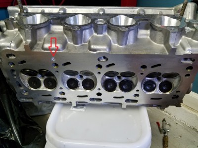

photos very interesting. I see holes in gasket are a better match to holes in head than holes in block. Still can't see any reason for that big hole with 'ears' that gets so close to the bores. Think maybe next time leave the area shown in blue.
In the early '70's I went to a very interesting lecture by Harry Weslake (check wikipedia for his CV) who said " inlet manifold and inlet port should match exactly, as should exhaust manifold and exhaust port, but there's no point to it if the gasket isn't an exact match." Then he added "water and oil don't like obstructions that cause turbulence so other gaskets should be matched too". Maybe next time remove the area shown in red?

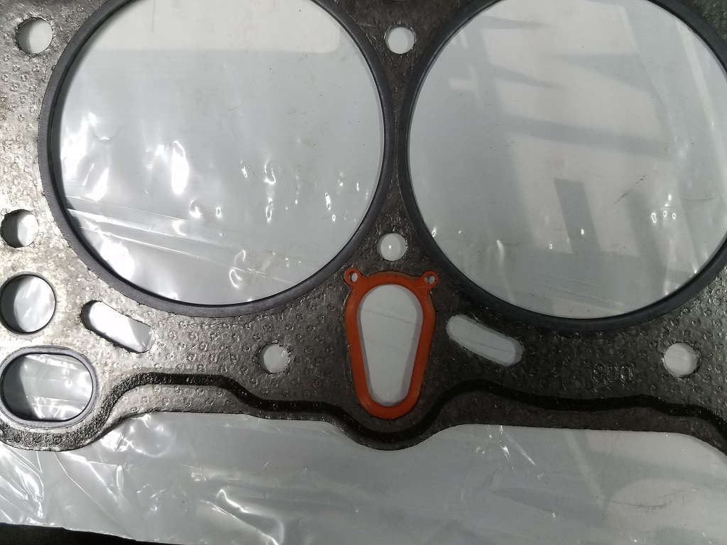

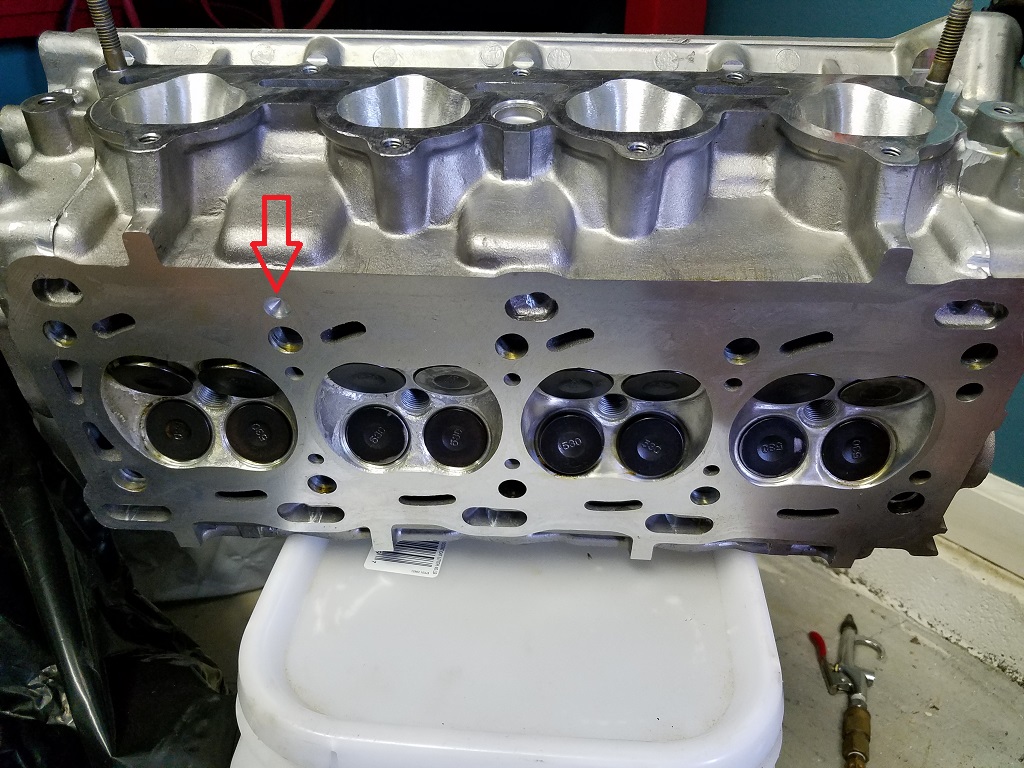

I now see the purpose of the 'ears' in the OE gasket is to locate the inserted seal around what I presume to be an oilway. Therefore I think a solid copper gasket should have a cutout the shape of the inside of the inserted seal, not the outside with locating lugs taking it so close to the bores. Bit late for Chris but something to incorporate in the next one?

I didn't get a picture of it, but the ports on the head did at least match more closely to the head gasket, so I'm not going to worry about it. When I was still a Storm enthusiast, I'd done probably close to 10 head gaskets on different Isuzus and never worried about it then.

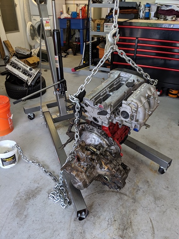

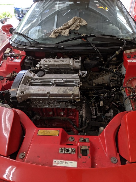

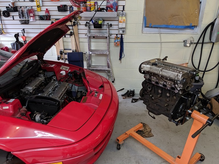

Well, it took a lot of years of this being on the backburner before getting to this point, and I can't believe myself that I've reached this milestone, however yesterday, I FINALLY had the time and was able to install the 4XF1 into the car!
NOTE: It's only installed, it is NOT running, however my previous experience with building up other Isuzu cars has been that once the engine is in and mounted, it becomes much easier and more clear where everything else needs to go to get the rest of the project to work.
I am happy to say that the hood closed on it just fine, I know some have mentioned that the engine may not fit given it's taller block, but as I found going into this, as long as you were using the 4XF1 intake plenum and valve cover, the difference in total height was more around half an inch than a full inch because the value cover is shallower and the intake plenum is formed to keep the throttle body at the same approximate location in the engine well as the 1.6L engines (this allows for more crossover of components between the two engines while it was offered in the same vehicle).
See the pictures below, I'll keep people in the loop as I get other items worked out!

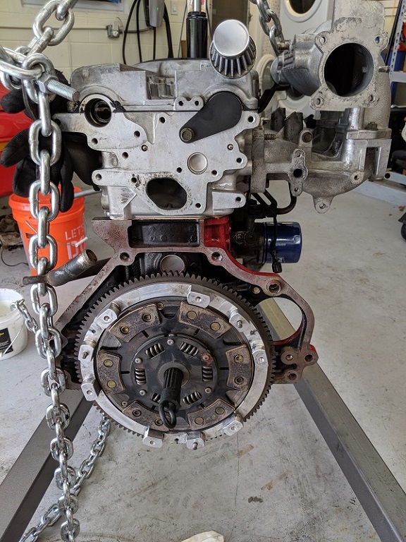

Fidanza lightweight flywheel and the clutch plate (Clutch Specialties Stage 3 I think, might have been stage 4, don't remember) Clear view of the extra inch of block height between the top of the transmission mating surface and the bottom of the head.
Lightweight flywheel and performance clutch
Transmission bolted up and both ready to go in the car.

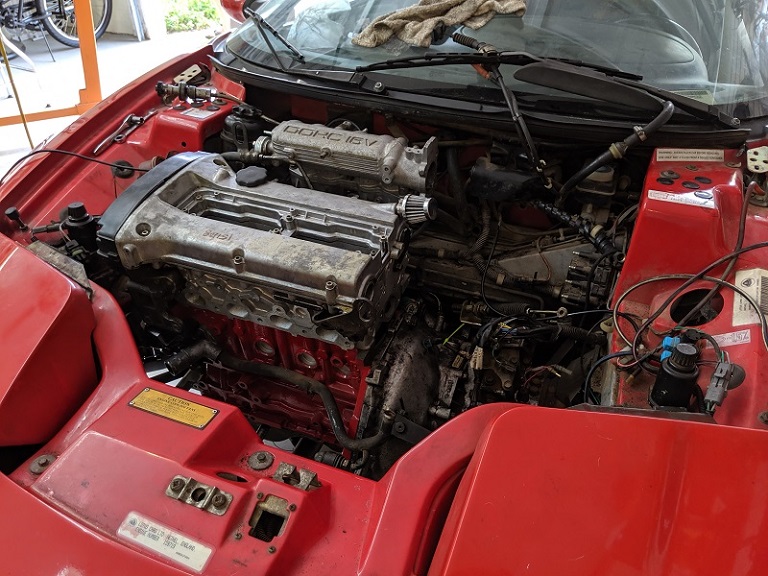

Ready to go in
Engine in the car
Engine in well 1
Another engine in the car
Engine in well 2
In case you don't believe me, "4XF1" plain as day!
4XF1
New and old.
New engine in car and old engine on stand
Hope this is entertaining to someone!

So a billion years later, the update now is that the major pieces have been put back in, however there are some areas where it's still awaiting a bit of custom solutions.
Things still needed to do:
Decide if I want to keep Power Steering (I already chucked the AC), it looks like it'll fit if I'm willing to trim off some of the fiberglass near the passenger headlight (hidden from view at least.
Hook up the exhaust, shouldn't be hard.
Figure out the turbo intake ducting, I upsized to an '87 t-bird turbo and just got it all together, not anticipating problems, just time cause it will take a bit of custom work.
Figure out oil in and out of the turbo, I think this will just take some thinking, threads on the t-bird turbo are different than the original, so finding the right banjo bolt basically for the oil intake. For the output, getting a high temp hose routed to the oil pan (which already has an inlet welded onto it).
Fuel computer and injectors, right now it has '87 t-bird injectors but I'm pretty sure they're too small for the application, not by much but enough, if I keep this car (which I'll get to in a bit) I'll probably do a Greddy E-Manage Blue and some DSM 450's since I've successfully used that exact setup for fuel management on a similarly mechanically equipped Geo Storm.
Throttle cable and dip stick will need some thinking.
Get the radiator in there, I bought a performance one for it, should not be a problem.
After those things, then it should be ready to start and we'll see how it drives!

So literally after my last post I just started assembling the bottom framing to get the wheels on and since I'm talking about selling this car, I gotta now be super transparent - I literally just found out that the 1.8L engine is NOT going to fit...
It's not because of anything on the top side of the engine, that all is fitting just fine, it's the damn oil pan. It's shaped differently from the original engine and as a result, it interferes with the bottom frame. I can't bolt up the bottom framing because of the shape of the oil pan. I also know that these oil pans are NOT interchangeable between the 1.8 and 1.6, they are different because of how the oil pump pulls from the pan.
Did NOT see that coming, and I also have just about no interest or time to pull the engine all over again and swap out for the original. Going to sleep on what I'm going to do, at the moment I'm just about ready to give this car away if anyone wants it.
And for everybody's future knowledge, the 1.8 does NOT fit in this car! DO NOT ATTEMPT!!!
